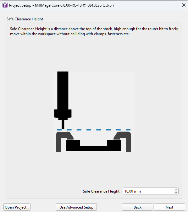

I think you set it at the beginning of the project, MM asks for some settings:
I don’t know where to access those settings after the project has been edited. I never needed it before :slight_smile: Edit: Check the File menu. There is an edit function for the project setup.
The settings you mention are in the Project Setup: Beginners Setup. All mine are set to 5mm.
Then maybe you set the first steps in that configuration incorrectly. It looks like you set the thickness to 20mm but the zero position at the bottom. Try to set the zero position at the top of the material. Edit: looking at the comments in the gcode, it doesn’t look like that. It seems everything is set like I’d also do it :slight_smile:
This is incorrect. Set it to bottom left. Then the head will only move 5mm up. Just tested with my setup.

I stumbled upon the solution to the Z-axis move at the start of the Gcode file; the line reads G0 Z20 in my files.
The solution to change the above line is to select CNC Tools; Device Settings. The window that opens has 3 tabs: Basic Settings; Custom Gcode; and Additional Settings. Select the Custom Gcode tab. On the left side is the first title: Job Header. This is editable code that gets used as the header for every Gcode file you create. Edit the lines as needed. When you click OK (bottom Right corner), your changes will be saved including any modifications to the Job Header. Mine now reads G0 Z5 instead of G0 Z20.
