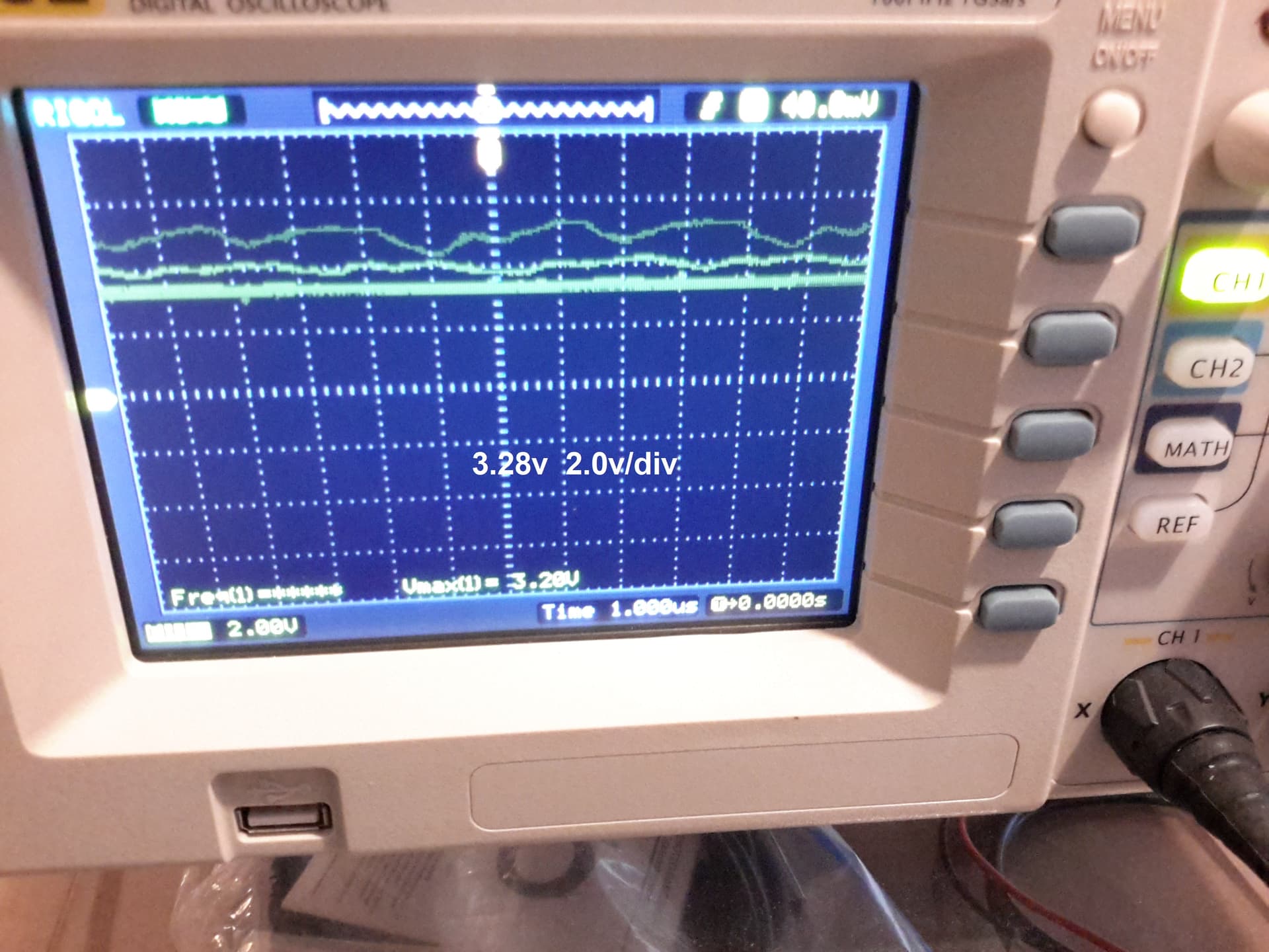

It was not triggering on the noise. There was no leading edge rise in the waveform, it was straight DC. I used the AUTO button on the scope.
Throwing out the motor PWM is a distraction.
I will be happy to dig deeper. I need to justify all the money I spent on that RIGOL scope!

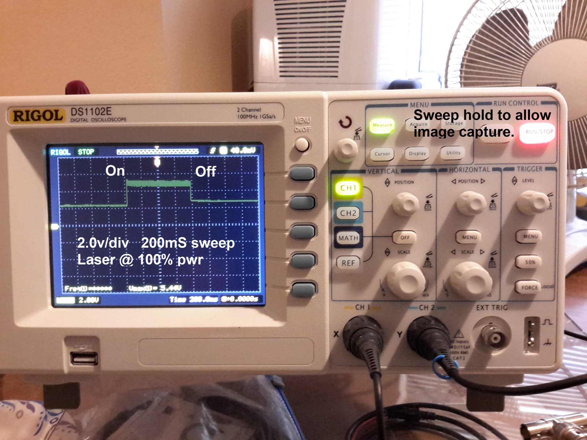

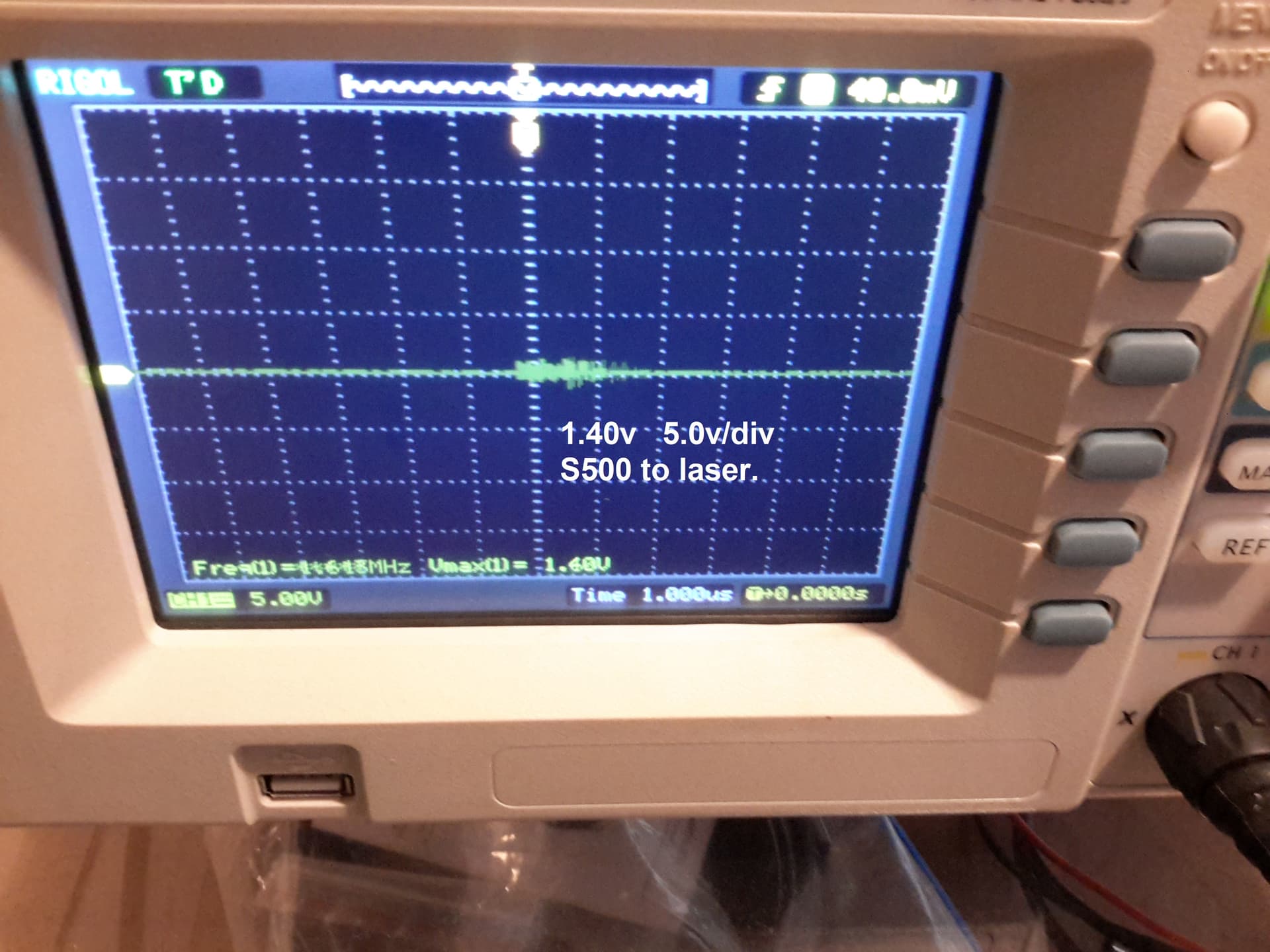

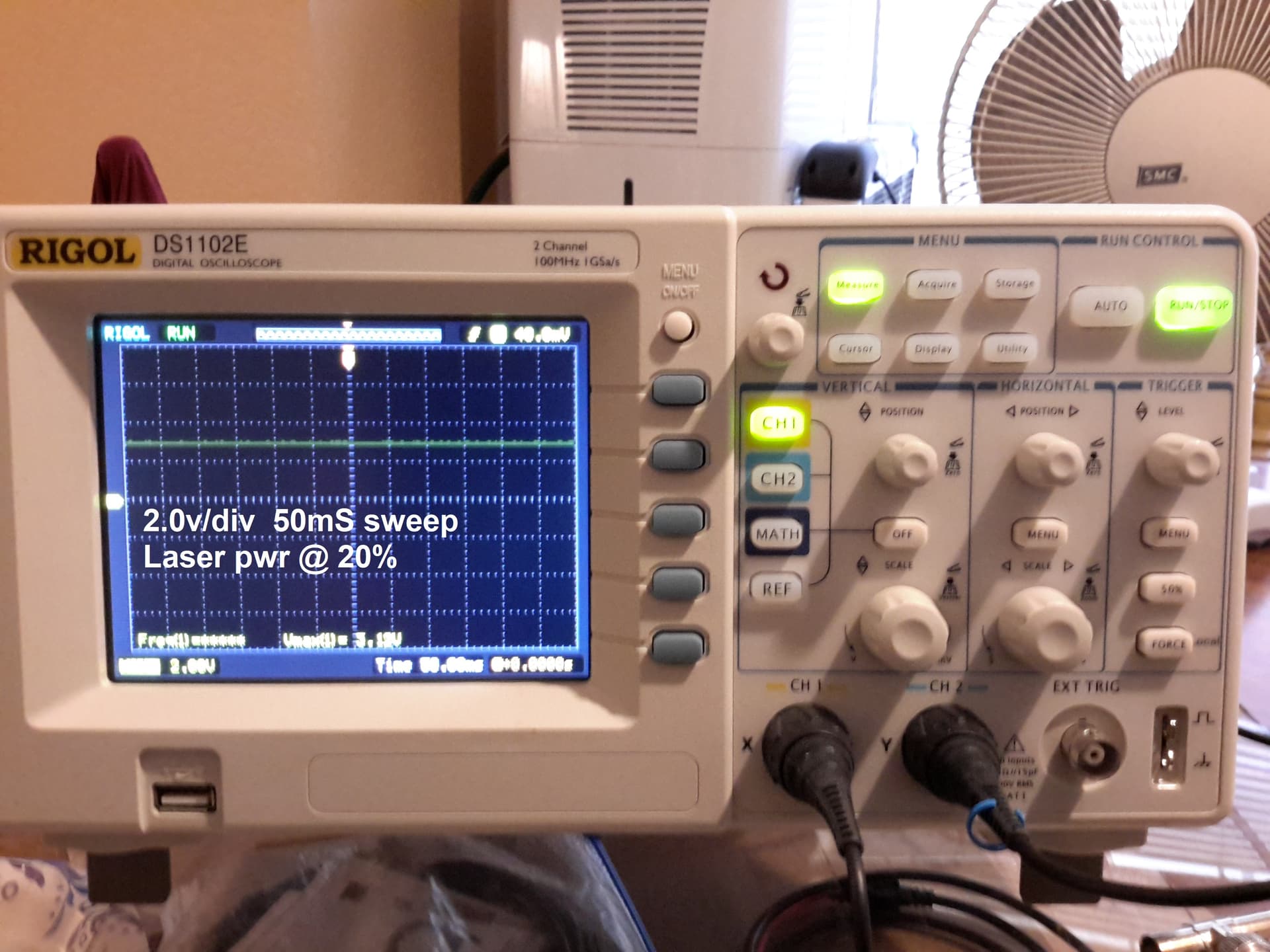

I slowed down the sweep on the presumption I might be viewing the top of a single PWM pulse. The image #-1 definitely shows there is no pulse activity during the On time. Voltage transitions would appear as a whitening under the raised waveform.
To ensure there was really nothing there, I raised the sweep speed, in image #-2, to spread out any possible pulse activity. Unfortunately, the sweep was too fast for me to push all the buttons fast enuff. Again, no waveform is seen below the voltage line.
I am just as disappointed an anyone else to learn this. Everything I thought I knew about Laser PWM Control went out the window. This is sad because I know a laser diode is capable of easily being pulsed at a 1KHz rate. PWM would be much more accurate for controlling laser power than a wandering DC voltage.
I am going to get out my ELEGOO Super Starter UNO R3 Project kit and find out if that dimmable LED was fed pulses or DC. And Raspberry Pi, you are next!

Assuming the schematic matches the actual circuitry (*), that explains much of what the scope shows.

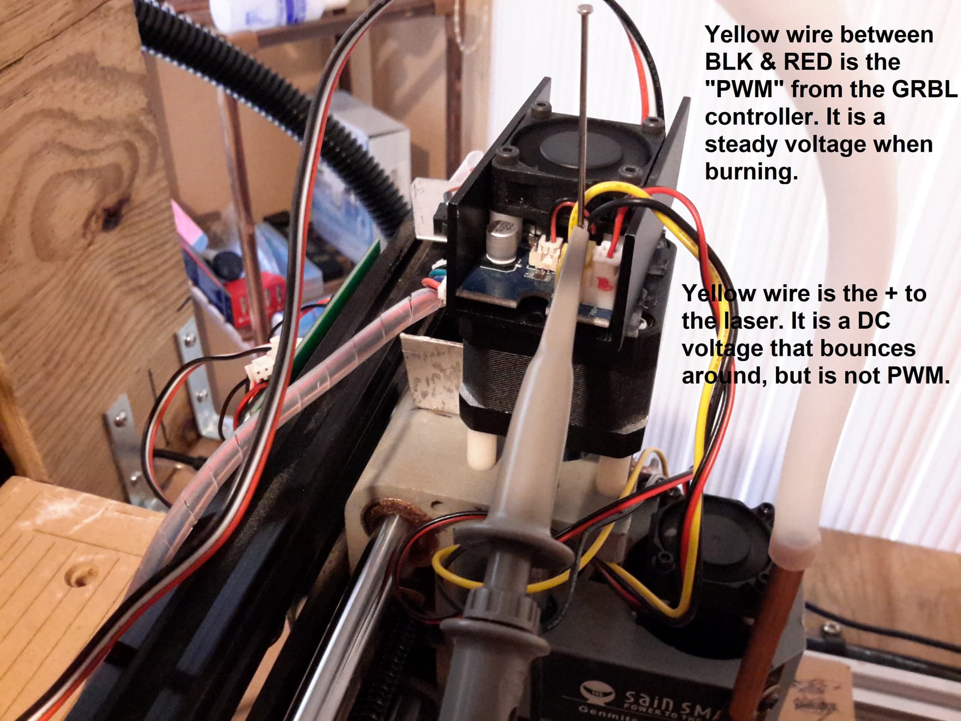

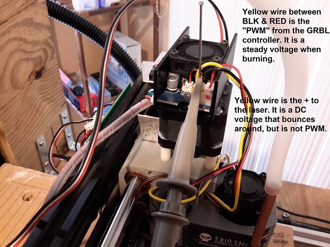

measured 8.65 volts to the yellow control “PWM” wire of the LCM. This was with no output of the laser beam commanded.
With the laser output inactive (and no 24 V spindle supply and no spindle motor), the MOSFET drain will float at some random voltage under 12 V (-ish) determined by the transistor IDSS leakage through the pullup inside the “laser”.
The assortment of stacked caps intended for the spindle will somewhat stabilize that voltage, but the signal isn’t actually doing anything. The scope’s AUTO function then desperately attempts to find something anything interesting to trigger on, so it proudly shows off those little glitches with a blistering timebase.
The scope did not show a PWM signal, but a DC voltage that varied a lot.
Dial the timebase back to 2 m/div, set the scope trigger to SINGLE with a falling edge at about 2 V, run the G01S500F50X40, and you should see a nice PWM signal. Might take some fiddling to get a meaningful trigger and maybe some zooming to see the details, but it’ll be there.
The 1.4 V DC-ish signal you’re seeing comes from the same pullup as above, but now the active PWM signal pulls it to 0 V half the time and lets it rise during the inactive half. Watching the voltage immediately after the MOSFET switches off will show the usual RC waveform with the 100 nF cap filtering whatever the pullup resistor might be.

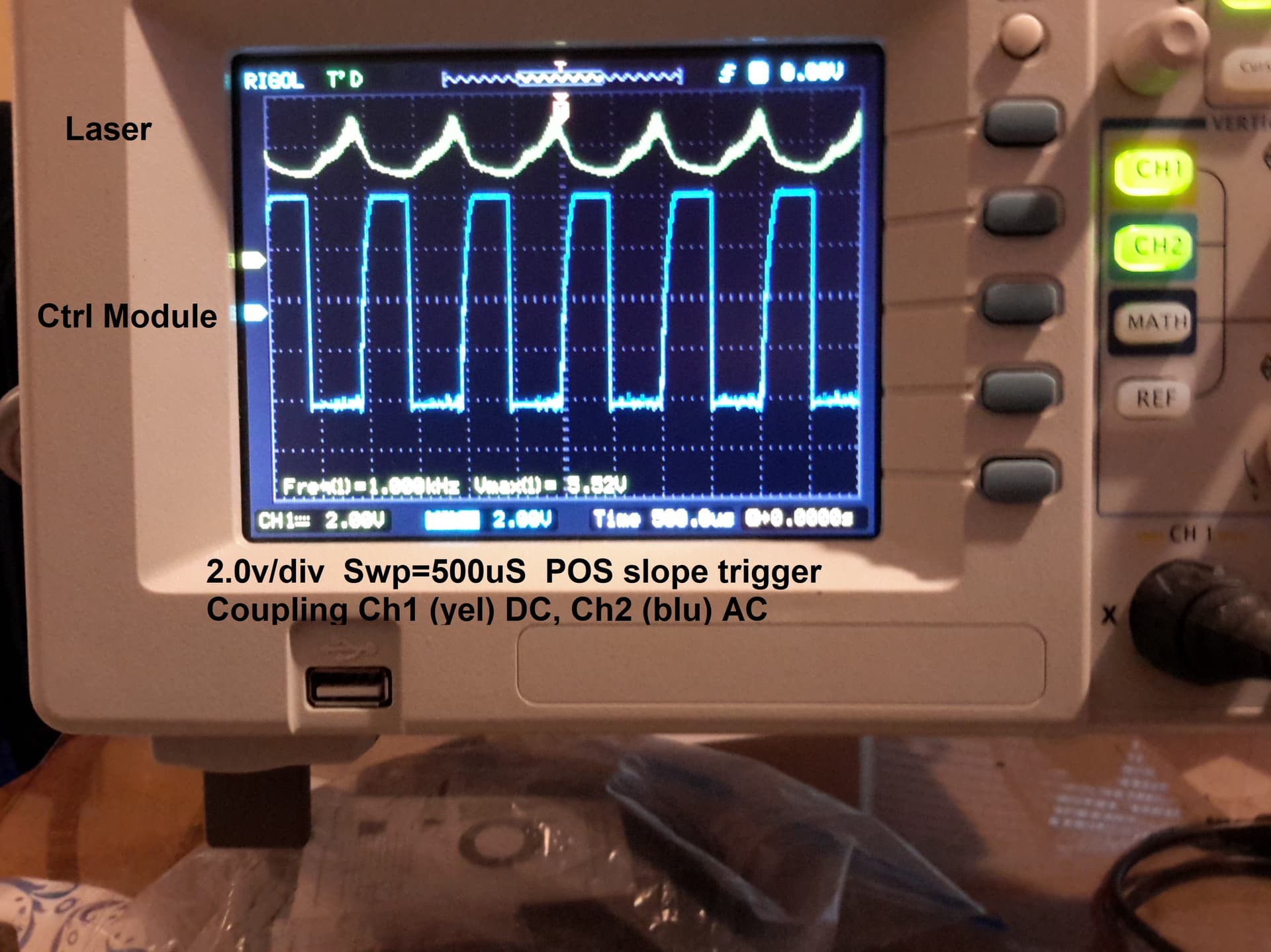

Enuff of the Q&A. Now for the latest results…

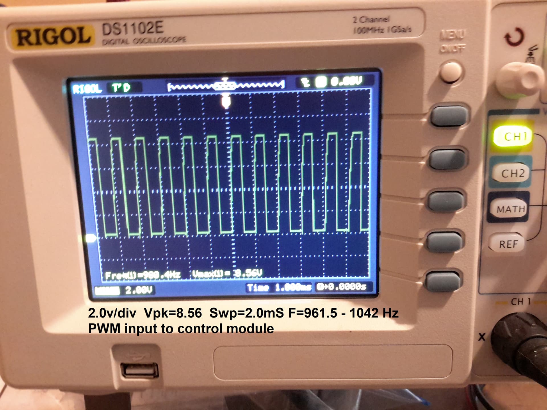

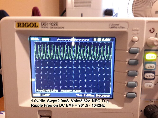

PWM to Cntrlr shows there is a PWM signal applied to the laser controller module. See image PWM to Cntrlr for parameters. The LCM is between the Woodpecker board and the Laser Module. See image Test Points.
The actual EMF to the Laser Module is more like a DC voltage with a 1000 Hz 2.3 volt Pk-Pk ripple on it.

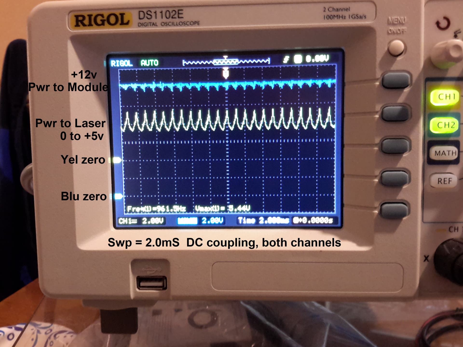

Put both 12V and PWM signals on your scope so we can see the relationship… if the 12V is dropping when the laser is supposed to fire, it might not have enough current available…

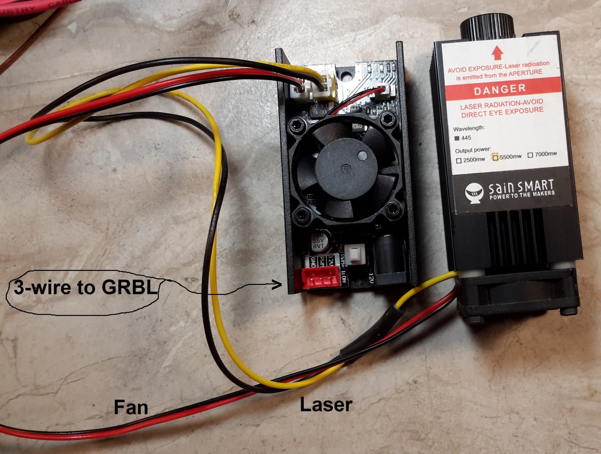

Is there an interface board between the controller and the laser?
The 12v from Woodpecker, measured at the 3-pin plug on the module, is a steady 12.36 volts.
It is stock for Sainsmart, pix attached. The new replacement is nearly identical 2 years later.
No, the 3-wire cable plugs directly into the Woodpecker 3-wire socket.
Will do, but both scope pix above use the same sweep rate and deflection scale. You should be able to compare them 1-to-1.
Just realized you were asking for the impact on the power supply. What I have here is the PWM input vs the Laser EMF out of the module.
Back shortly with the power supply regulation test…
This next image is the input 12v to the laser control module. The 12v has some ripple, but nothing drastic although it may be amplified in the output. Should have bought the 4-channel scope?
Curious, @jkwilborn , does the 32-bit GRBL boards drive the laser directly, without a control/interface module?
Let me see if I now have track of what you were talking about:
  • An Arduino-class microcontroller running GRBL produces a bone-stock 1 kHz PWM signal to control the laser power, using a MOSFET and a 12 V power supply. This did not show up until much later in the thread.
  • The laser control module converts PWM to laser diode control signal for the laser head. This may involve a separate 12 V supply (or 24 V for some diodes). The control signal between the laser control module and the laser head is not a documented thing, so expecting it to be either PWM or the demodulated analog equivalent is incorrect.
  • The first few scope displays show the signals between the laser control module and the laser head, which are not documented to behave in any particular manner and live up to that expectation.
  • The last few displays show the (expected) PWM signal and the power supply as inputs to the laser control module.
Summary: the Arduino board behaves as expected, the laser control board does whatever it does, and all is right with the world.

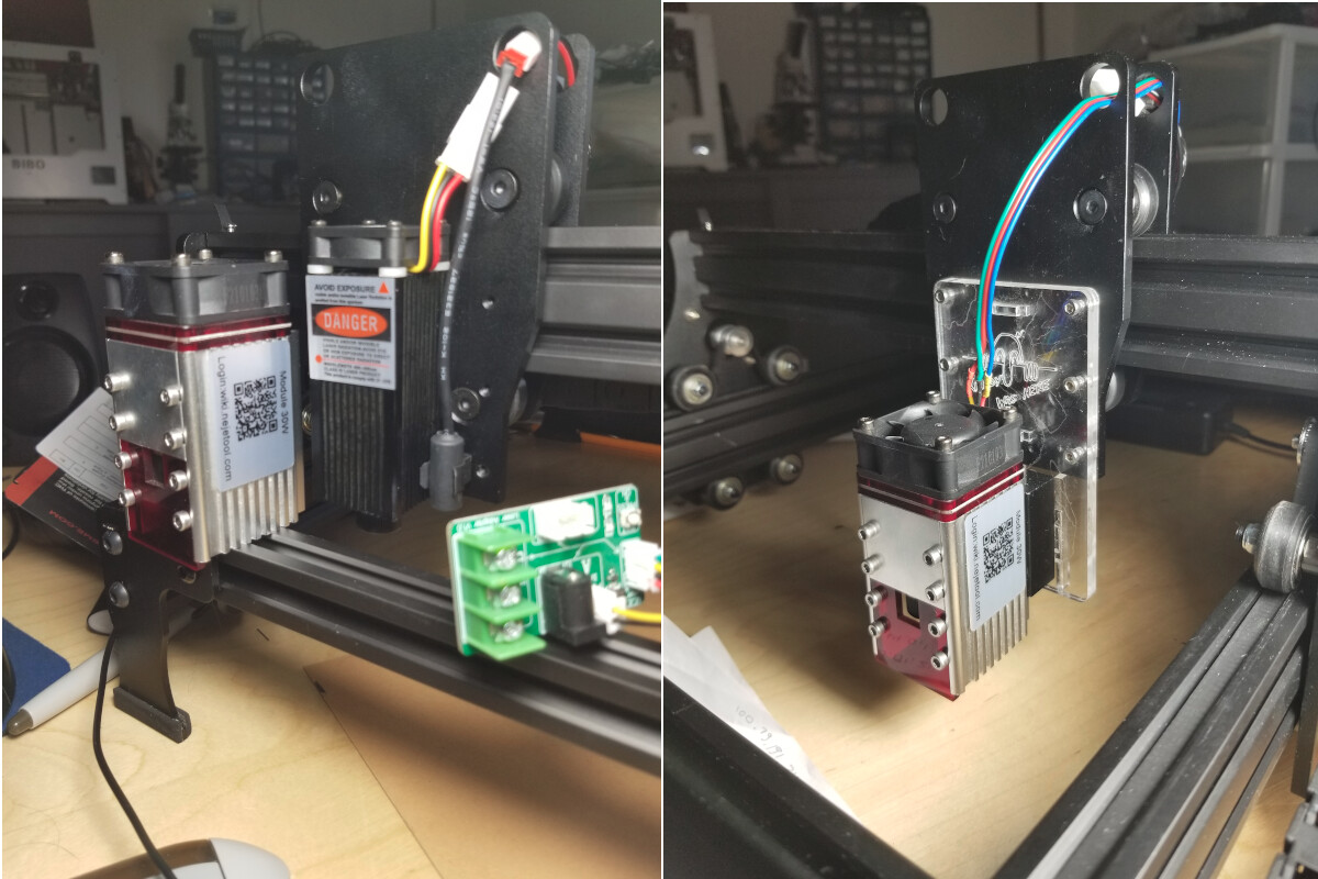

To clarify… many of these boards come with an interface board… My 32bit machine has one on it that I haven’t gotten around to changing… this was an $80 laser engraving machine from Amazon.
I purchased a NEJE 40630 laser module and it came with an adapter or interface board… the green board in the lower right of the left photo … Original is in the middle still mounted up. The right it’s mounted on it’s new home.
The problem upgrading is that a larger laser requires more power. Many times, it’s more than the controller can supply.
Interface board plugs into the control board and uses only the ground and pwm connection, both of which are passed onto the laser module. It’s either missing the 12V line or it’s broken in the module to isolate the 12V supply of the laser module from the control boards 12V supply.
So, it really doesn’t do anything… the pwm signal is passed through… Although I’ve seen one with an active optical isolator on it, only one…
Yours are split… most interface boards do not have fans, there is no active components …
