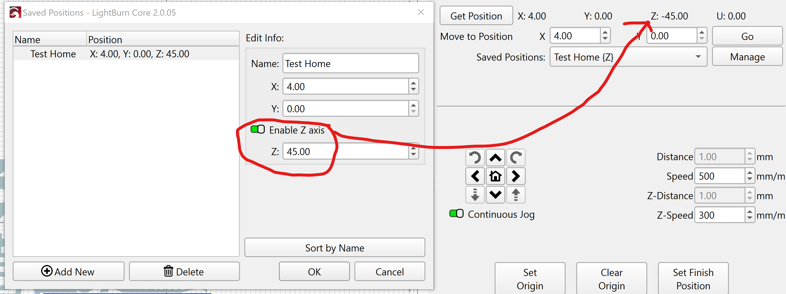

Shouldn’t LB allow negative positions to be saved? My machine is setup so Z=0 has my machine head fully upright. This allows me to change materials and honeycomb beds. Also, I confirm focal point at every job. If I were able to save negative Z-axis, it would save a lot of time.

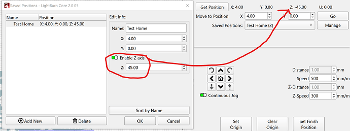

If I´m understanding your issue right…check here:
