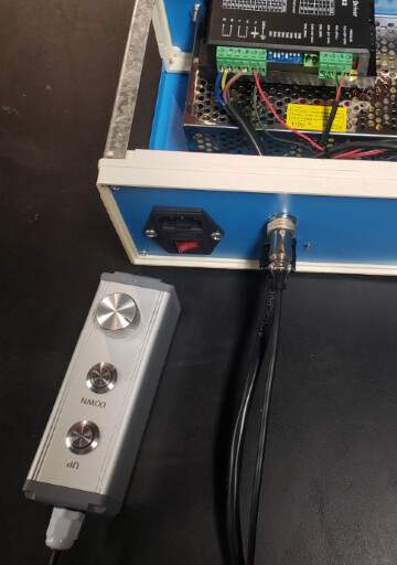

My machine setup is actually quite simple. The tower has a stepper motor that normally connects to the normal socket that controlls up and down manually. When I want to use the Z-control with Easycad/Lightburn I plug it into the rotary socket.
Besides that there is just an Easycad2 light board so nothing special there.

After reading your last post and re-reading a couple of your others, I think I am getting a handle on this. Your speed control is for when you are manually moving the head up or down, with up/ down buttons and maybe a dial to set speed. Am I close?
Then, if you want to use Z stepping, you unplug from the manual adjustment and plug into the rotary port and use “Repeat Marking” At that point your buttons and speed control are not connected. That would explain my misunderstanding when you say you “Lower the speed”
Am I getting close?
This was my original “Non CNC” controller and combined with a DRO worked pretty good until I worked out the bugs for the CNC controller.

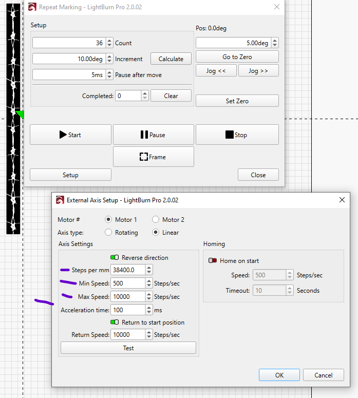

You are doing fine with English. . What is “Auto Z”? if that is when the Z is plugged into the rotary you can smooth it out with speed but not improve resolution.
I just popped this up, the numbers are way off for you, for you I would assume “Steps per mm” would be 1280 ( 6400/5 ) if your microstep driver is set to 6400 and you have a 5mm lead screw in the tower.
Min/ Max/ Acceleration speed settings you would use to smooth out the movement WHEN connected to rotary port. Higher number in “Acceleration time” is slower acceleration. I would think Min would be between 100-500, Max would be around 3000, Accel would be around 100-300 with your setup. Fine tuning, I just listen to the motor see what is smoothest.

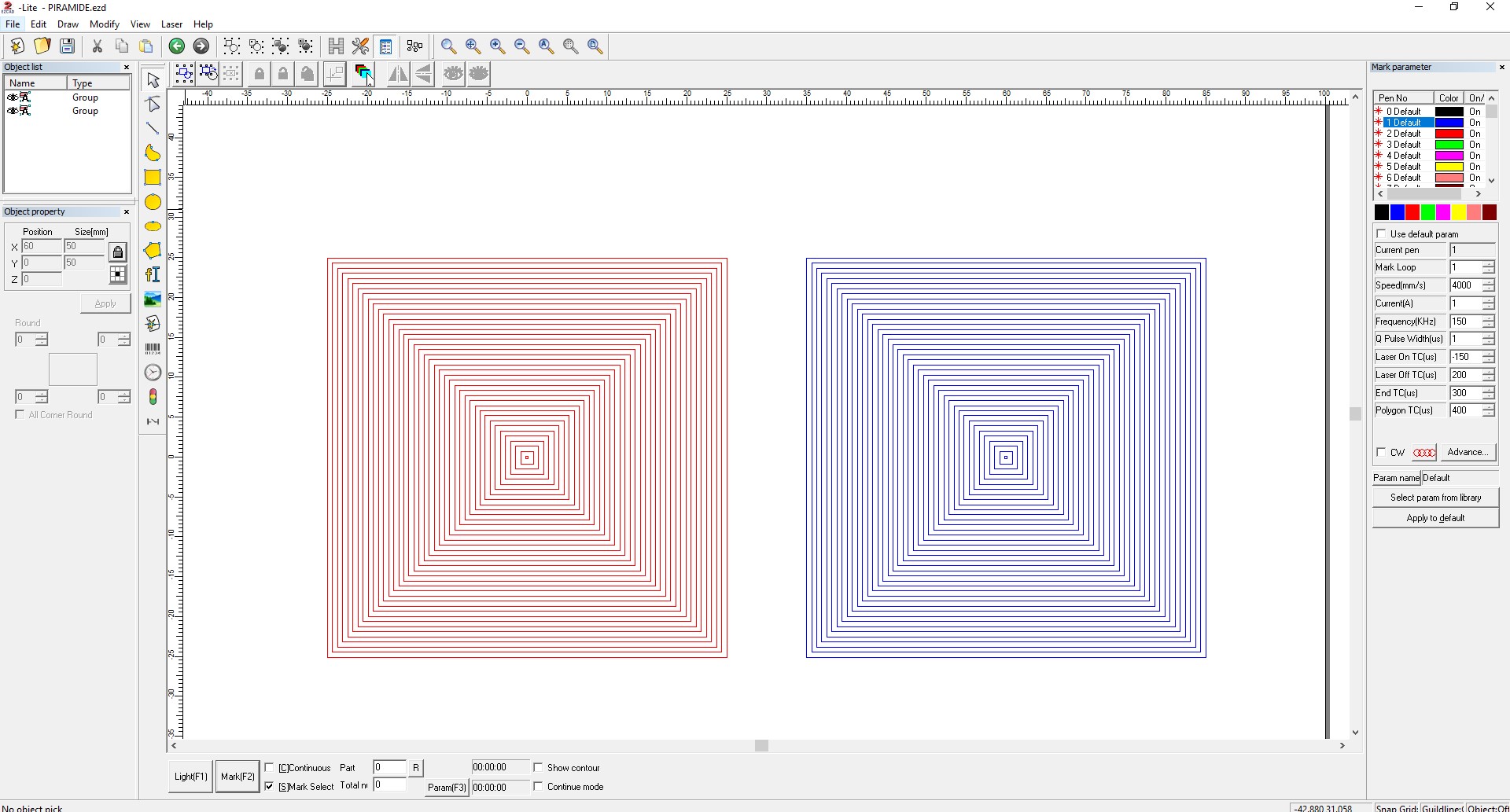

This evening I had time to make a video of it working in EzCad2. My supplier has set the parameters for the Splitmark2 settings:
For the test I created 3 text shapes showing the height they are marked at (0/30/50mm). I assigned the correct Z values for each of them:
After that I selected all of them and opened the SplitMark2 menu again and hit ‘Mark’ to start the job, et voilá:
Some notes
  • Positioning the shapes with the red light is difficult. When using the ‘Light’ function in SplitMark, the positioning is a few millimeters off compared to when using the 'Light function in the EzCad homescreen. Also; when selecting seperate shapes for the positioning preview the red light is all over the place. Maybe some EzCad bug?
  • If I select ‘Mark selected’, all shapes are marked on the same X height (all next to each other in line) so it only works without ‘Mark selected’.
  • The shapes are marked in order as seen in the ‘layers window’
So… in EzCad it is not without it’s quirks, but assigning the Z value for the seperate shapes works very well!

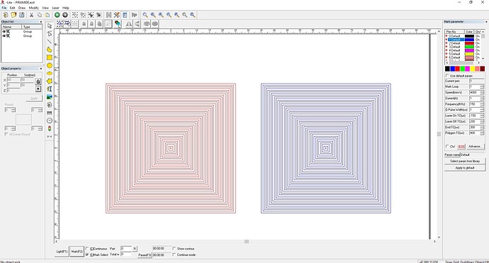

I can imagine that if there is some ‘slicing’ tool that is able to slice an STL into vector layers, then -at least in EzCad-, it would be possible to mimic 3D behaviour. Its not the most elegant method of doing it, but hey. It does work. My testshape consists of 80 layers. It did take 5 minutes or so to assign all the Z values for every seperate shape.
If LightBurn could give us control over the Z values for different shapes that would already be really cool. If they also could write a script that lets you batch import the STL slices (SVG’s, DXF’s or something) in the right order and make it possible to assign Z=0mm for the first ‘layer’ and for example Z=100mm for the last one, and have LB assign Z values to the layer in between automatically… Just dreaming..
Below a screenshot of what I did for my test. Every square has its own Z value (red is the bottom half of the shape, blue is the top half). When running the test the red and blue shapes were on top of eachother.
