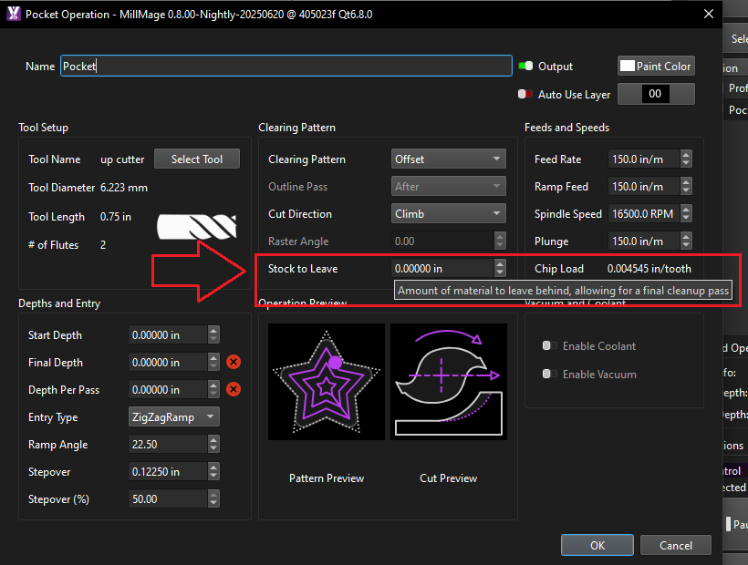

Hi, will there be an option to have stock to leave on Z, eg depth of cut, so you can do a finish run to the bottom of a pocket.

How would that be different than making the pocket shallower and adding a second pocket operation?
Yes, there is now, but If you only want to leave a small amount at the bottom of the pocket then you would create a second pocket operation, start depth from the last pocket and set a new finish depth. I believe the pocket op will leave material for wall cleanup as well. Unless I am mistaken @Colin @JoeSpanier
