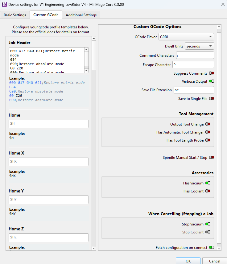

I have a V1E Lowrider V4 running fluidnc on a jackpot controller.
I do not have anything in the “Job Header” box of the Custom GCode section.

I also went back to a RC and found I did have information in the Job Header block, I copied that into the current version to see if that had any effect. I learned it did not, I did however leave the code in the block as you will see.

@Bobinator, which MillMage build are you using? It should be the latest release version (Core 0.8.00, not any release candidate)
I’ve tried a bunch of things, but so far couldn’t reproduce what you reported.
As far as I remember, I never saw any Z moves when framing.
The code you have in the “Job Header” does some Z-Moves, but it doesn’t appear to be sent when framing (which is what I would expect.)

That will be [your] specified tool change position. The 0,0 location works for me because it moves the table back out of the way.
I reported the returning to XY home each time I frame because it doesn’t do this with RC 14. It moves to a corner does the frame and stops at that corner. I doesn’t return to XY home or raise the Z to the maximum height like it is doing with the Core 0.8.00 official release.

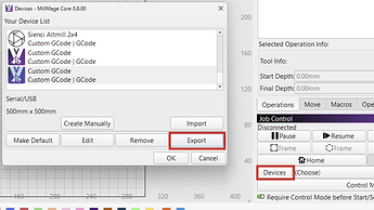

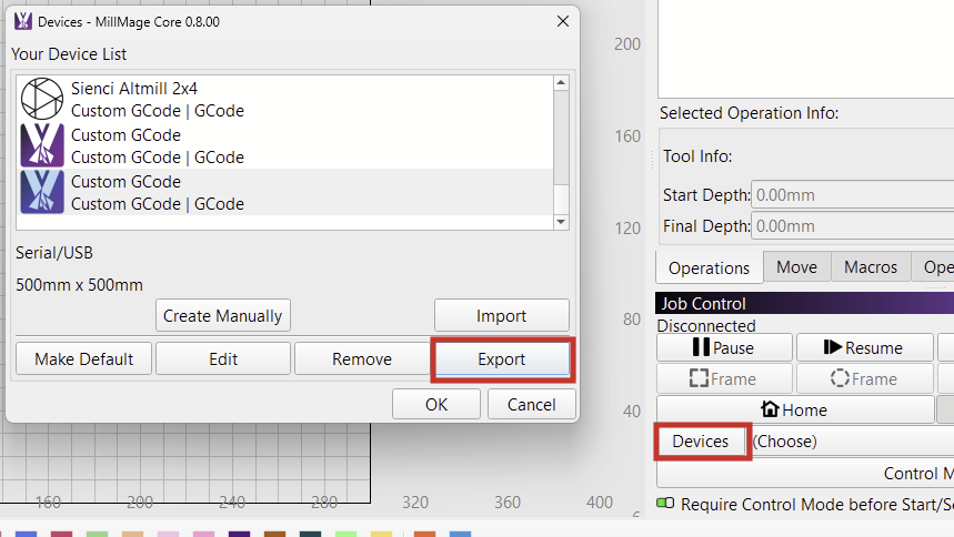

i run the low rider 4 on fluid nc can u screen shot your custom g codes and ill see if they match what i have
Here is the code at the start.
