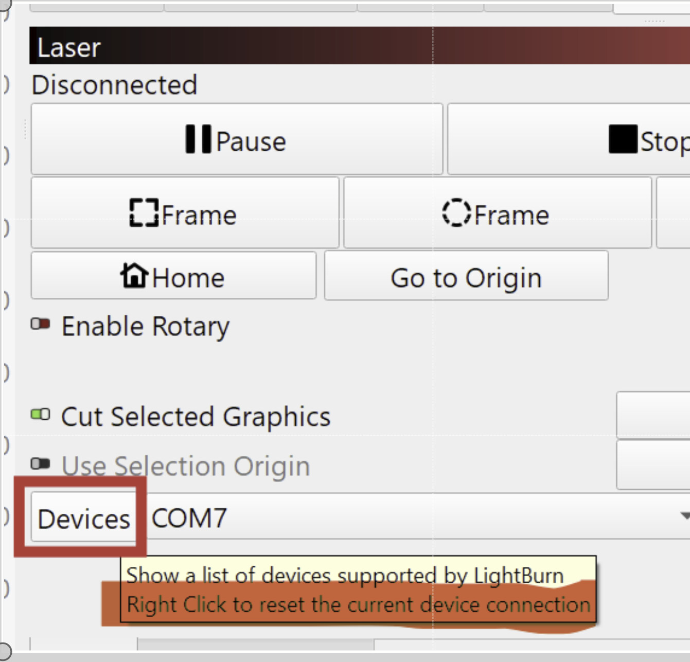

Could somone help me with my Zbaitu Laser M81 FF80 Air? I was trying to prime the lens, and now it’s stuck and displays a message that it’s in use or paused. I can’t reset it.
I don’t know what to do anymore. I’ve already disconnected and reconnected the power several times, and it’s still stuck.
Could it be that the motherboard is broken, and can I order it separately somewhere?

It’s possible that you need to also unplug the USB cable to fully reset the controller.
You can also reset the current device connection by right-clicking the “Devices” button in the Laser window here:
