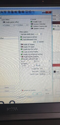

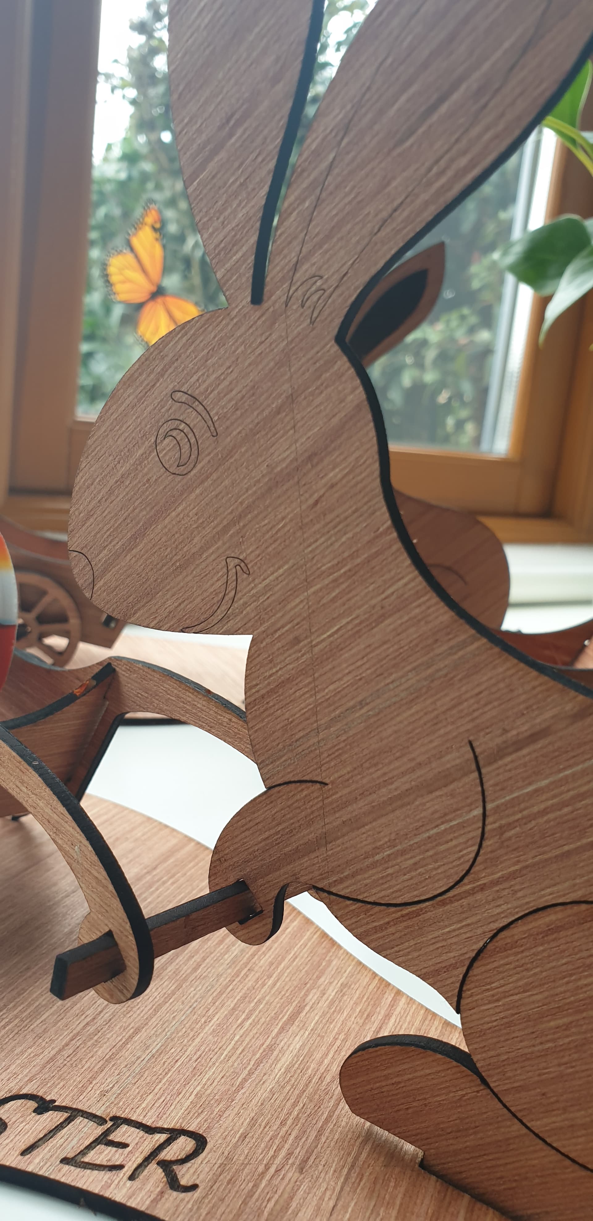

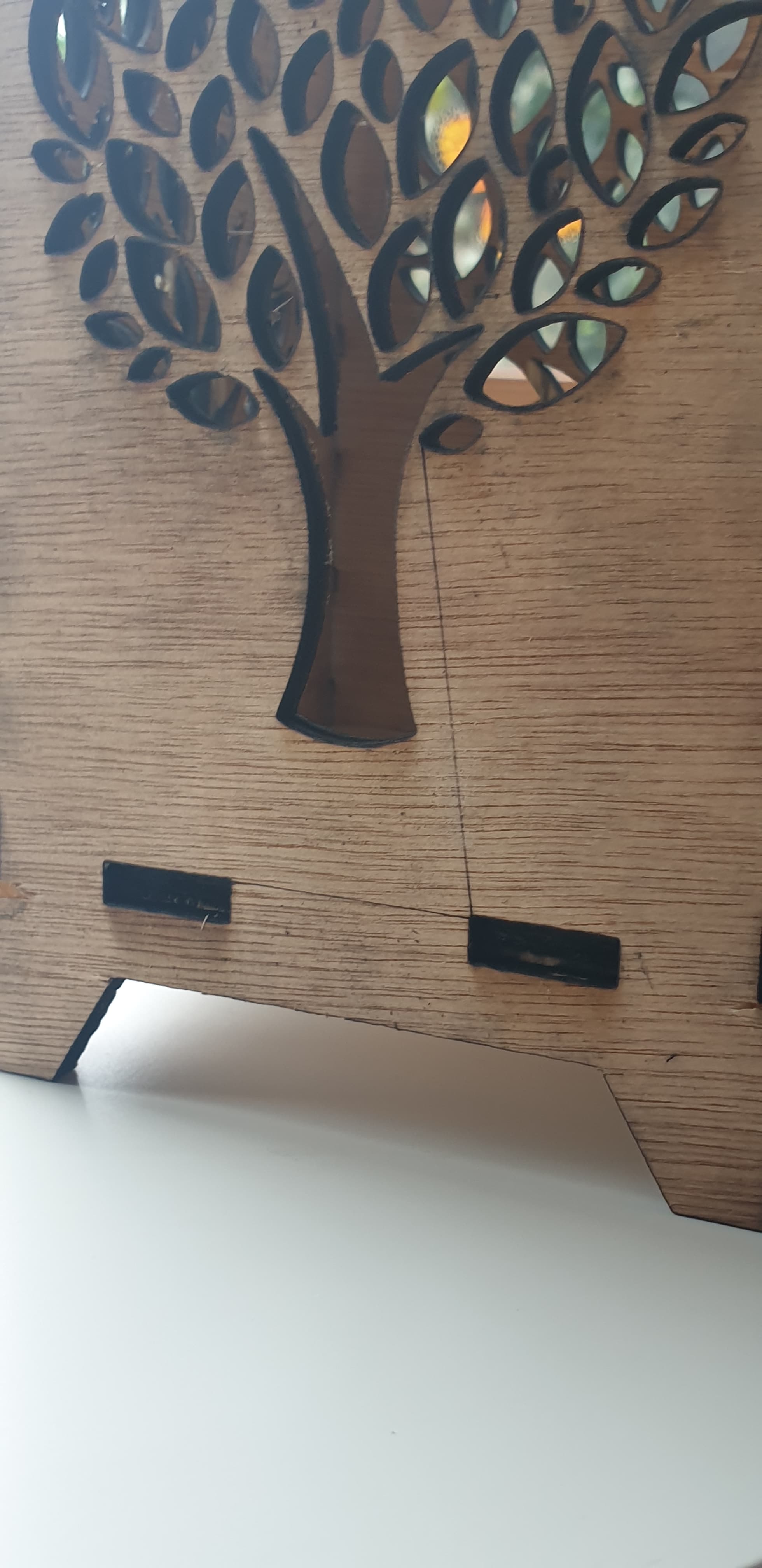

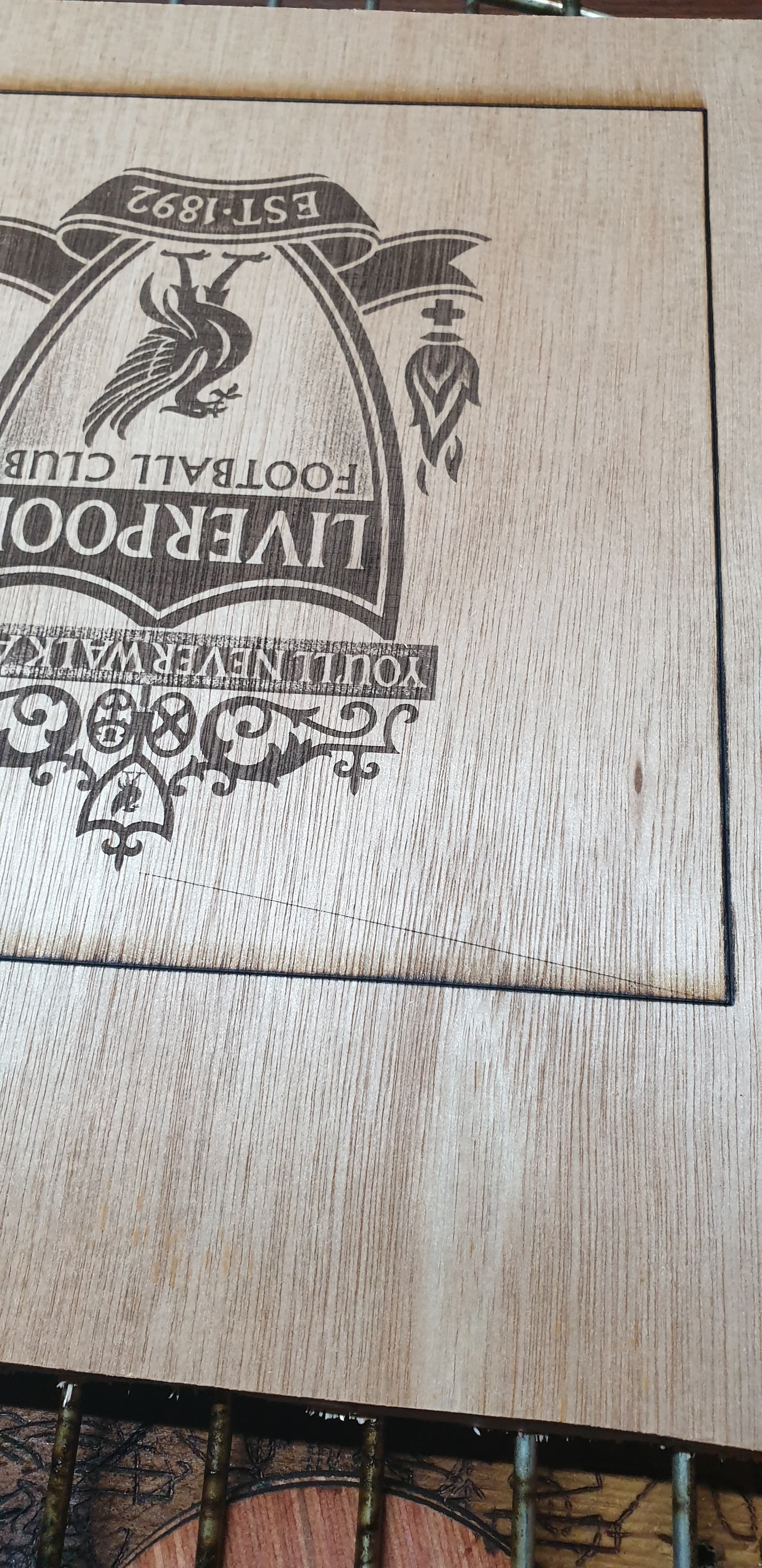

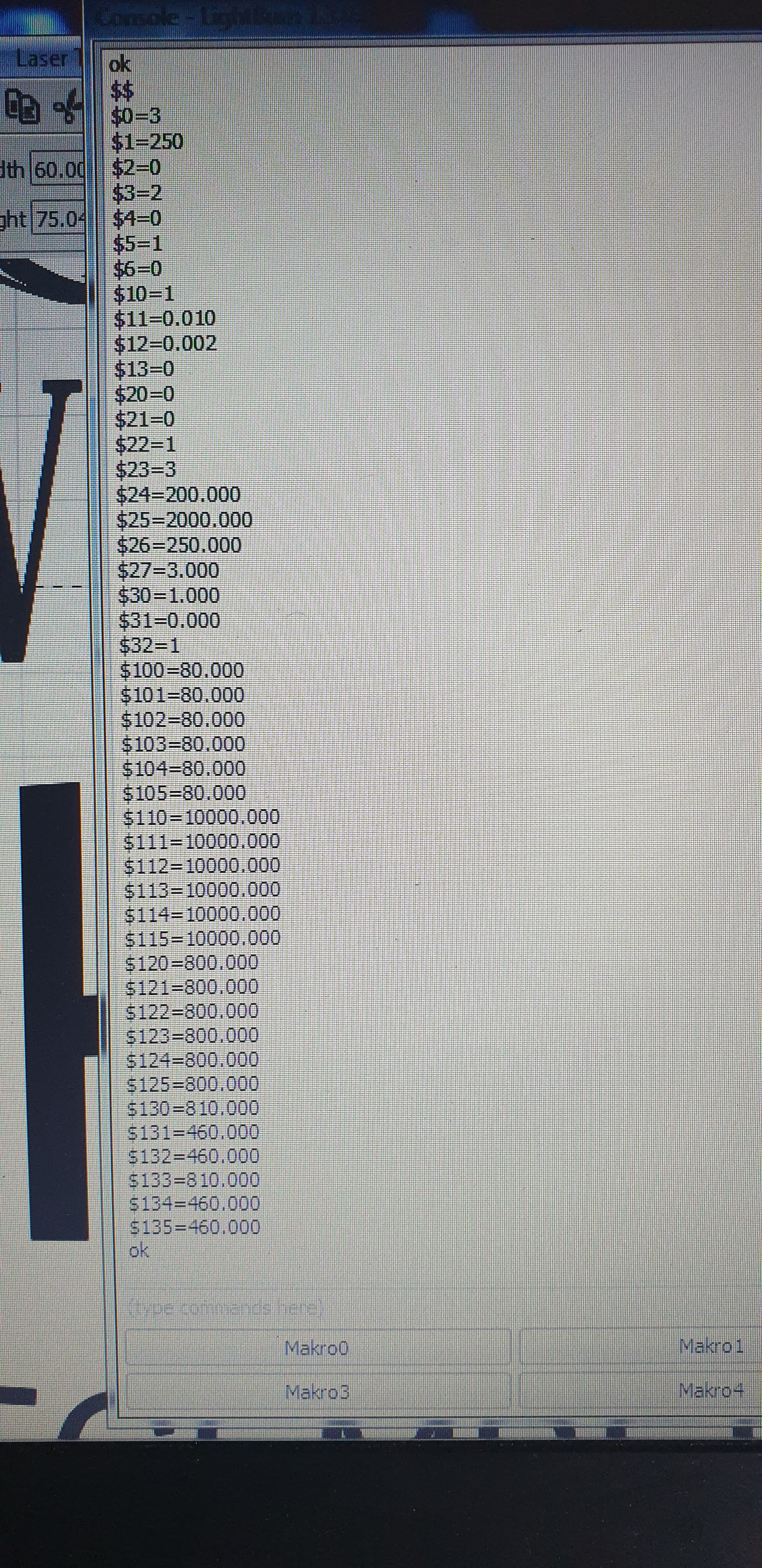

Hello, I’m a novice and please be understanding, my Zbaitu m81 engraving machine burns lines that it shouldn’t, usually when it goes to the next layer of the project,it seems to be the same power every time.
Nice job on the screen shots!
Is Constant Power Mode enabled?
It’s found in the layer details in the Cut/Layer window

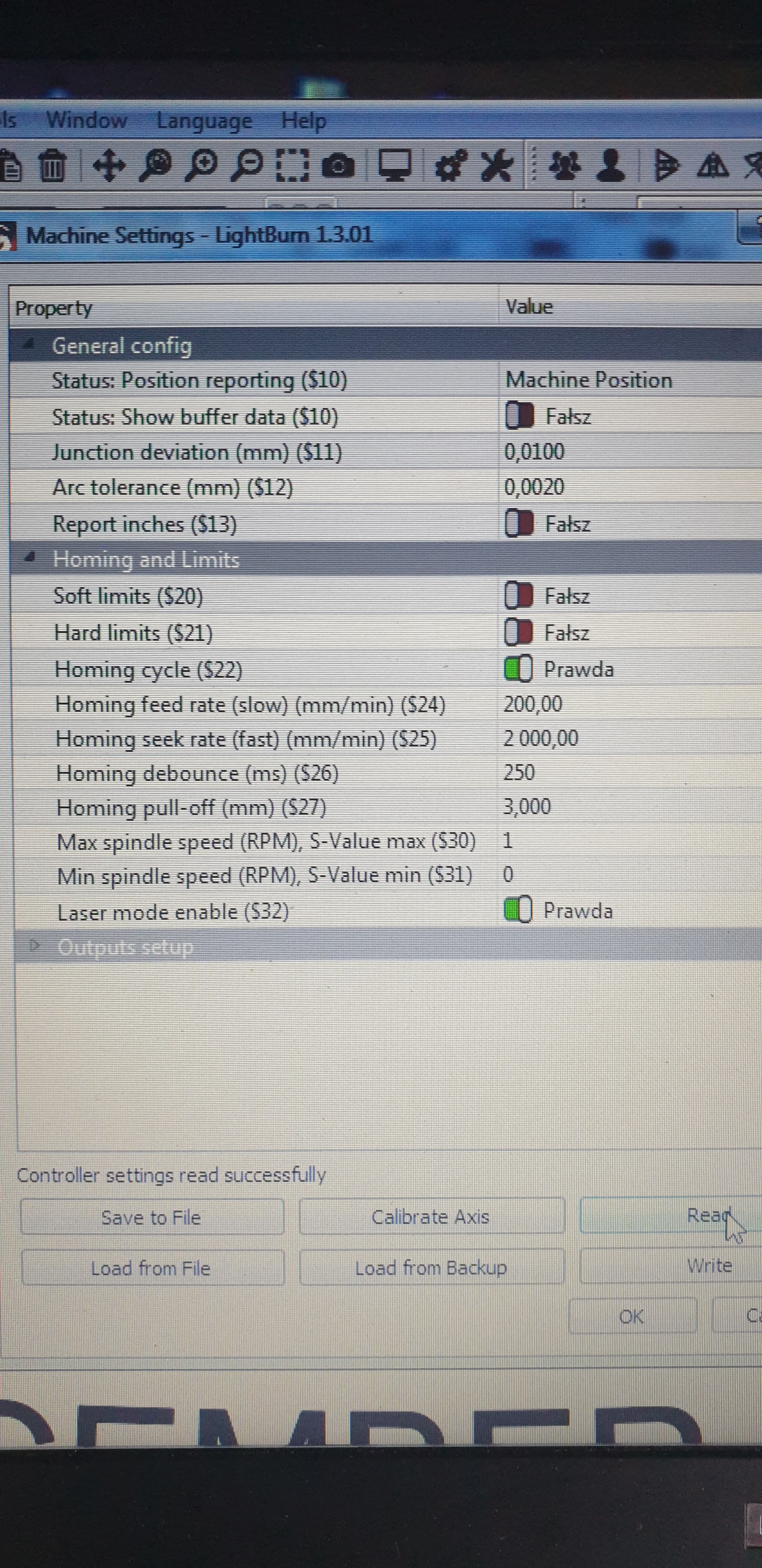

Hi,Constant Power Mode was off.
Are you not getting any power modulation at all?
Your $30 value seems off.
Change this to 1000 by entering into Console:
$30=1000
Retest.
Hi, imagine I found the cause of the problem, when in lightburn I turn off the air assist, then the engraver burns this line.
That sounds like a firmware bug in that case.

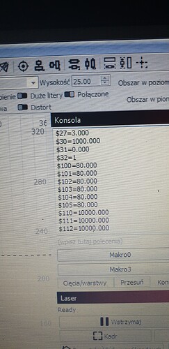

And to clarify, did you review the value of $30 from my previous post?
If I enter the value 1000, the value 1000.000 will be displayed in lightburn, I don’t know what’s going on here. I’m very confused
That looks fine as those digits are not significant. You should now have access to 1000 steps of power modulation.
