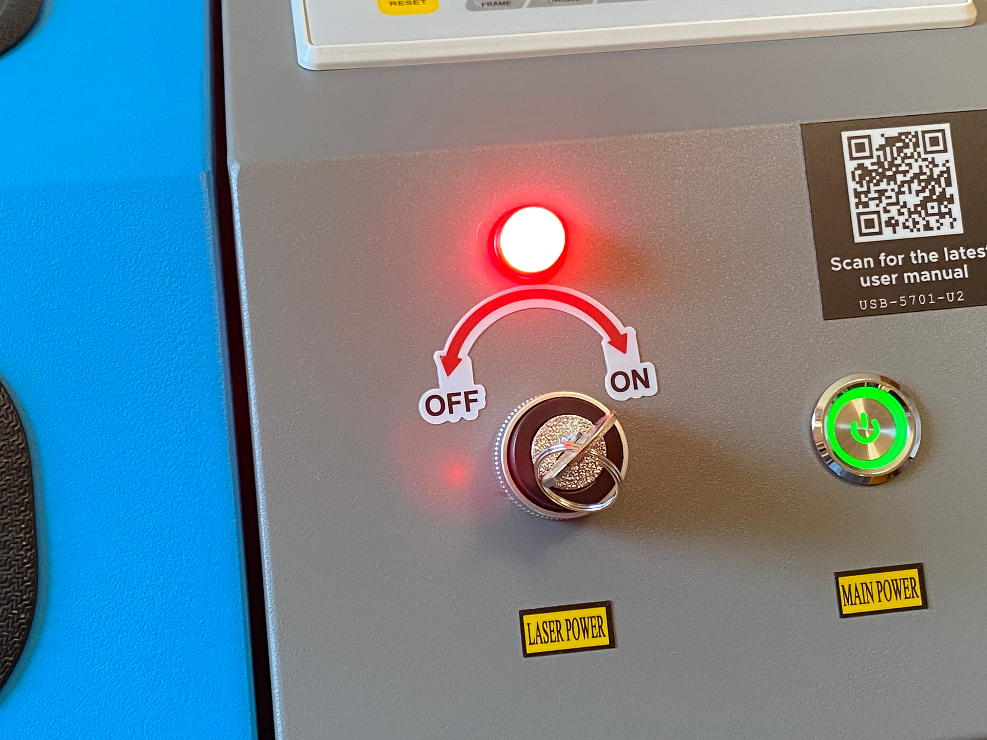

Does anyone know how much current the 5V pin on an MYJG100W laser power supply can provide? I want to add a panel indicator light to my machine to show when the laser power supply is enabled (ex, right above the laser keyswitch). I’m guessing a low-power LED should be fine, but figured I’d ask around first in case someone has gone this route before. I can’t seem to find any in-depth specs for what the I/O ports can handle.
In case the question comes up: I specifically want to wire this into the supply instead of wiring it through the keyswitch. That way I’m also covered in the (likely incredibly rare) case where the keyswitch fails closed. From a quick probe with the multimeter the 5V pin is only active when the power supply is on so it seems like a perfect candidate for this use case.

Oof, sounds like wiring to the PSU is a good bet! Either way, I won’t use it as the sole safety. I have an email out to the supply manufacturer asking for the spec, but I’m not confident that I’ll hear a response. We’ll see.
Still no news from the manufacturer so I went ahead and ordered a totally overkill indicator from digikey: https://www.digikey.com/en/products/detail/dialight/6563102303F/7062752
Indicators are cool though and I think the red color should add at least 10 horsepower to my steppers :joy: Will update once I get it installed.
Indicator is installed and seems to be working well. I might have bitten off more lumens than I wanted though…
The neat part is that it stays lit for as long as the power supply is energized. Takes about 7 seconds to turn off when the keyswitch is turned to off; must be some big capacitors in there. For reference: I measured the current draw at ~14.5mA to that indicator.
