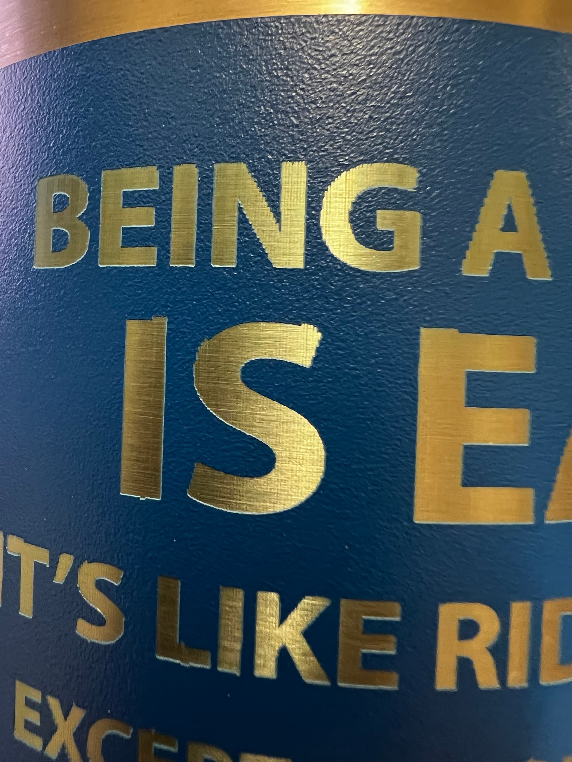

Sorry, was a little busy there. So I tried another fileā€¦same thing in certain areas. Attached a picture, check out the the large I, S and E for example. I have also attached the lightburn file as asked.
Interesting to note, is that this only seems to happen to pictures that are traced, because the test that was entered in Lightburn directly on the reverse side came out flawlessly. The part with the I, S, and E was an image I created in illustrator, which was then imported into Lightburn, and traced.

For the record 1.1.03 did it as well. I am going to try recreating the file in 1.1.03 with the same graphic, as I got a warning that the file was created in a newer version. And then Iā€™m going to try it by changing the image to just entered text, and Iā€™ll report back.
Ok, I think I got it figured out. I apologize for jumping to the conclusion that it was a software release issue.
It turns out that after I ran the update and continued with the job, the handle of a tumbler must have hit the air assist on my laser, which loosened the lens cap just enough. Itā€™s strange that it always happened in the exact same spots, but I think that is a testament to the precision of these machines.
Anyway, it wasnā€™t Lightburn, which has always been fantastic, and Iā€™m sorry I jumped to that conclusion, and Iā€™m sorry to have wasted your time. But I appreciate the support!
