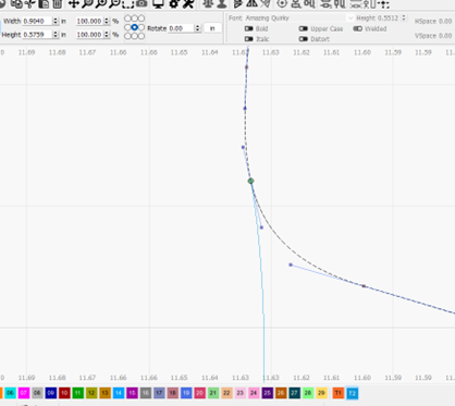

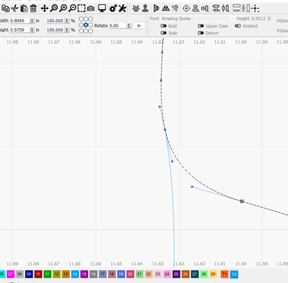

I’m having the same issue. It was fine yesterday but today, I can’t break a node in this file. I tried copying/pasting the svg to a new file, etc. No matter what the node looks like before I click on it, once I click, it appears to be a “leading” node. It then looks like it breaks but once I try to move the node away, it’s clear it’s not broken. I then clicked on another node (grey at the time of clicking) which then shows as a “leading” node. Looks like it breaks. It’s not broken.

Speaking only for myself, I cannot provide any assistance without poking into the file causing the problem. Your screenshots suggest there an overlaid vector, but there’s no way to tell from here.
