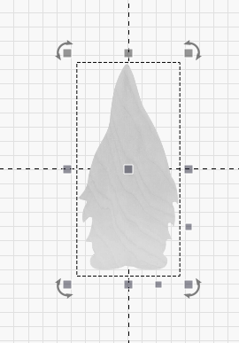

(The imported image is visible in the workspace. I select and right click and select Trace Image. The Trace Image window comes up with no image, or, it could come up with a fraction of the top left of the image in the lower right of the area where the image should be seen. If I click to enlarge to full screen, I see nothing in the image area.) It is .png as downloaded by remove.bg and imported into LB and selected for tracing.
I also attached the jpg of the image that will open as it should in the Trace Image window.
below is the .jpg of the original image that does open ok in the Trace window, followed by screen shot of Trace Image window, showing a fraction of the image in the lower right.

At the moment, the image is 1.5" x 3.5" and it loads into the Trace Window as above, ie just the top left of the gnome’s hat is visible in the lower right of the Trace image area. (The .png image had background removed in www.remove.bg . Up until now, I did this all the time and it worked well for me.)
But did you try to zoom out? What about dragging while pressing the middle mouse button (the wheel)?
BINGO! My computer has a touchpad, not a mouse, but using fingers on the pad to zoom out did work!
I should not have to do this…it is a glitch in importing .pngs with background removed and it wasn’t an issue 2 weeks ago… but since it works, I’m good. Thank you for the helpful suggestion.
