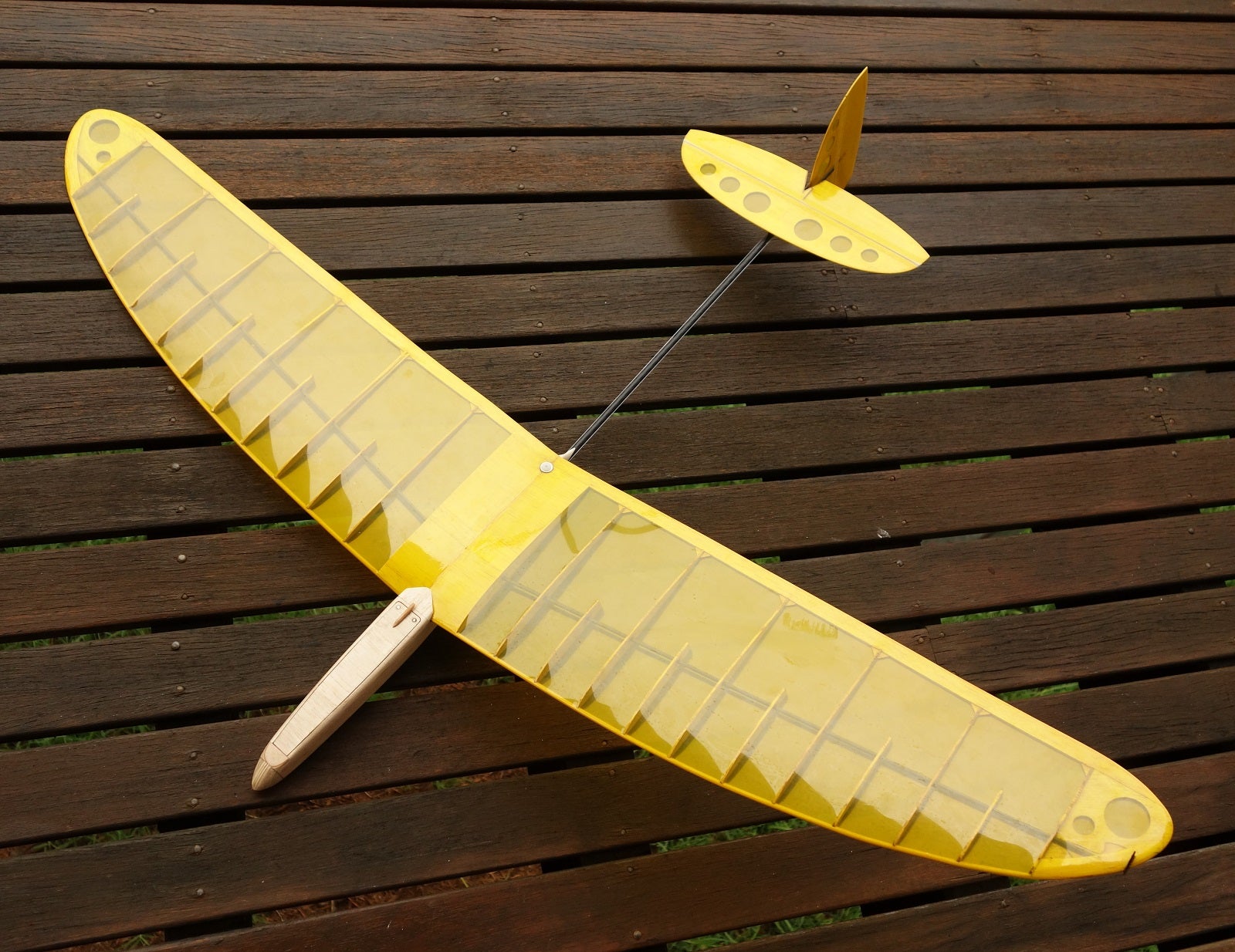

this was the impetus to buy the neje 2s - no way i could accurately cut the ribs required with round bits missing for the leading edge and spar, but the software (after some initial hiccups) made that a much less onerous task
i adapted an existing design and modified it considerably; producing the required parts was impressively simple, and it has since assisted in bespoke formers and mounts for a second little glider
lightening holes in the stabiliser and fin? see me go…
wingtips with complex inset ply? yep, i’m there

and the completed (but not yet covered) wing

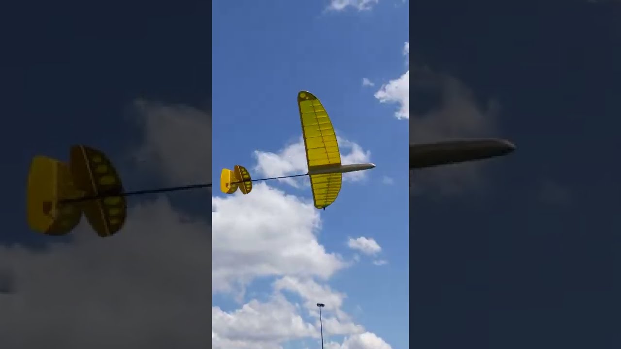

and the final product ready to fly
and doing its stuff :slight_smile: - replaced the initial video with the one i actually meant to link

i’m very pleased with the laser, and the ability of the software to make it useful :+1:
