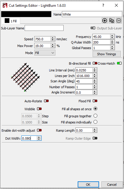

Hi, all. I and having a real challenge getting started with my new laser. I have been using LB for a couple of year with both Diode and CO2 lasers. This fiber is kicking my but. trying to engrave metal bottle openers and comes out either brown of almost like a burnt black that does not look very good, not smooth and dull colors. I know it is my setting and understanding of the fiber laser. Just need a starting point.

Leave Q Pulse at 200 to start. Brown and burnt usually = too much power. 100W will overpower metals, cut power back and use multiple passes with angle increment. If deep engraving mix in a “White” cleanup pass every 5-10 regular passes.

Thanks for the response and sorry for the delay. Need to understand the clean up pass, but my test is currently one pass. the lens is a 175mm i am using and yes this are SS bottle openers. I have a library, but really not sure who provide can from the Laser seller. I will see if I can find. Thank you

So as far as white passes, usually up the frequency and drop the power, on my 60W 175 lens I drop the power to 19%.
Run this every 5-10 passes of SS parameter, comes out pretty clean.
If I run this at 100% throws a lot of sparks / slag , then I hit it with the wet-dry to restore the surface finish.
