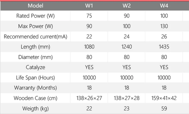

IMHO… A W4 100W RECI… a good tube, like this, should have an mtbf of about 10k hours as they specify at operating current.
Most good tubes give you both an operating and a do not exceed current. The tube gases get broken up quickly if you run above the do not exceed value. Sorry, don’t know the physics here.
The specification would be worthless if the mtbf is based on something other than suggested operating current. If you had to run 70% current to make it last the listed mtbf what would that mean? Unless they note different conditions of operation …
This advertisement for a K40 it’s noted mtbf/current relationship. Even in the best condition, tube life with these are not what I’d call even reasonable.
However all this is moot if you are not calibrated so that 100% power in Lightburn equates to 100% power or current. Lacking a mA meter (and a watt meter) you don’t really know what you have.

Both of these are from Cloud Ray. Notice they don’t state mtbf on these.
These are the reci specifications. Lots of people swear by these tubes.
