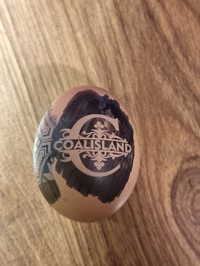

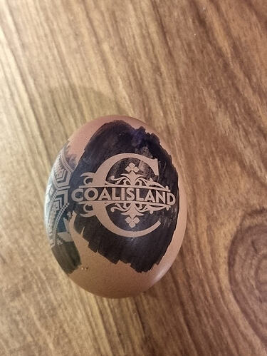

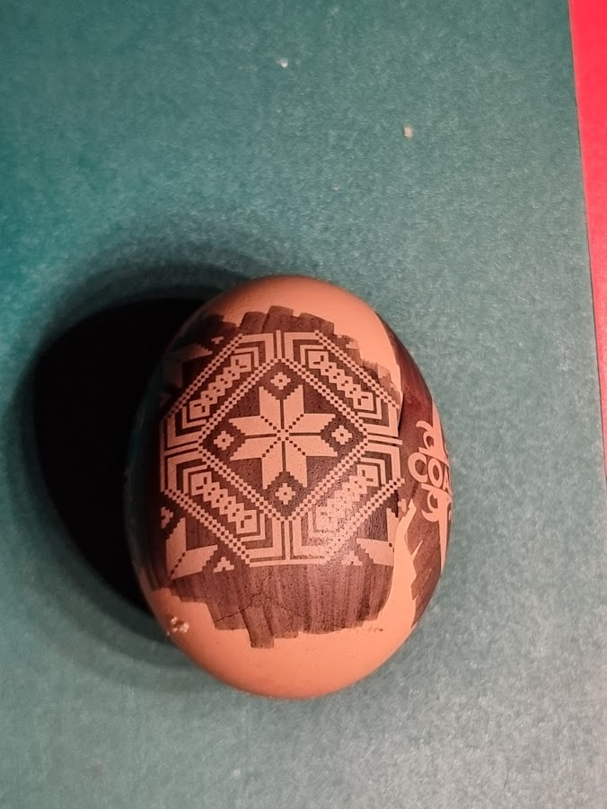

Fiber, however, completely ignores the egg. Just like paper or wood. Not even a single mark or wisp of a spark… Soooooo, i sharpied it :smiley: And it worked marvelously.

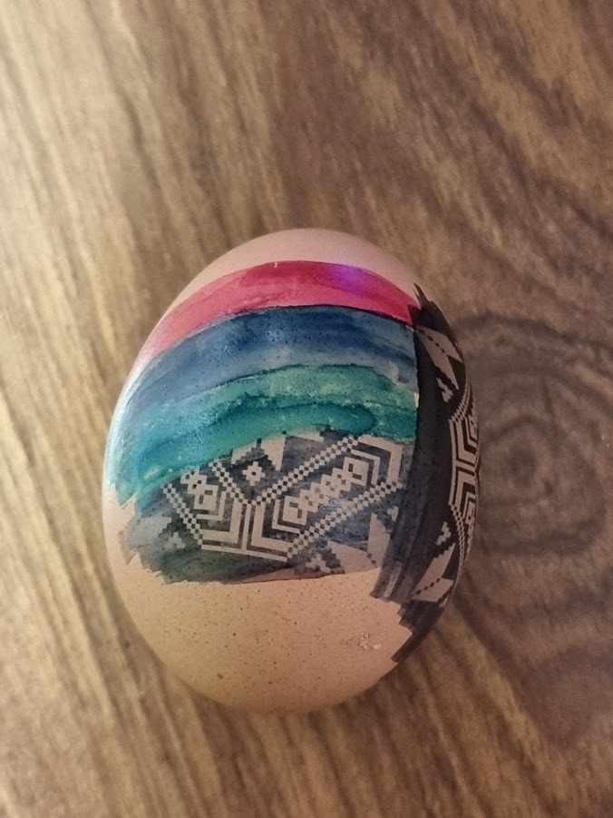

I have a massive set of coloured felt tips (something like 100 colours), i figured i’m gonna rainbow the egg and engrave, just to find that pretty much any colour in that set is ignored, except for black… wth…
Results:
