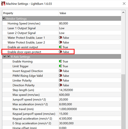

The open door sensor does not work at the moment. It is connected to DrProc and GND. How do I activate that it cancel start if door is not closed? At the moment it works opened and closed - so it is not working anyway.

Your door protect is disabled. I would have thought if you had read through these, it would have been obvious…

I solved the door protect (made screenshot before activate the setting so you are right with that). Had to invert the connector to NO for Ruida to work as expected.
