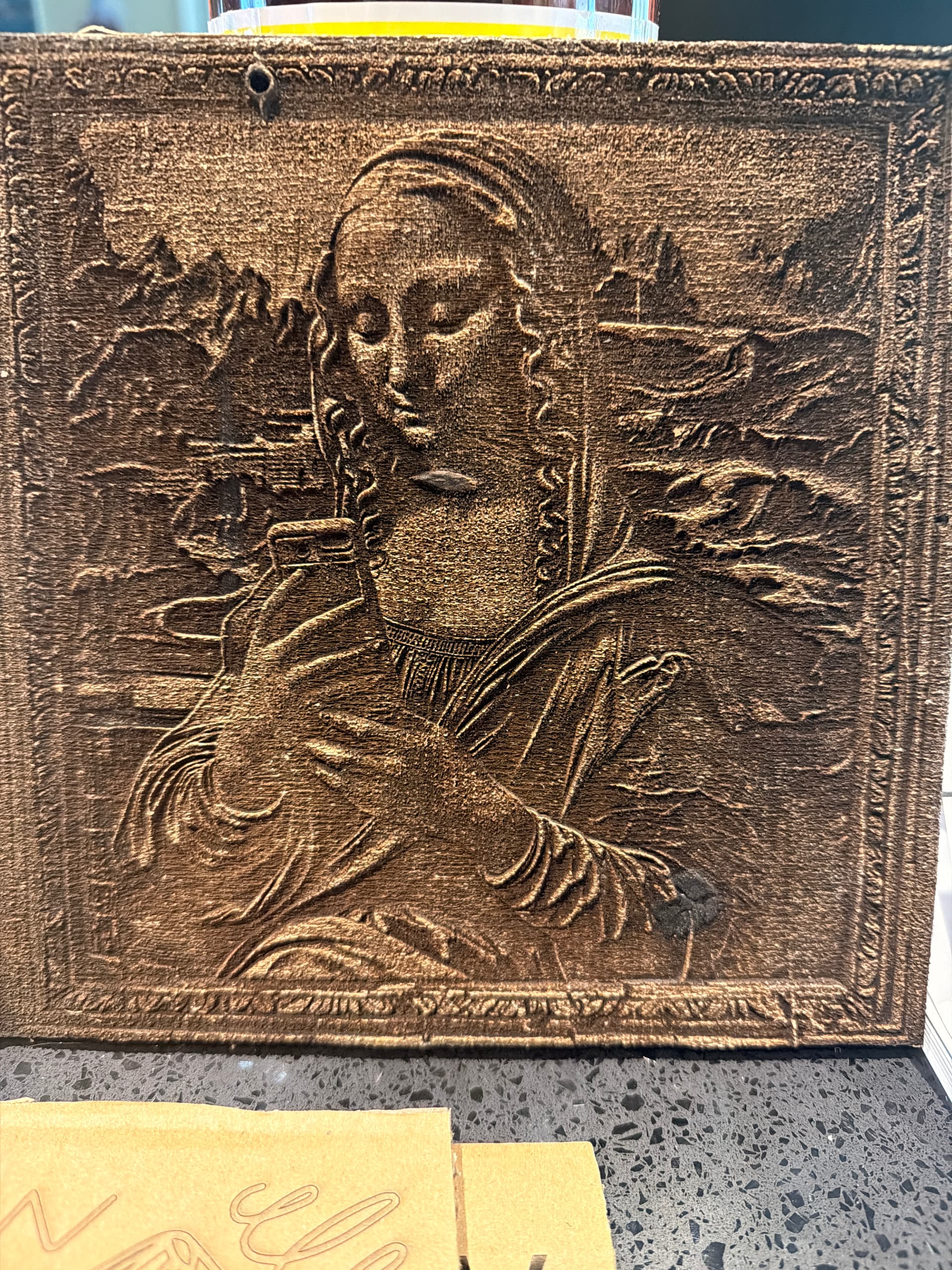

Creality Falcon A1
Spare piece of 1/4” pine plywood
Greyscale
Min 20 max 60
256dpi
700mms
2 passes
This would be 42,000 mm/m, so I think you meant 700mm/m?
That is a very interesting piece of art, and really, really good for someone just starting out with lasers. Is it true 3D or is 3D by using the shadows? I would really like to see it in person. If you do not do Freedom Lake Hamfest (Nov. 8th), can you give it to your brother to show off?
