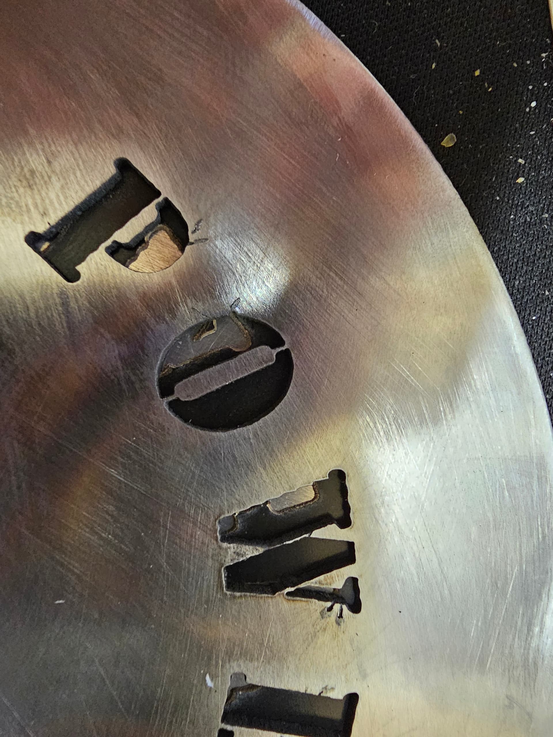

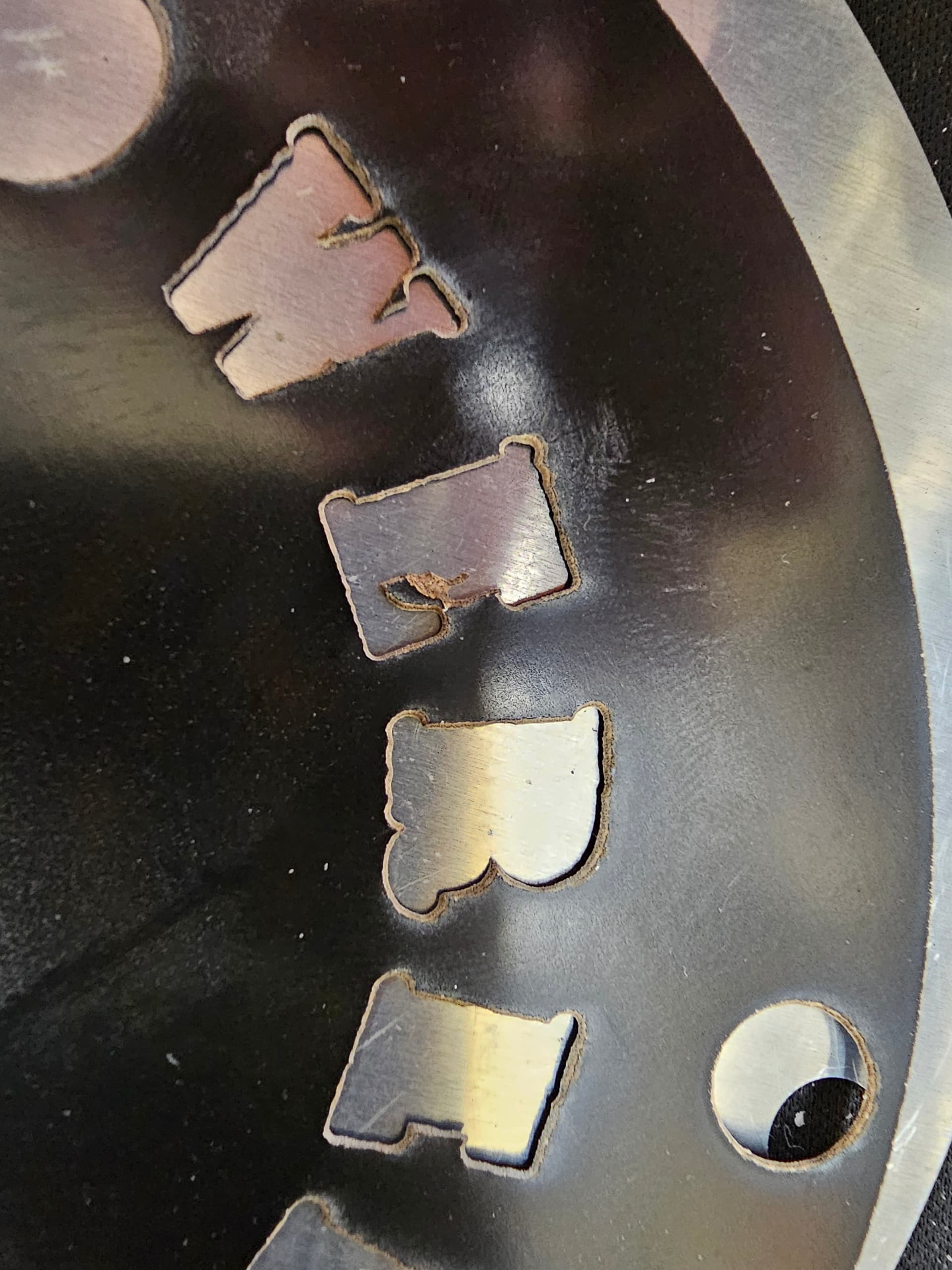

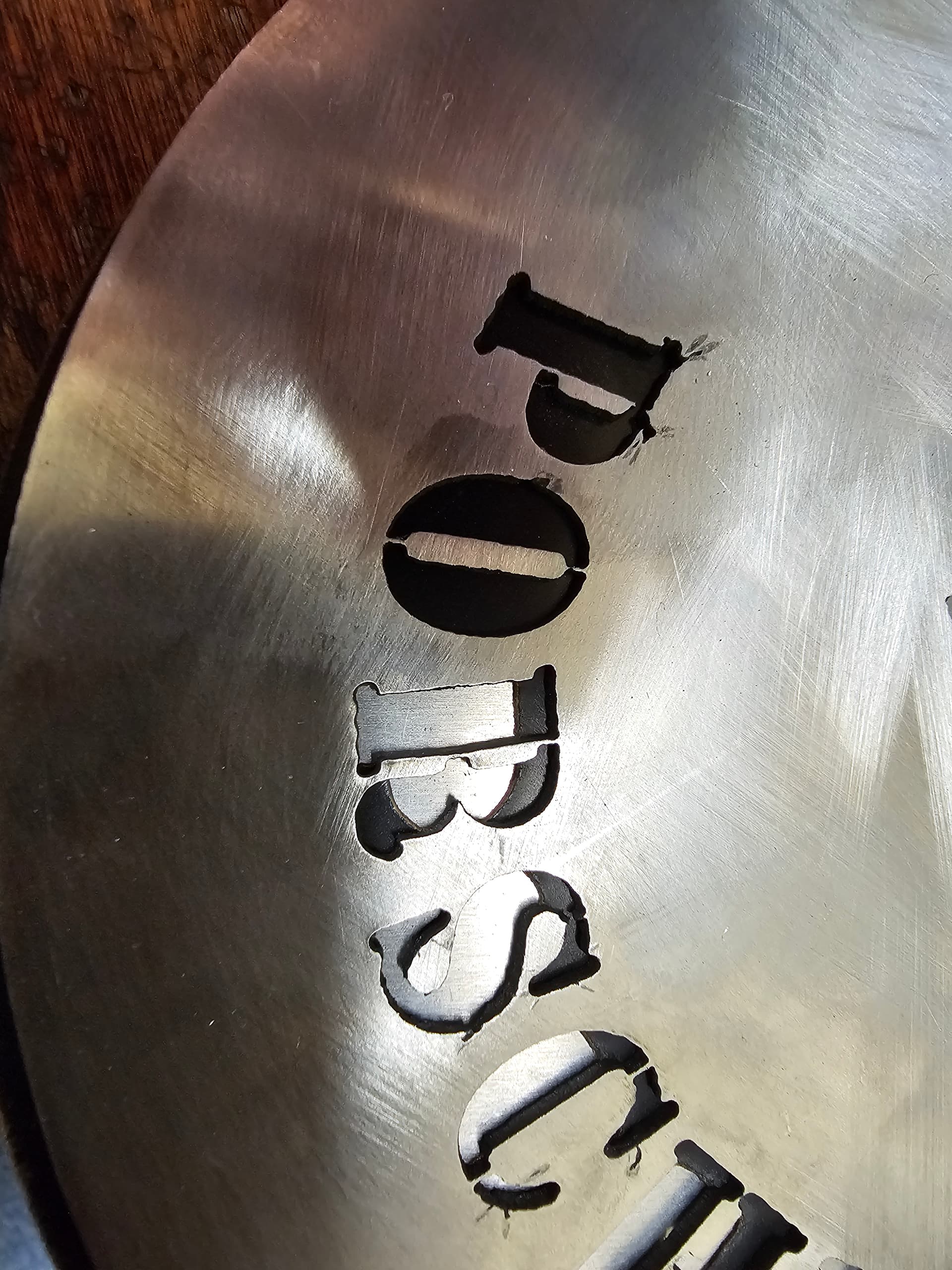

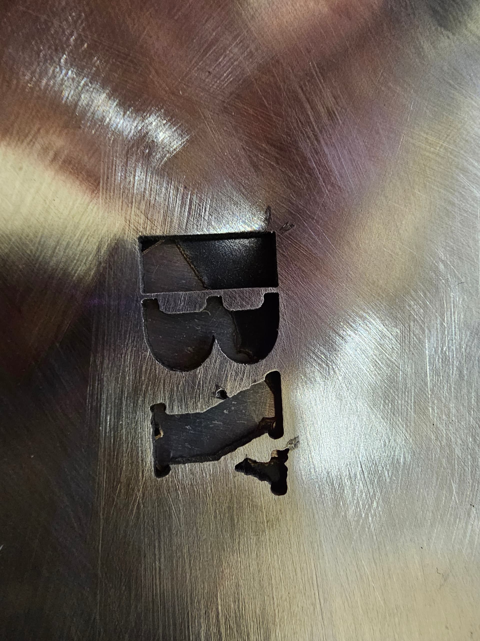

Hi, I have a 1390 gantry laser and have a lot of trouble getting nice edges when cutting.
It’s like if there are steps or stairs instead of straight lines
I tried to adjust all the belts, reduce axis acceleration, reduce speed but, nothing seems to work.
Does not look the motor are loosing steps since the finish line is at the exact same place than the starting point. Dimensions are OK.

Hi, here are some pictures of what I was talking about. The belts look like they are OK, but I don’t have any way to measure how much weight I could use on the belt and what measure I should have.

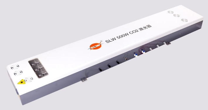

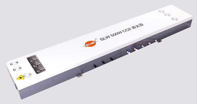

This is a hybrid laser cutter, can cut metal up to 3mm,but you must use oxygen for cutting. The picture show 1.5mm thick stainless. This problem will also be present with wood and acrylic or any other materials. My first thought was maybe water in the compressed air, but it’s the same with a bottle of oxygen. It has 3 laser tubes for a total of 500W.
When I put tape on the tip of the nozzle, the hole is exactly at the center.
The picture or the laser cutter is from the factory. I have it for maybe 8 months and barely used it. Maybe 20 to 25 hours.
I tried to lower acc. for the X and Y axis and no improvement.
Thanks again, everyone for your comments. Jeff
How are these come together to form a single beam? Is it just a combiner?
Seems like this, in itself, could cause strange beam configurations.
It looks mechanical, but with 3 sources, I wonder…
When I scrutinized the photo, I could see it’s head was a bit odd from what I’m used to seeing.
Is there any kind of procedure to align all three tubes?
Screenshot 2025-06-25 021850
This is the path for the laser
The tubes are inside an enclosure like in the picture
I’ve never seen one where the tubes were series to each other like this… Thanks for the information… learn something everyday.
I still feel like it’s a mechanical issue.. I’ve never used anything this large, so I can’t make too many suggestions.
…I have also never seen a 500Watt CO2 in series, consisting of 3 tubes and I am impressed. I would have thought that it was not possible to “get in” from behind, in the next tube…, but those are probably completely different tubes that I know.
However, it seems to me a bit like your problem could come from your laser head. If the structure is similar to a normal head, except for cooling, then there is a “chance” that a lens or mirror in the head is loose. It should be easy to check and rule out as a source of error.

I think I found my problem, I was going too fast (was using the setting they gave me) was at 100mm/sec and machine was shacking a lot. I tried between 10 and 15mm/s and the cut is much more acceptable.
So instead of cutting at 100mm/s and 50%, I cut at 12mm/s at 15%.
Cutting large parts with not a lot of details is OK at high speed.
