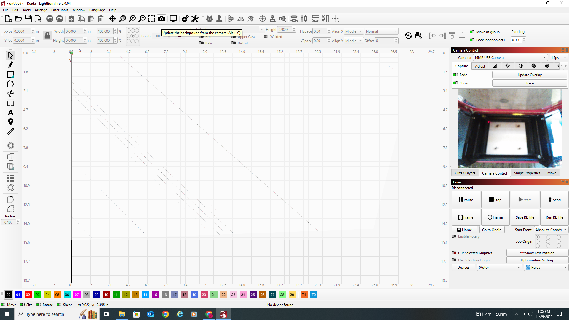

Updated Software and installed new camera ELP USB Camera Amazon listed as compatible with Lightburn since I old Lightburn camera stopped working with an update. Calibrate Camera Lens went great and image shows in Camera controls but all I get is a black image while trying to calibrate Camera Alignment. and this image in the screen shot when I try to take an image.
Did you change the camera capture system in main settings?
