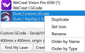

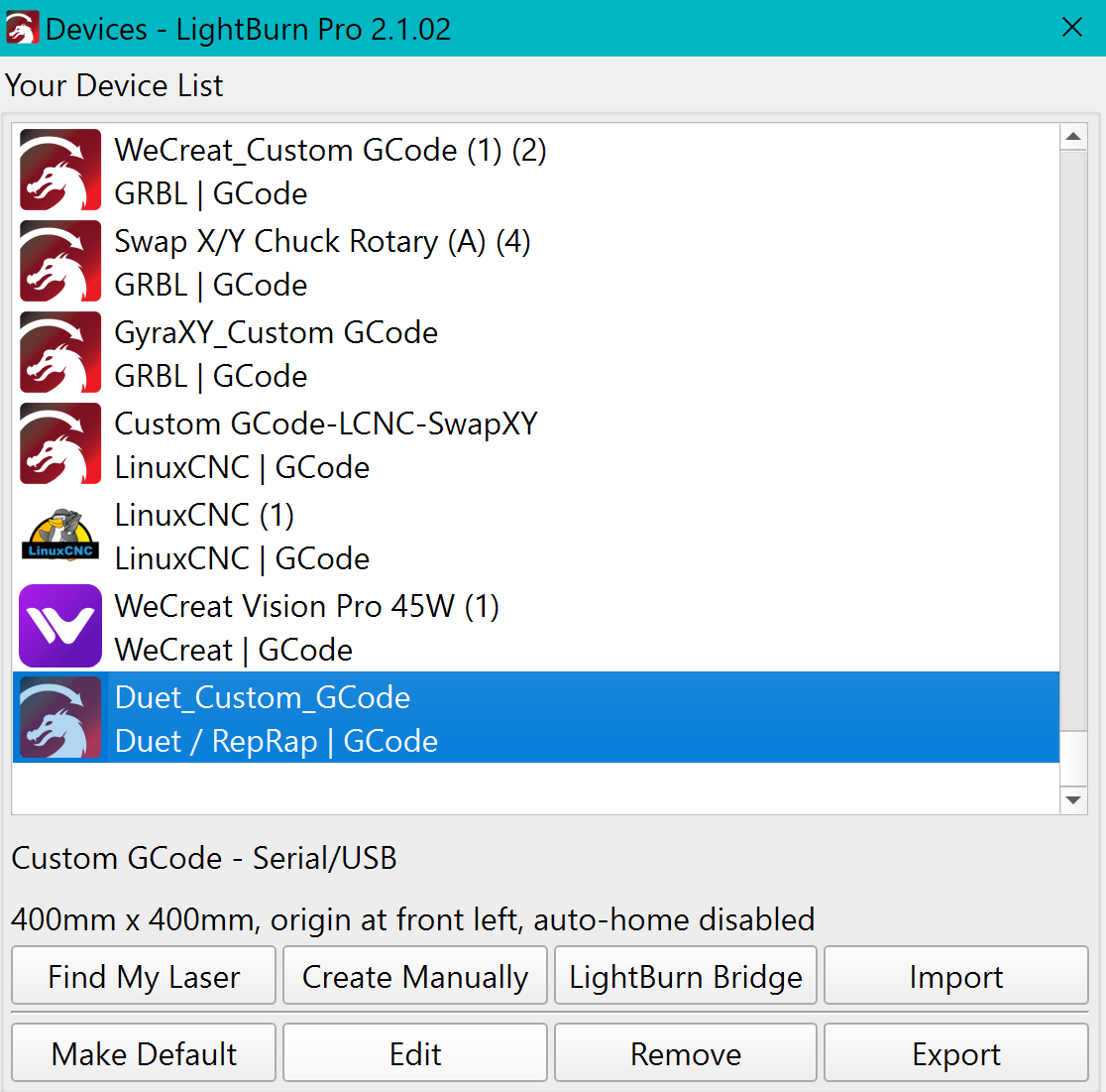

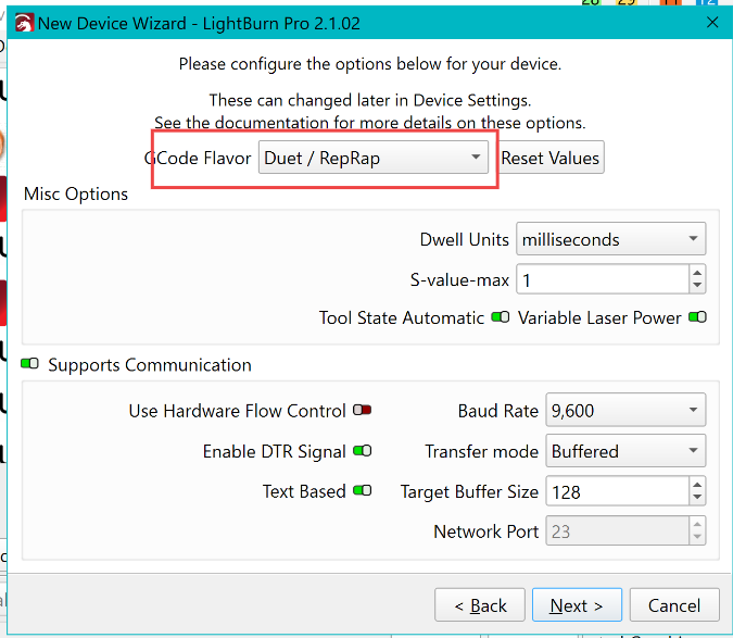

You have to define a Custom Gcode Device as Duet/RepRap Flavor:
As I was at it here is a start device, just drag into LightBurn Worksopace and please review the settings:
Duet.lbzip (1.1 KB)

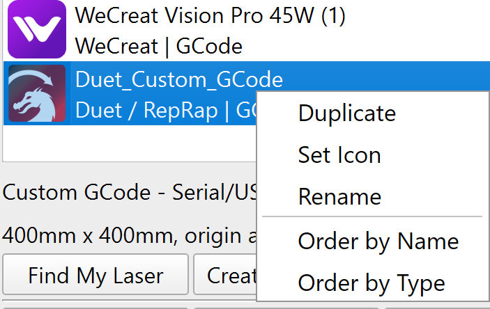

Right-clicking on your current device you can also do a copy edit it and set as a Custom GCode device.
