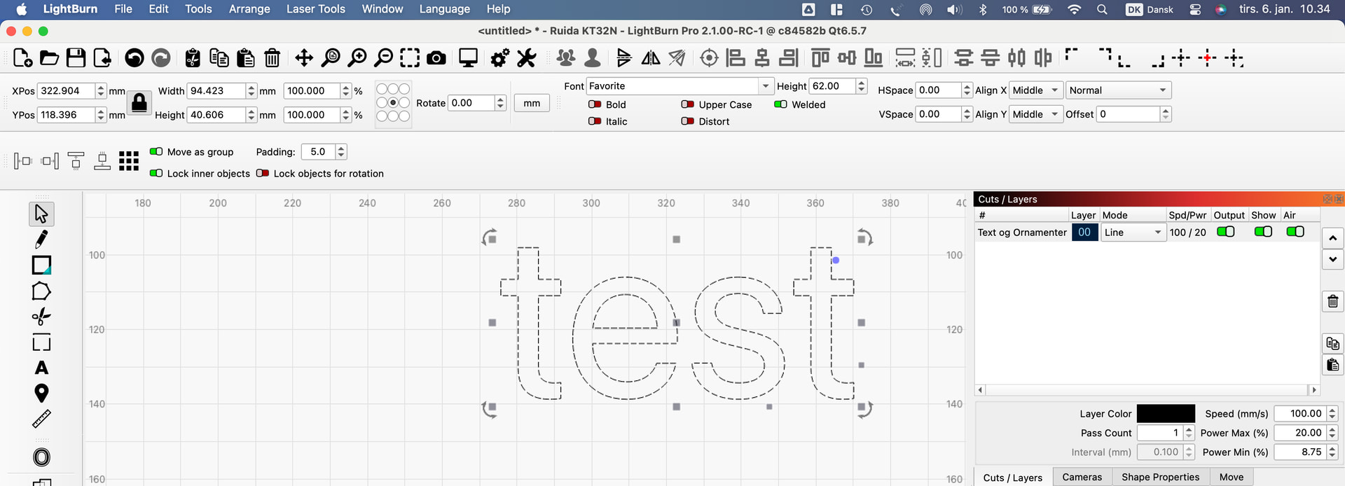

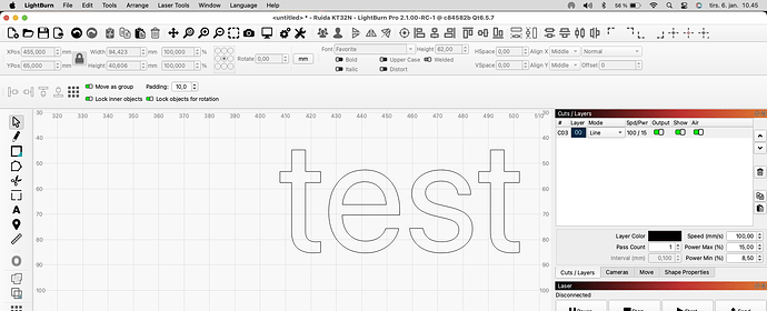

However, from the screenshots you posted on Jan6, your MacBook appears to allow “Favorite” to be selected as the active font.
In particular:- In the screenshot “Skærmbillede 2026-01-03 kl. 08.01.07”, Arial is shown as the active font.
- In the screenshots “Skærmbillede 2026-01-03 kl. 08.01.37” and “MacOS-LB-2100RC1”, “Favorite” is shown as the active font.
- The Windows screenshots “LB-Win10-autoExposure” and “LB-Win10-manuel” correctly display a valid font in the edit box.
This suggests that the font system behavior on your MacBook is erratic and does not match what is seen on other test systems. Understanding how your system is able to set “Favorite” as an active font is very important to us, as this is the more critical part of the problem.

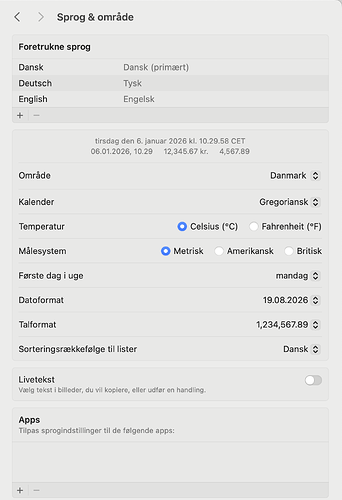

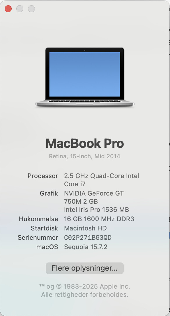

Hi Girish,
Also to you and the entire LightBurn Team, my best New Year wishes to you.

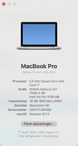

I am splitting this answer into 2, because I am sending the information from the 2 Macs directly from the machines.
In addition to SHX fonts, I only have a few extra, not MacOS standard installed fonts, such as stencil fonts.
Both MacBooks are fairly similar in setup of LB, MBP1 I have always used as a construction and design computer for LightBurn while I used a Linux PC for the actual operation of the laser machine. The LB files are either sent over LAN or e-mail to each other. Since Linux support has stopped, I have started to prepare an MBP (no.2) to take over my Linux computer’s task of controlling the laser. Communication between all 3 machines takes place over LAN/Wifi, this of course also applies to my laser (standard OMT with Ruida clone)
Both MBP use LB 2.1.00 RC1
Here are the pictures from No.1 with system information, if you are missing specified information, please report back.

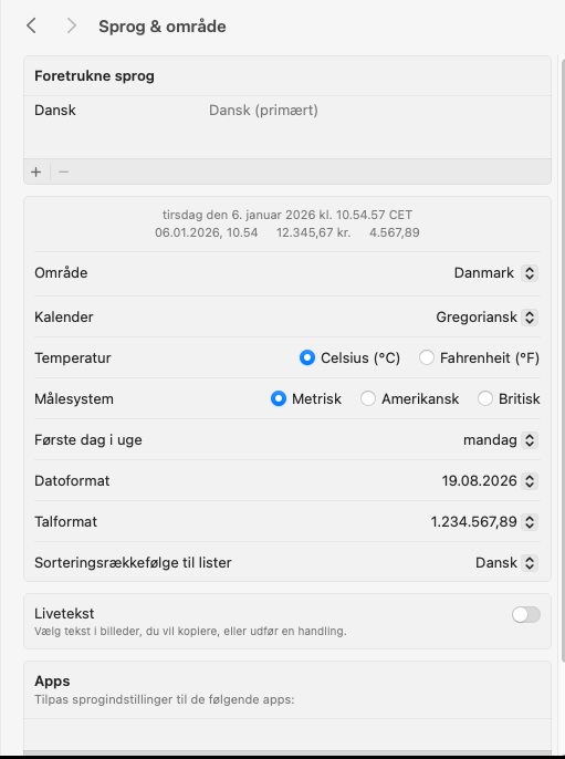

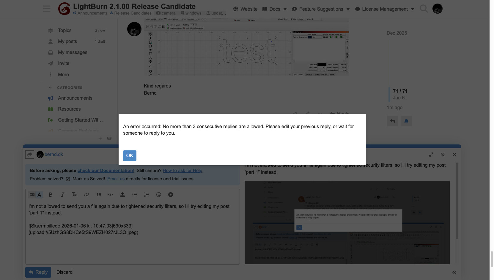

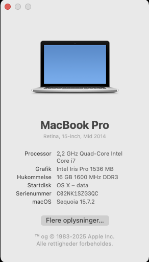

I’m not allowed to send you a file again due to tightened security filters, so I’ll try editing my post “part 1” instead.
MBP nr.2

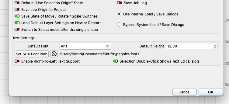

Not sure, if you answered this already, but which default font did you set in the LightBurn Settings?
Your screenshots already confirm that you are working with a fresh project file. I would be curious to know which font name gets saved to the .lbrn2 file if you save one.

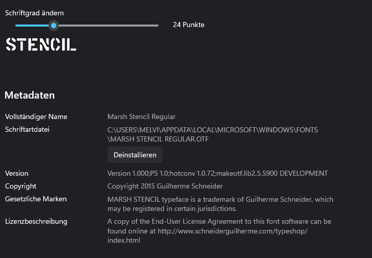

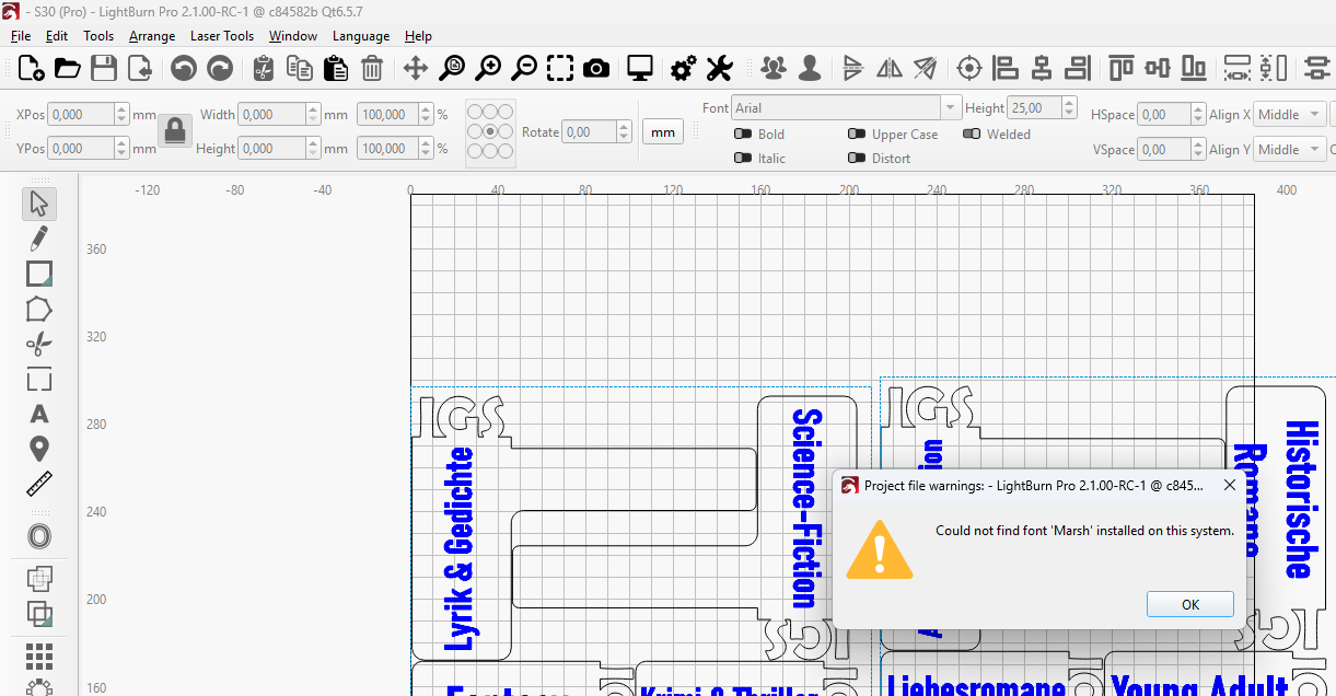

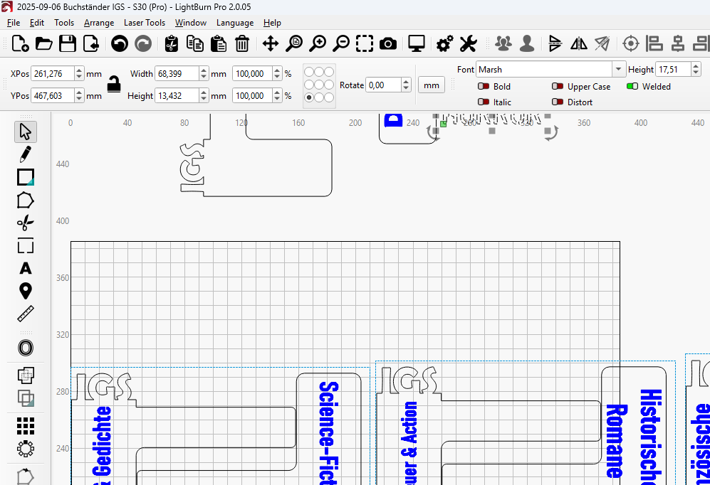

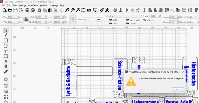

Hi guys,
I have found another font issue, so I thought I might put it here. I have a project using a font “Marsh” (didn’t even really use it, was just for testing the design). I can open it without any issues in 2.0.0.5, but if I open the file with 2.1, I get the message that the font can’t be found. It’s on the same PC, both versions installed in parallel. It’s only that font, the file includes more fonts.
2.1:
2.0.0.5:
That’s what Windows says about the font:
Good to know that your default font is Arial. That’s the most standard one, and unlikely to be directly related then.
Interesting. I’ll talk to Girish to see what it might mean.
Thank you for stepping in.
I do think that’s related. It seems as if another font name is being referenced, which then cannot be found.
We found this “Marsh Stencil Regular” font on fontget.com and will run some tests.
