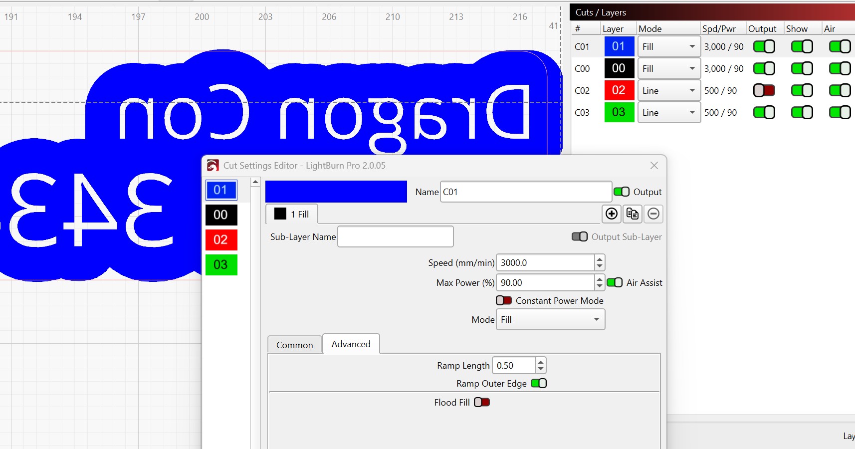

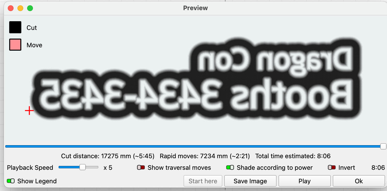

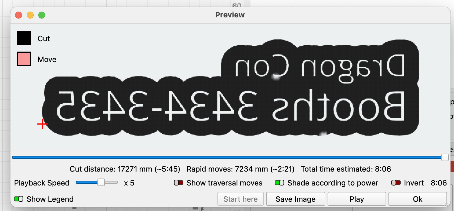

I have a rubber stamp project. Ramp is on. The same file under 2.0.05 & 2.1.01 shows differently in the preview. I’m not sure whether there are other issues, as I haven’t tried to burn under 2.1 yet.
2.0.05:
2.1+
That first image is strange, as in fuzzy. I would have expected it to be crisp edges like the bottom one.

It shows like that when I turn on the ramp with Outer Edge on.

The bad news is that the v2.0.05 and v2.1.01 look the same on my machine.
”Chosen font” revisited: Is it possible that fuzzy look is caused by using the “OPEN SANS” font? I tried some text with Arial, but it still had crisp edges.
Even if I just preview the outline area, not the text, it shows the edge of the blue area as shaded on 2.0, not on 2.1. So it’s not the fonts. It’s something about ramp and the way it’s being previewed. With ramp off, it’s sharp on both.
