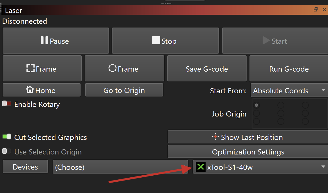

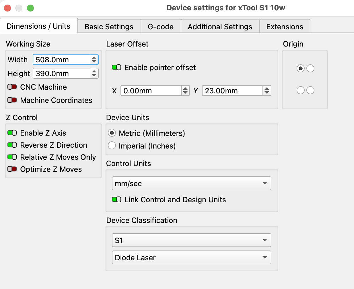

Can you post a screenshot of the first page of your current device’s settings, similar to this?
OK, I’ll tackle this later this morning and report back.

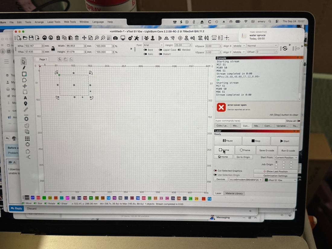

So I did the following with my existing laser defs:
  1. drew a box, and set “Start From” to “Absolute Coords”

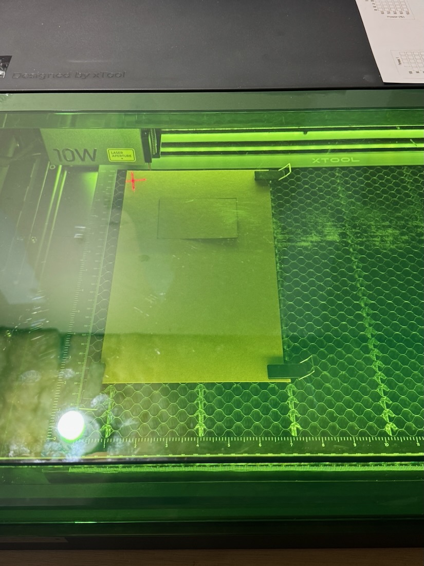

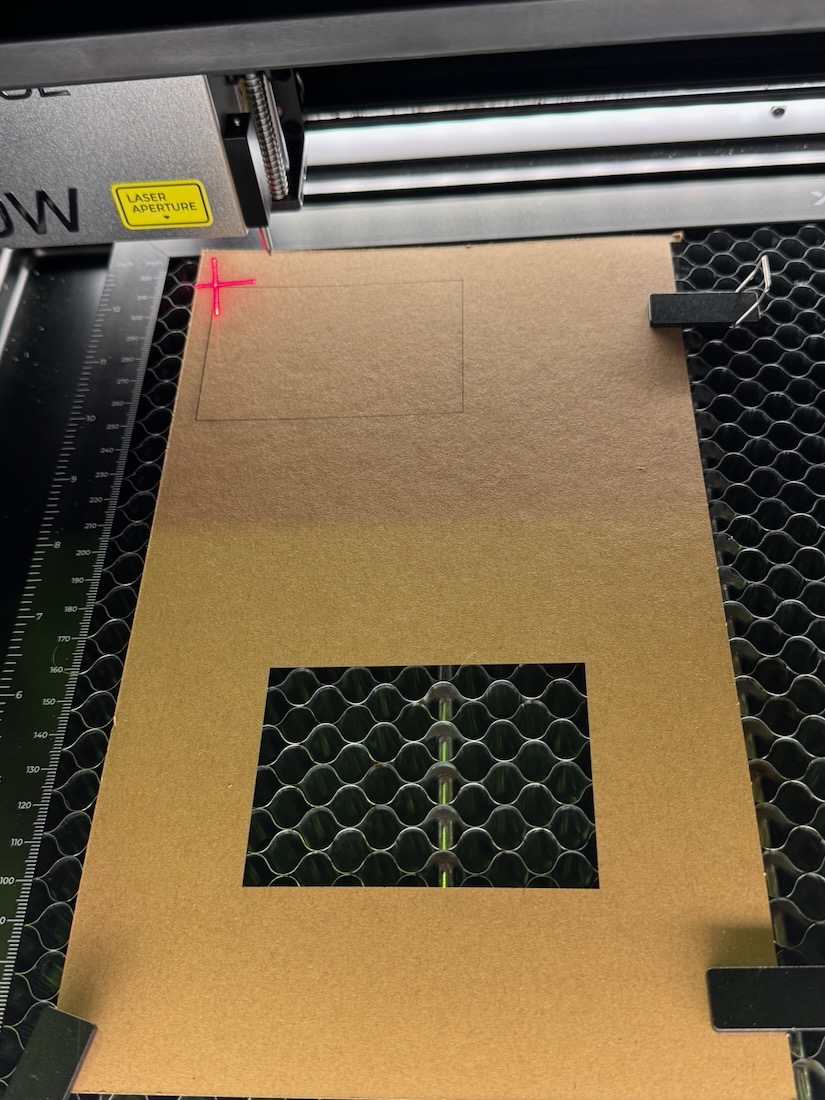

  2. I pressed Frame, which ran where I expected. (sorry for the ugly photo)
  3. Then pressed Run, and the box was cut where I expected.
  4. I flipped the material over, and then changed “Start From” to “Current Position”
    (I did move the box a bit within Lightburn)
  5. I ran Frame and the head moved where I expected.
  6. Then I pressed Run, and the box was cut at (or near) the home location:
So my conclusion from this is there’s something going on with “Current Position”, and in particular, there is a difference in how Frame moves the laser (meeting expectations) to how Run moves the laser (not the same!)

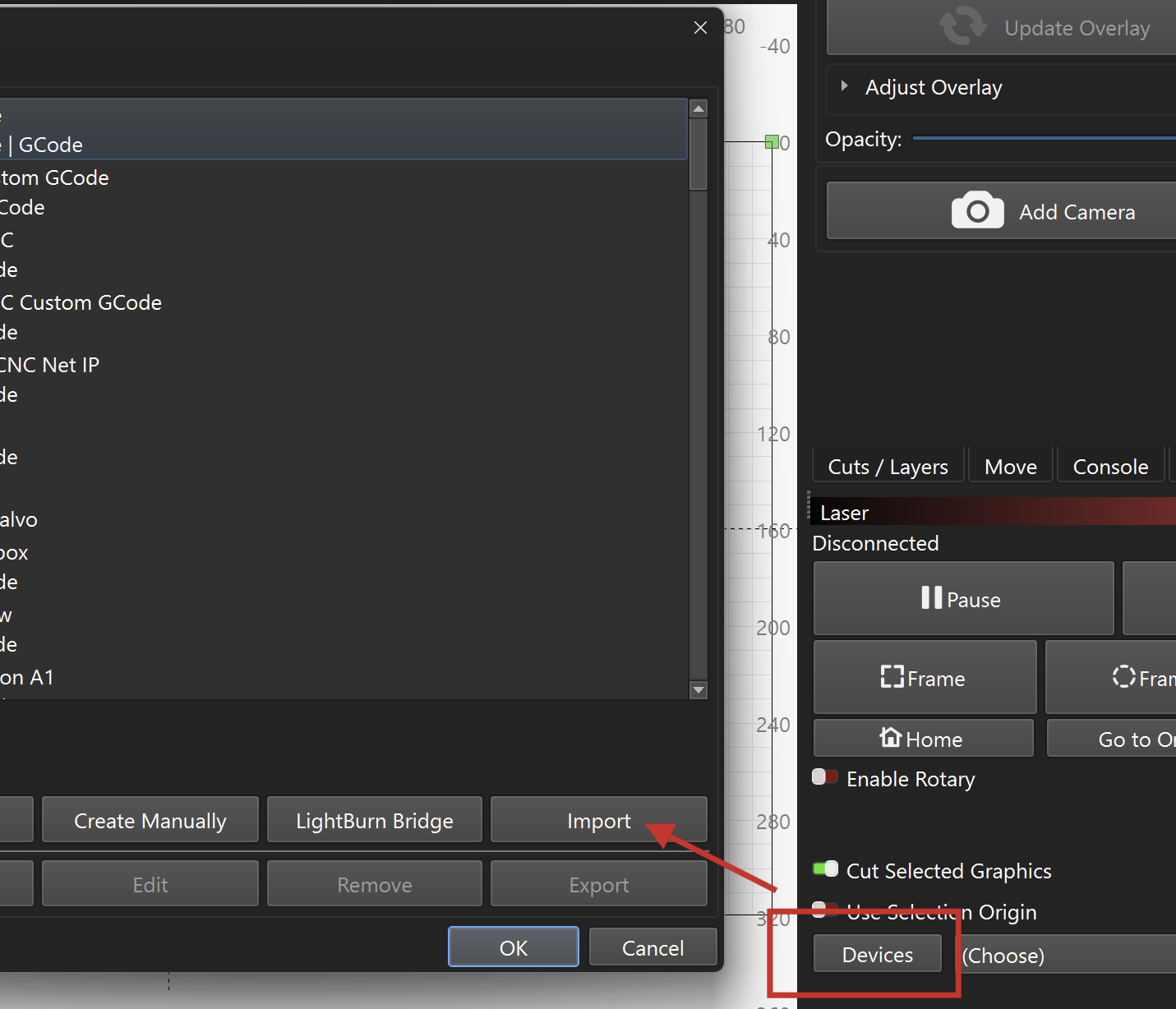

Sorry, I said “Import” the file. The S1-40W.lbzip device profile can’t be imported the same way as you would an image.
To add this, you need to drag the file from the Downloads folder in Finder into the workarea in LightBurn, and select “Import”.
Or click the Devices button and select “Import” here

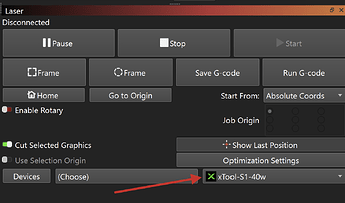

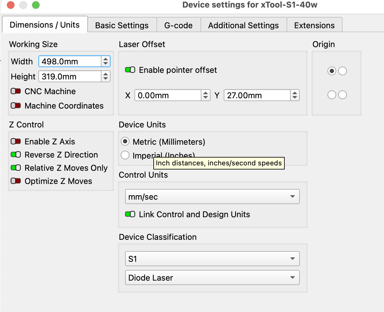

Can you send us the screenshot of your current settings, and re-run the same with the device profile I sent?
Change to this device by selecting it here:
I’m curious to see if it behaves differently.

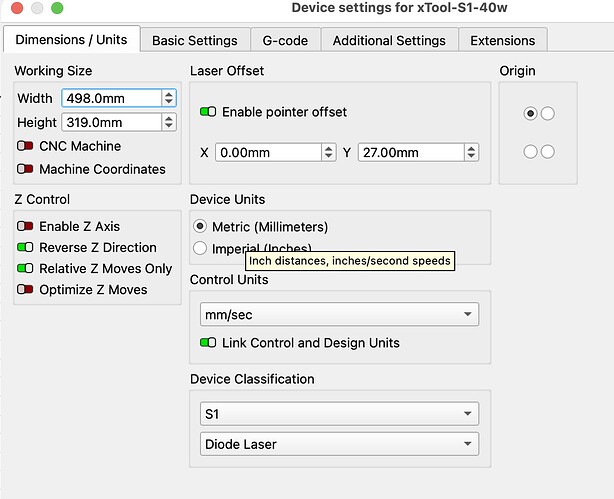

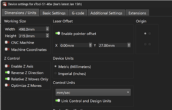

Settings, the original 10w

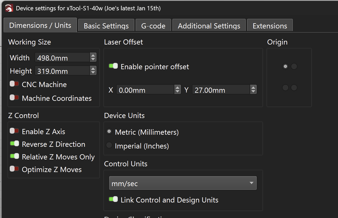

The new 40w file
(Slight difference in pointer offset)
Also difference in “Enable Z axis” setting

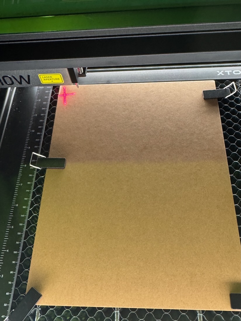

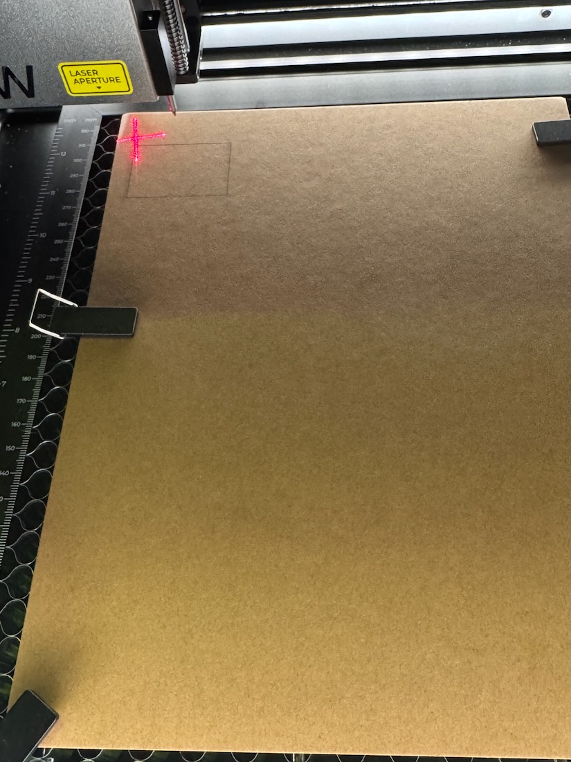

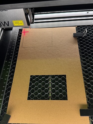

Laser’s home position:

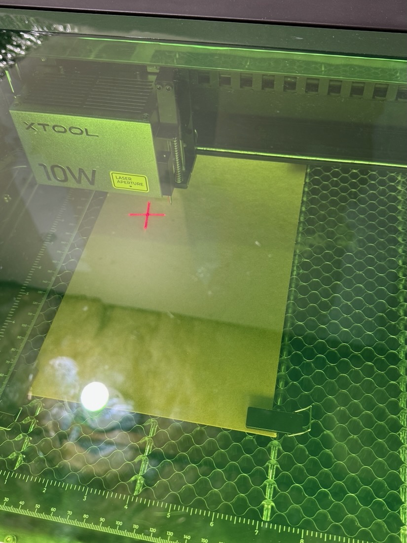

Laser’s frame position, returns to where I moved the head: (Start From set to Current Position)

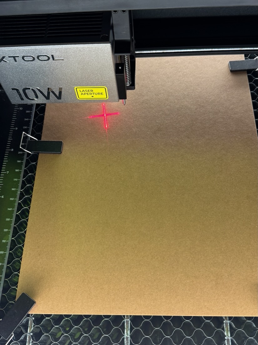

Where the item was burned, laser moved to Home position rather than staying where I put it:
Bottom line no change. Run cuts in a different location than Frame moves the head. Frame’s positioning works as expected.

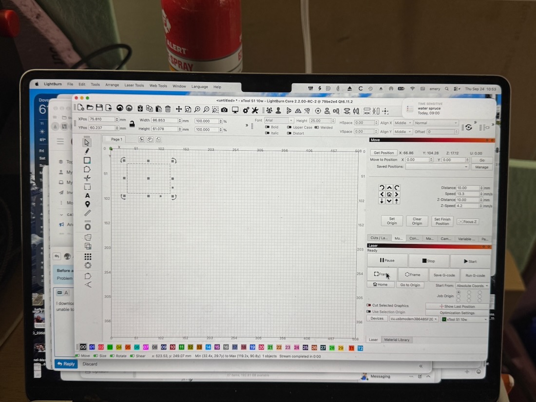

I set everything up, turned the laser on, selected it, etc. In Console, I enabled “show all”. Then I drew a little box. I positioned the laser head in the middle of the material
  1. I pressed “Focus Z”
  2. I pressed “Frame” Frame did as expected, ‘drew’ the box at the location where the laser was located.
  3. I then pressed “Run” Run moved the head to the home position, and then cut the box.
