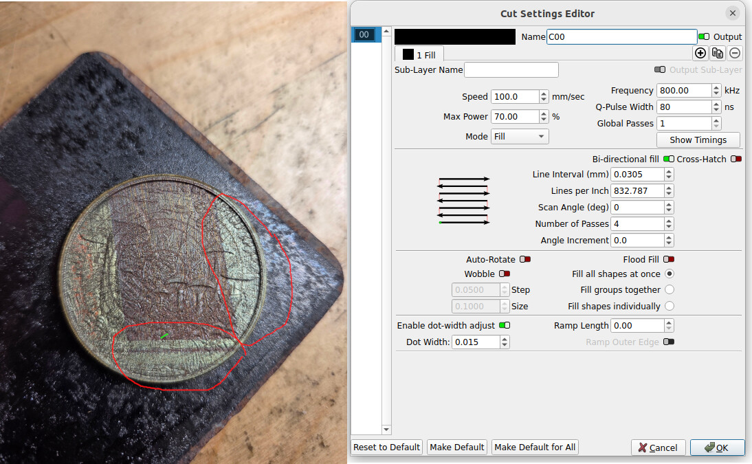

It would help if you could post something you’ve done, so we can look at it.
Which lens is on your machine? If I’m not mistaken, I usually run 1/2 the dot width of my lens. This also applies to interval values.
In my experience, you have to get settings related to the material. I think it has a lot to do with the metals hardness and it’s ability to conduct heat. Brass is about 110 on this scale.
When I do cleanup passes, I usually raise the frequency and lower the power. I have a MOPA, but with some practice, you should be able to produce similar results.
I always try it without a clean up pass, before I resort to that.
This is a pretty nasty brass coin from Amazon that I use about anything I can think of. It was pretty abused. The areas circled use these settings.
As I stated, this is my MOPA, you’ll have to figure out how to handle these changes with a Q-switched fiber. The short piece marked green was 100mm/s, the others were 80mm/s. Boy does this thing get hot.
Have any questions, sing out.
