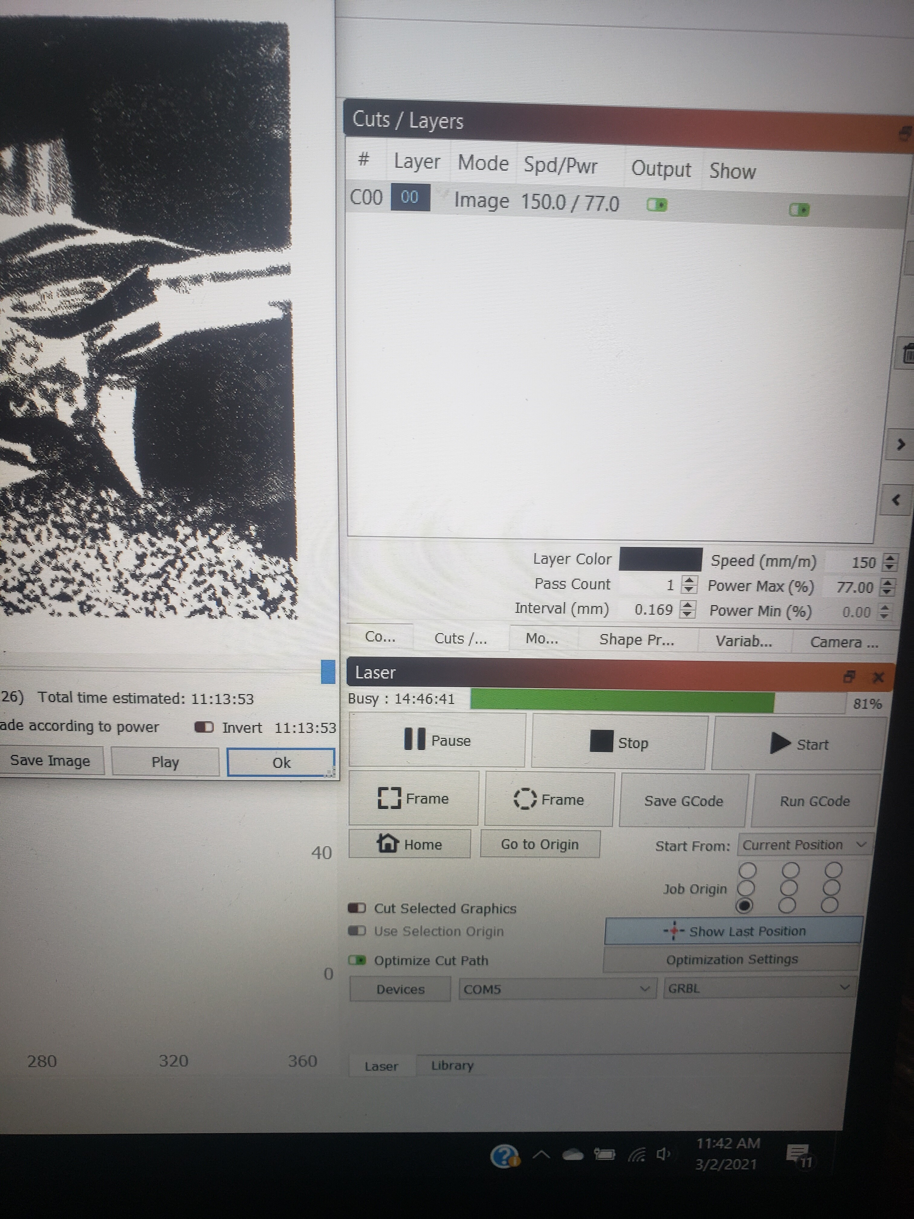

Hello all. In need of some help. i have a 2.5W bachin diode. having problems burning. i read forms on here. tried ways explained in them. but still not sure what im doing wrong or the machine itself, most likely its me. if i run it at 50mm/min 100% power. i get a burn but its a 7+ hour job for a 4.25x4.75inch birch wood. if i lower the power to anything below 70% i dont get nothing at all. unless i use the baking soda water trick. im not sure if its because its only a 2500mw laser or settings arent matching up right. if i turn 32=0. everything comes out perfect, but i dont want to wait 24+ hours for a job to get done.

If you could also drop a picture of the ‘cuts/layers’.
It could be it’s a hi def picture, could try dropping the ‘dpi’.
Hard to say without seeing the settings, if you’re using grayscale, dither etc.
Someone i’m sure shall be along soon to help out…
Ok thanks kris. I’ll up load them asap.
First one is laser on, second one is laser off. DPI set at 200Dpi i do believe.
This one was ran a little bit ago. Took 5 hours. Only 4.25x2.75in. Power 72.50. Speed 150.
Started low on power and kept bumping up and bumping down speed until I saw a burn mark and let it ran to see what came out of it
@LightBurn
150 mm/min is very slow. What do you mean in the one post, “first one is laser on, second is laser off” - The second one looks much more like what I’d expect to see for your power and speed setting.
32=1 for the first 32=0 for the second.
The only thing I can think of then is that Bachin has messed up GRBL, because there is no way that the speeds you are running are a problem, and your firmware is set to allow up to 6000 mm/min. Try changing $30 and S-Value max in the device settings to 255 instead of 1000, and see if that works. If the Bachin version of GRBL has a bug, that might be it.

@LightBurn, ok my project test run just finished up. 17 hours 27 mins later. but i went into settings in LB changed baud to115200. jacked up the speed to 300. its burning now. with the settings above, whats the max speed i can do without the machine cutting power in half?
It depends on the image content honestly - 8-bit GRBL can only process about 200 GCode instructions per second, so at 254 DPI, that’s a maximum of 10 instructions per mm, but usually a little less, so 20mm/sec (1200 mm/min) would be the approximate max at 254 DPI. It’ll go up as your DPI reduces, and if the picture doesn’t have much perfect 50% gray in it, you’ll be safe at 1500 mm/min.
