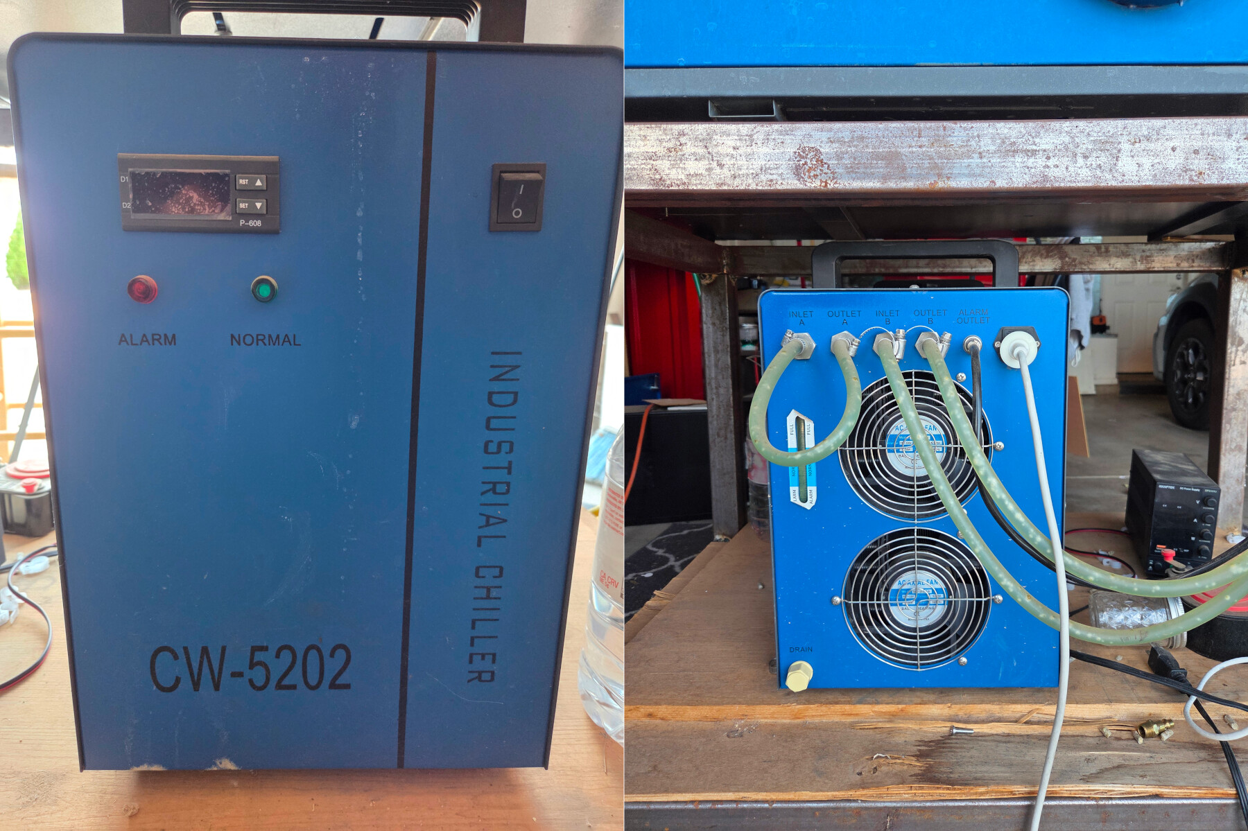

Hello..
I now have 2 80 watt co2 and 1 cw5200..
1.. Your thoughts on running 2 machines of 1 chiller ?
2…Best way of connection ?
Thanks in advance Kevin

You can theoretically run your 2 lasers in series with your CW5200, but it depends a lot on what kind of production you have in mind. Whether one cooler can keep the temperature down to about 20 degrees C over the length will have to be tested.
You can set the temperature up to 25 degrees C and “unload” the cooling machine a little… but I don’t want to jeopardize my production of 2 laser machines with only one cooling machine. For short periods or as an emergency solution - ok.
You can purchase chillers that have two outputs - inside the chiller it’s simply a tee going to each machine, so I would presume that doing the same outside the unit is fine.
The 5202 chillers have an extra pair of bibs on the back for two machines. Inside they are just series connected, out of the chiller, goes in one, out, then in the next one and back to the chiller.
If it will remove enough heat, I’d just run it from one to the next, using the shortest distance.
Inside, Outlet A is just a short tube jumper to Inlet B

Assuming some Reci 80 W tube specs are similar to what’s in the machines, each tube dissipates about:
380 W = 19 kV × 20 mA
That would be 20% efficiency and, frankly, I don’t believe that for 1.0 New York Minute.
Assuming a random CW-5200 manual has anything to do with the chiller, then it claims “1.39 kW” cooling capacity.
In round numbers, 800 W is less than 1400 W, so it ought to have enough capacity.
On the other paw, the LightObject “600 W” chiller next to my 60 W laser flat-out cannot keep up with the tube during prolonged cutting. The temperature doesn’t rise dramatically, but the chiller can’t hold the temperature within the deadband around 20 °C.
If you’re in production, IMO you need a chiller for each machine, because otherwise you’re out of business when the shared chiller fails.

Beter have separate CW5200.
My laser can do some work for 8h without problem. Cuting 3mm plywood.
Then some more intense project with 3mm ply can triger overheat alarm.
Good with this information, can you also write what temperature you have set/get an alarm at, thank you.
I have, when cutting 3mm plywood fairly intensively, after a few hours about 3-4 min. pause interval of my cooling machine, which can go down to 2 min. in the summer, if the room temperature gets above 25 degrees Celsius, (very rare). My min/max set temperature on the CW 5000 is 18-20 Degrees Celsius.
