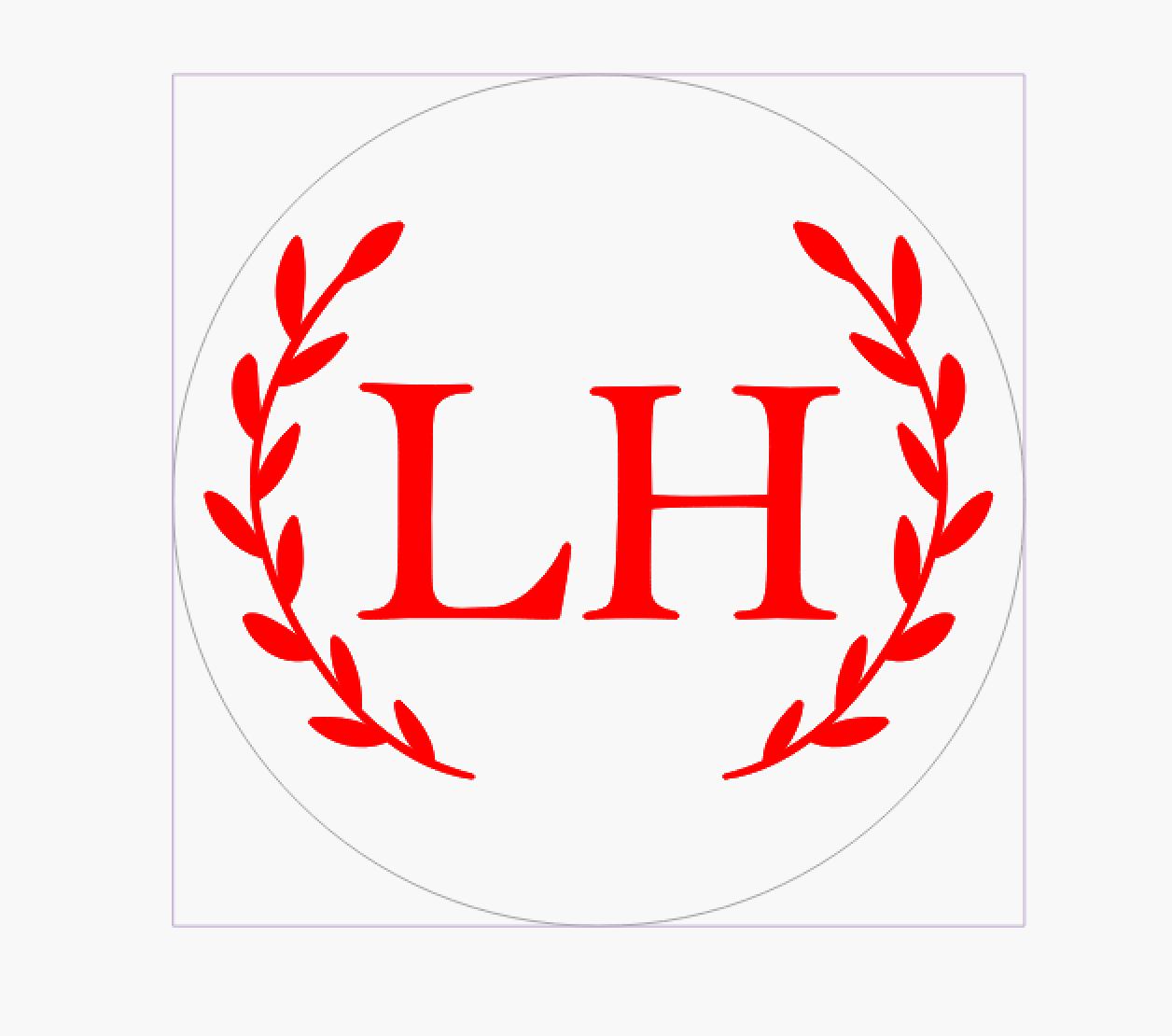

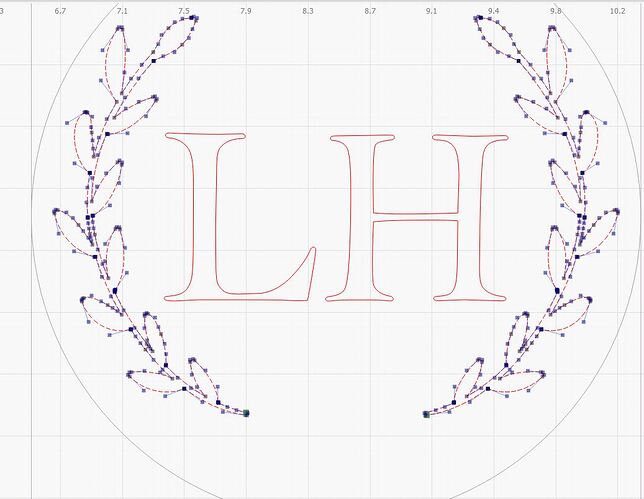

(2) Shapes were set to fill, but weren’t closed
Ok, so I know it’s been discussed by others, but this is baffling to me because my shapes ARE closed. I used the edit nodeds to highlight all the nodes, followed around the shape looking at everything and there are no breaks or gaps so i honestly don’t know why it keeps telling me this?
Can you upload the .lbrn file for review?
LHWreath.lbrn2 (51.2 KB)
if you somehow find breaks, please explain to me how to find them better. Thanks

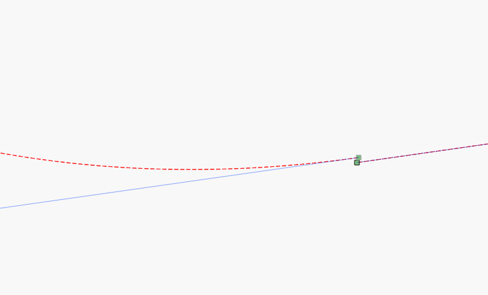

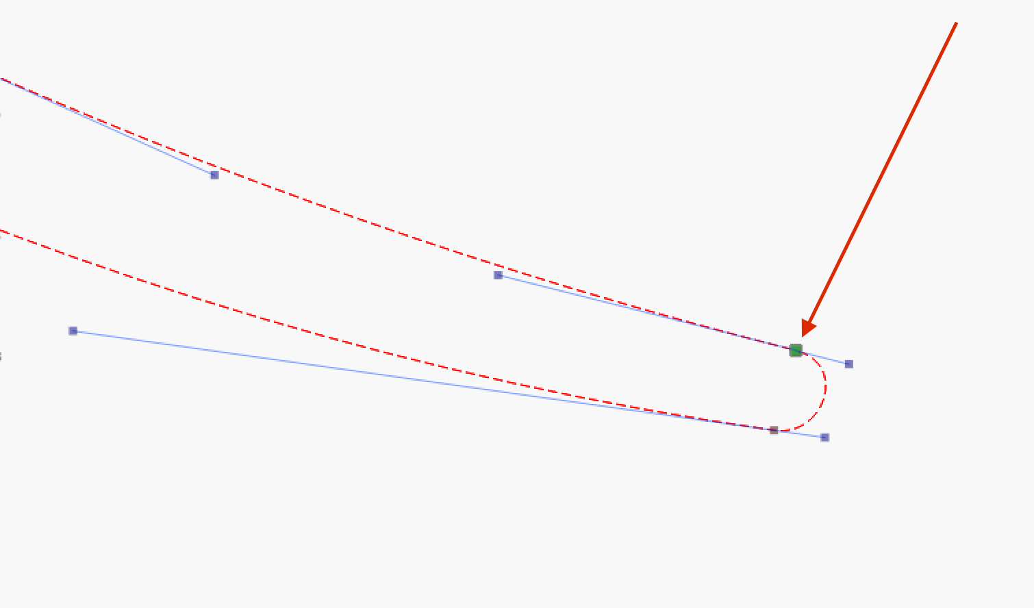

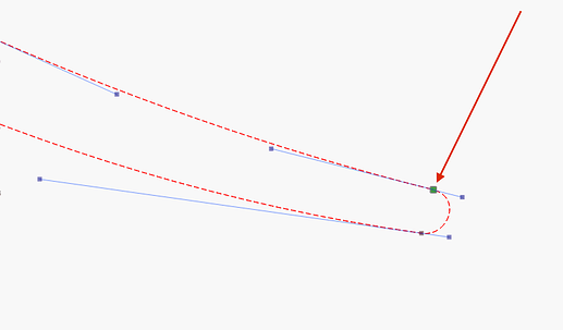

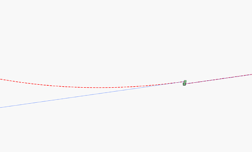

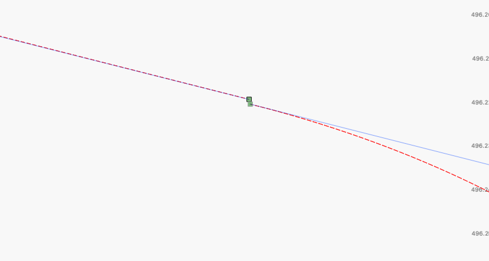

Both of your two parts are not closed, see picture, by the green marks. The only way to find the errors is to use the zoom function and a little experience. It’s not meant to be sarcastic, but my experience.
Wow! I mean you found that sucker! So, you can fill it in with color in lightburn after it’s closed? how did you do that?

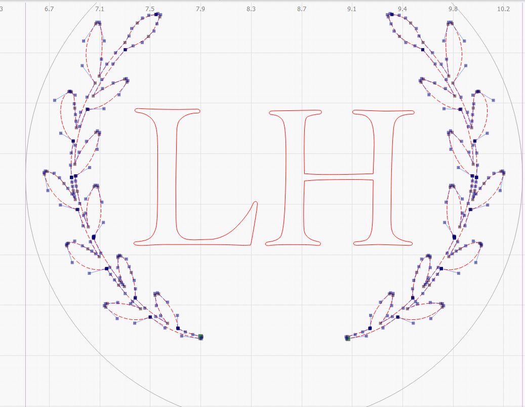

Here’s a tip. If you use the Shape Start Selector tool and click on the shape it will show you an arrow where the cut will start and a node where the cut will end. Breaks will, by definition, contain a start or end point so look for those. There should only be one start point in a closed shape.
can you direct me to that tool if you don’t mind?
Highlighted below:
Thank you so much
