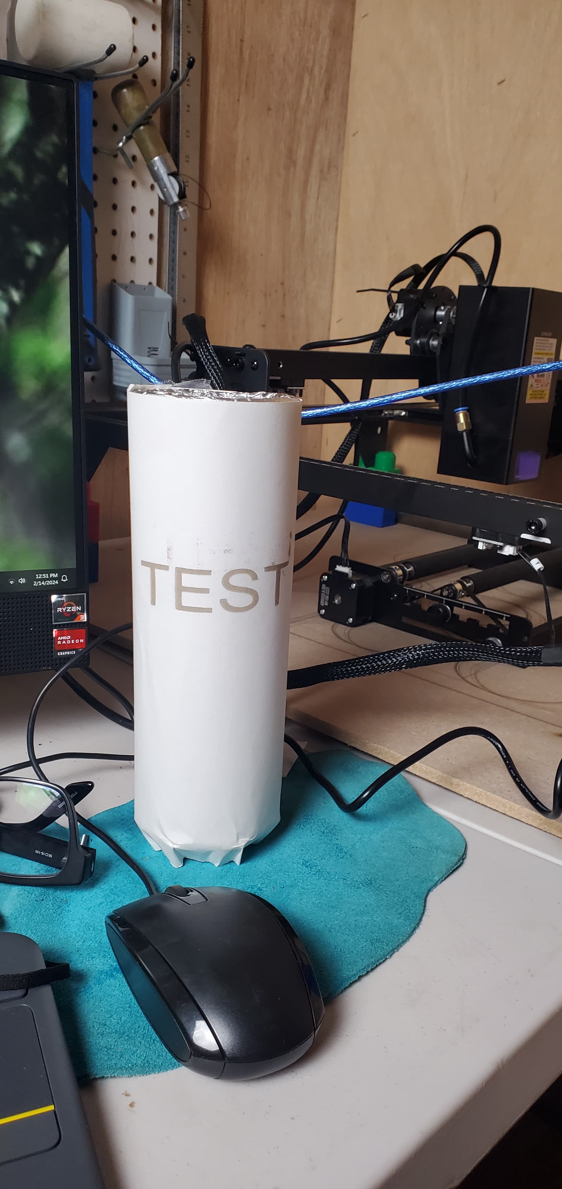

Hi guys, total laser noob here, just 2 weeks ago my wife got me a ray5 20w laser, I just started fiddling with it this past weekend, everything looked fine until I connected the rotary tool to it, and the thing would not work for me the, X axis would take off and ram into the right side of the frame, belive it or not that is not fixed yet, I gave up, so I went ahead and unplugged it from the Y axis and I thought to myself imma just do a few flat jobs instead, to my surprise I started ok in lightburn decided to mark my table surface with 9 circles to use it as a template for some coasters I was going to work on, to my surprise the Y axis stopped at 280mm mark and the job got stuck there, and everything i did always stopped there,I scrapped that project and decided to run a line as border for my entire work area to verify that the machine was (what i think) misreading the job parameters sent to it from lightburn, so next the machine ran the job no issues except that instead of 400x400mm I got 280mm Y axis by 400mm X axis,

Do you get any console output at that position? Most likely, the workspace size is not set correctly in parameters $130 and $131.
Hi there, the console just showed that the burn was finished just fine, but the size was way smaller,
I think the issue is $101 that got changed to 56 when I was in the process of connecting the rotary roller, as the instructions called for that change, I’ll work on that tomorrow asap, and i will check $130 $131 as well,

Yes, that’s the cause, then. You need to set $101 forth and back while changing from rotary to normal and back.
I recommend not changing $101 but using the LightBurn wizard. It makes things much easier. I have some explanations on setup here: Rotary roller - Diode Laser Wiki

I manually turned off homing, and reduced the Y axis travel steps to 56 in the rotary wizard in lightburn,not in the firmware, I used current position from the start, so everything seemed to be calibrated properly, so I went ahead and brought in a project to test the roller, I tested the roller in the lightburn wizard and it tested just fine, next I tried framing it from laser window and gave me ALARM 2

This is because your y-axis is endless now. Soft Limits do not apply for that axis as long as the rotary is connected. Set $20=0 during that time.

I just ran a test and it worked like a champ,
I added the $20=0 to the macro button I had designated for " rotary on" as your article explains and it ran beautifully,

I’m attaching a pic of the only test I conducted after applying your last advice,
