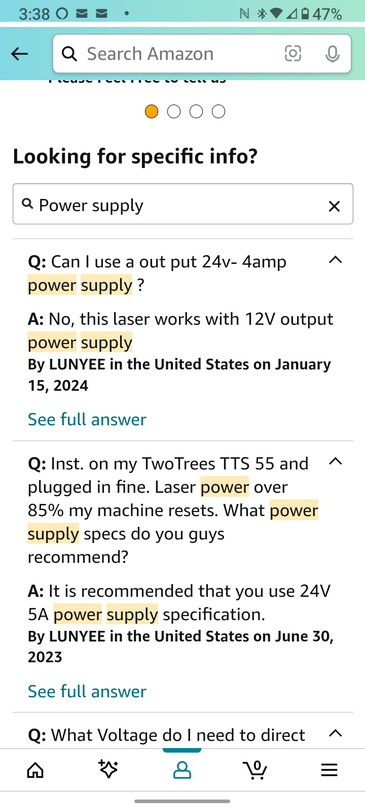

I have a comgrow z1 that came with a 24v mother board and a 5.5w laser I am trying to upgrade to a 10w laser but the one I got ending up requiring a 12v power supply. Please be kind I have never upgraded anything before that’s why I am asking for all you wonderful people for advice and suggestions. Thanks

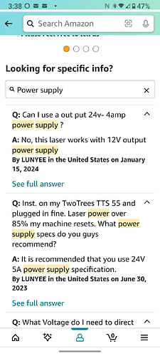

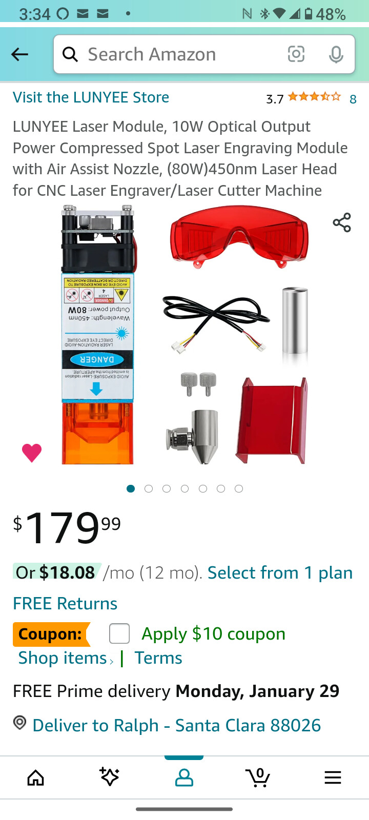

It’s a lunlee 80w 10w laser I got it off Amazon the company is who told me the power requirements because they shipped the laser with no information. At first I asked if compatible with no modifications they said yes then it was buried like my 5.5 w laser so I went back and just asked for the power supply needed that’s when they told me. 12v 5amp.

So nothing makes any sense with this company
I read through the entire product description. There’s nothing there that definitely specifies the required input power. All signs suggest a 12V unit but nothing definitive.
I’d suggest returning and moving on to a more reputable vendor.
I would second this suggestion
I mean how much would it cost to put the input voltage on the label?
Exactly thank you all for being kind and helping me I think it time to return this and do as you suggested any recommendations on a 10w laser.
