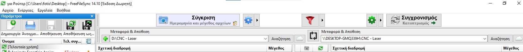

I use this many years for synchronization it is free https://freefilesync.org/
Nice! That fulfills my statement to not use off-local for running Lightburn.
Maybe I didn’t understand the translation. I mean computer synchronization.
That is what I understood.
