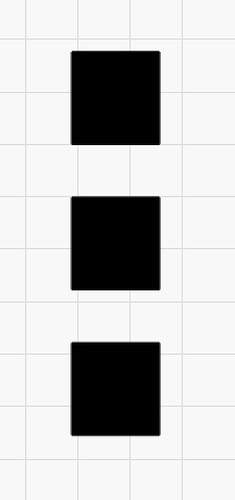

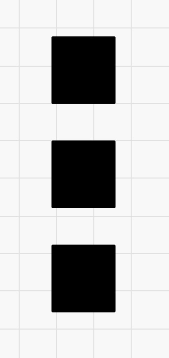

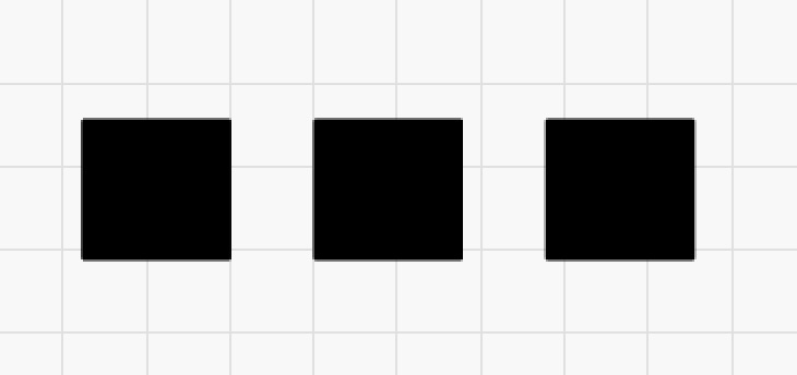

Perhaps I misunderstand, but… If you have three shapes or images that are positioned horizontally and you choose 90º (vertical) it has to burn them one at a time.
If you position them like this and chose 90º, it will burn them all at once (vertically).

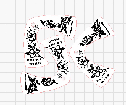

I hope you can see the image I loaded. There are three sub-images in one LIGHTBURN file which is then loaded into Lightburn. When we set the scan to 0, the default, the scan is left-to-right, bottom-to-top, which is the default. But if we set the scan to be either vertical or diagonal, the scan takes place sub-image by sub-image…first one, then another, and finally the third…as if we had set the “Fill shapes individually” flag.

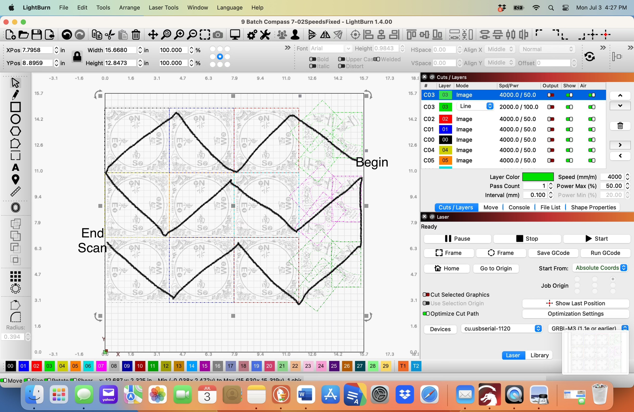

So…that’s how we ended up stumbling onto the issue that I posited on the Forum. The scan pattern that we finalized, on our 12-part production run is shown in the following diagram. The nine images in the matrix on the left are single images, each of which will engrave on a 4x4 blank. Each of three groupings on the right is made up of three separate images, also burning onto 4x4 blanks.
