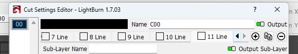

Use the SUB-LAYERS function

Each color layer has an option to add 10 additional sublayers.
Aren’t 300 layers enough for you to work with??

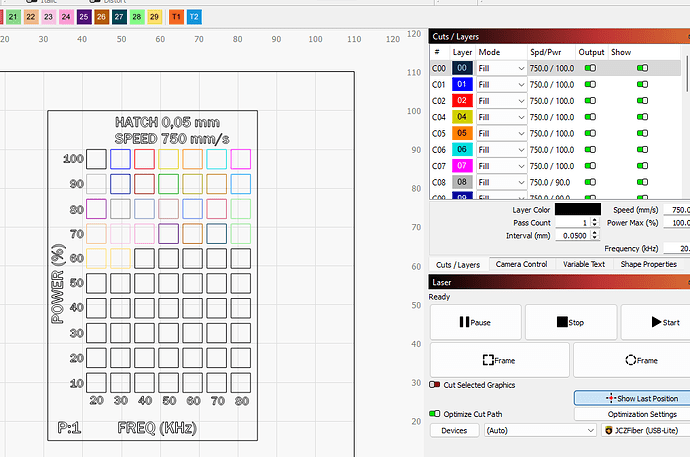

I assigned parameters to the first 29 squares. How can I assign something to the rest of them …is the C29 is the last one.
i want to select my entity (next small square) and assign the parameters that i want.
Sublayers? I am new at this and I can barely understand the Layers. And I thought select - assign - next would be enough. Until I runed out of Layers.

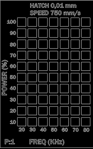

I have 70 squares. The design is made outside LightBurn and saved as .dxf and imported.

I select the first square (Power 100% and Frequency 20) and change the parameters that i want inside C00 (hatch, angle, number of passes etc).
Then I select the second square - from left to right (Power 100% and Frequency 30) and change parameters.
Then: Power 100% and Frequency 40 and so on.
Soon enough the 30 different colors are …gone. Now what?
I want to do it like this because the Material test Menu is not offering any setting for spacing of the squares …they are too close together.
Is there any way to assign what I want to my 70 squares?

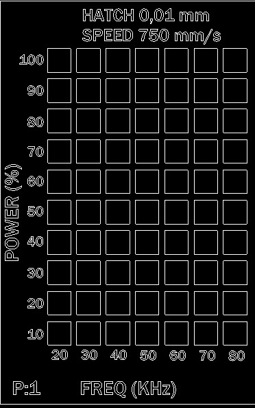

Have a look at the Power Scale parameter in the Shape properties window.
In your example each column should be on one layer, with the Power scale option set to a different value per line (10, 20, 30, etc).
In your example you really only need 7 layers for the boxes plus one for the text around.
