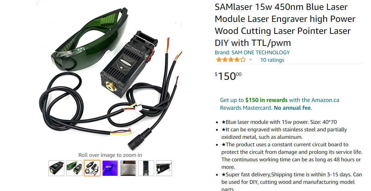

I am considering Upgrading the 3 watt module
With (from Amazon)
Do I need anything else or is it Basically plug n play?
I Really hate returning things.

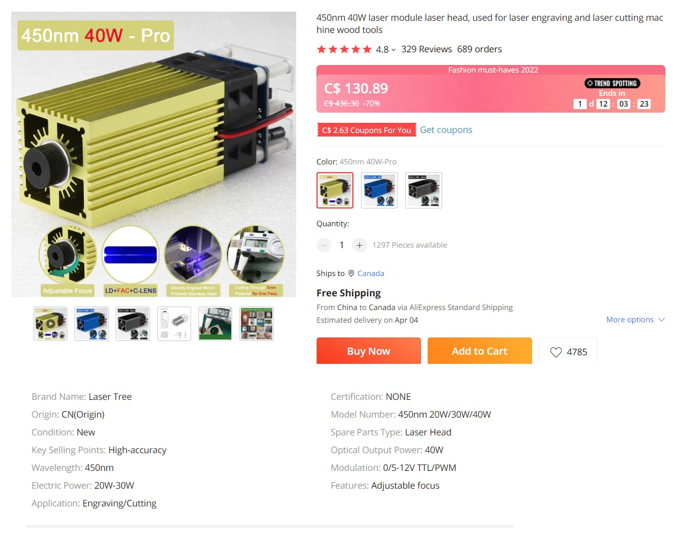

Any comments on AliExpress modules such as
It says * Optical Output Power: 40W, but I don’t think I’ll hold my breath!!!
It might be a Little OverKill but I would find a use for the Extra power. lol
Most 30 to 40 watt show 5 to 7 watt Optical output.

Right across it says ‘Electric power 20 to 30 watts’, so it’s output is greater than it’s input… It does say it draws 2.5 A at 12V or 30 watts input power.

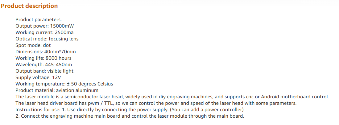

Am I misunderstanding something?
So this makes me think it isn’t really 40 watts output.
With this it makes me think it is!
According to the site, it only 30 watts in, so that’s probably an excellent deduction.
