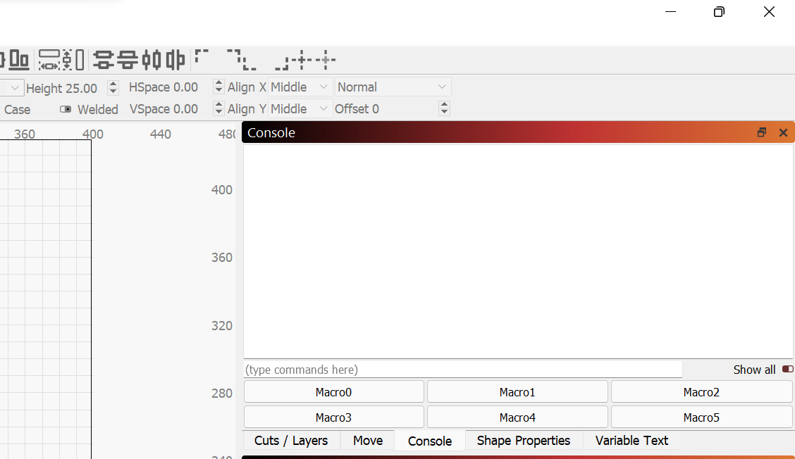

Please take these steps:
  1. save the file in LightBurn of the square you tested the burn on cardboard. Attach that file to a message. This will help indicate if there’s something wrong from a design perspective
  2. Go to Edit->Device Settings and take a screenshot of that whole screen.
  3. Go to the Console tab on the right side of the UI and type these commands one at a time. Then copy the full output and paste into a reply here.
    3a) $I
    3b) $$

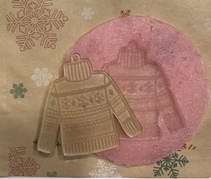

ahhh I must of missed that when I was purchasing it. I was hoping to engraver/cut items to be used for silicone molds, possibly other items later down the road but solely wanted to make items for molds.
Can you explain the process for this? Is this a multi-step process or you were hoping to engrave/cut into the silicone directly?
No you cut an item out of materials and then mold the blanks with the silicone to create an item for resin art.
Is this what you were planning with the acrylic or would you use a different material?
What would be the thickness of the material that you would need to cut?
And any idea the level of depth you would need for the engraving detail portion?
yes I was hoping to cut the acrylic shape out but also be able to engrave for more detailed pieces. I am attaching a photo of a blank i purchased from someone and used it as my master to make my silicone mold. depth isn’t as important but it must have a gloss finish, can’t use wood because of the texture of the material.
Screen Shot 2021-12-16 at 11.40.56 AM
Okay. There’s a good bit of detail in the engraving. As discussed earlier you won’t be able to do this with clear acrylic using a diode laser. Stronger diode lasers (>5W output) probably could do this with black acrylic but your unit would struggle with this. You might be able to get an engraving but the cut is unlikely. One option could be to upgrade the laser module if black acrylic is an option.
If wood is not an option are there other opaque materials that could be used as a substitute?
If the sample in the photo you sent was created with a laser it was likely a CO2 laser that was used. Entry level models can be had for less than $1K but may need an upgraded control board to be used with Lightburn. Higher end models have really no upper bound in terms of cost.
The color of the acrylic doesn’t matter really, but being able to cut and engrave are a must. What would I be looking for or where to upgrade the laser module? Im not sure of another substitute for acrylic ill have to do some research on that.
You might want to connect with the seller to see if they’d upgrade your laser module for a reasonable price or offer a replacement. From their site it looks like they offer a 15000 mw (15W input → about 4W output) that might do the job but I’m not familiar with this company’s products.
Alternatively, you could buy a replacement laser module from a 3rd company but you’d have to handle the mounting and connection yourself. I’ve not dealt with these companies but JTech and NEJE are often referenced for replacements. I’ve heard good things about JTech support and the opposite about NEJE.
Keep in mind that even with the upgrade acrylic cutting won’t be ideal as it could take multiple passes and long times. I’d suggest you consider the CO2 route if you have the facility for it. But keeping in mind that the learning curve will be higher and there are more things to fuss with like water cooling.
