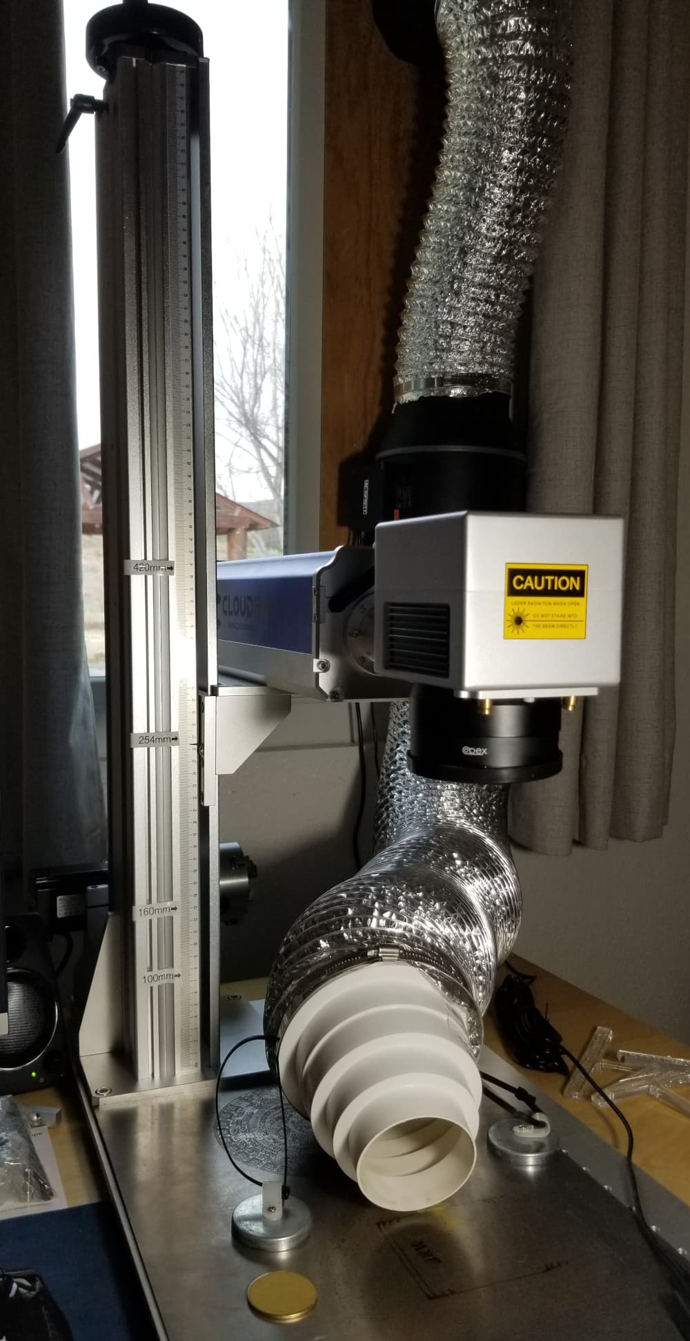

I have a 30 Galve Scanner Fiber Laser I bought from the Chinese. It is very limited. I would like to buy a 300mm lens. My question is…the threads…will the threads be the same as the threads on my 110mm lens?
Hi
As fas as I can tell all the galvo lenses are standard. So it should fit.
You’ll have to post a link to your machine, but generally these use the same thread for the same type lens.
I bought mine with an F420mm (300x300mm coverage), this ensured the column was tall enough.
The head on mine with the F420mm is in focus at the table when set to about 440mm.
This is with an F254mm, there is a marker on the column. If you look above that there is another marker, it’s for the F420mm lens. Not exact but it gets you in the ball park.
Thank you, GDK40)[Ger] I appreciate your response
I found this lens…Cloudray F-Theta Lens Fiber Laser Lens Scan Lens 300x300mm FL420mm FL380mm M85 F Theta Fiber Laser Lens for 1064nm Fiber Laser Machine Scanning. I think I’ll try it.
If your machine is over 100W you need specific lenses for the higher power.
