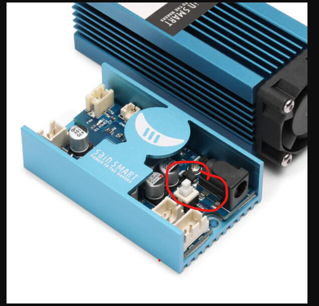

The pwm control came with the laser. Link to laser is here photo below.

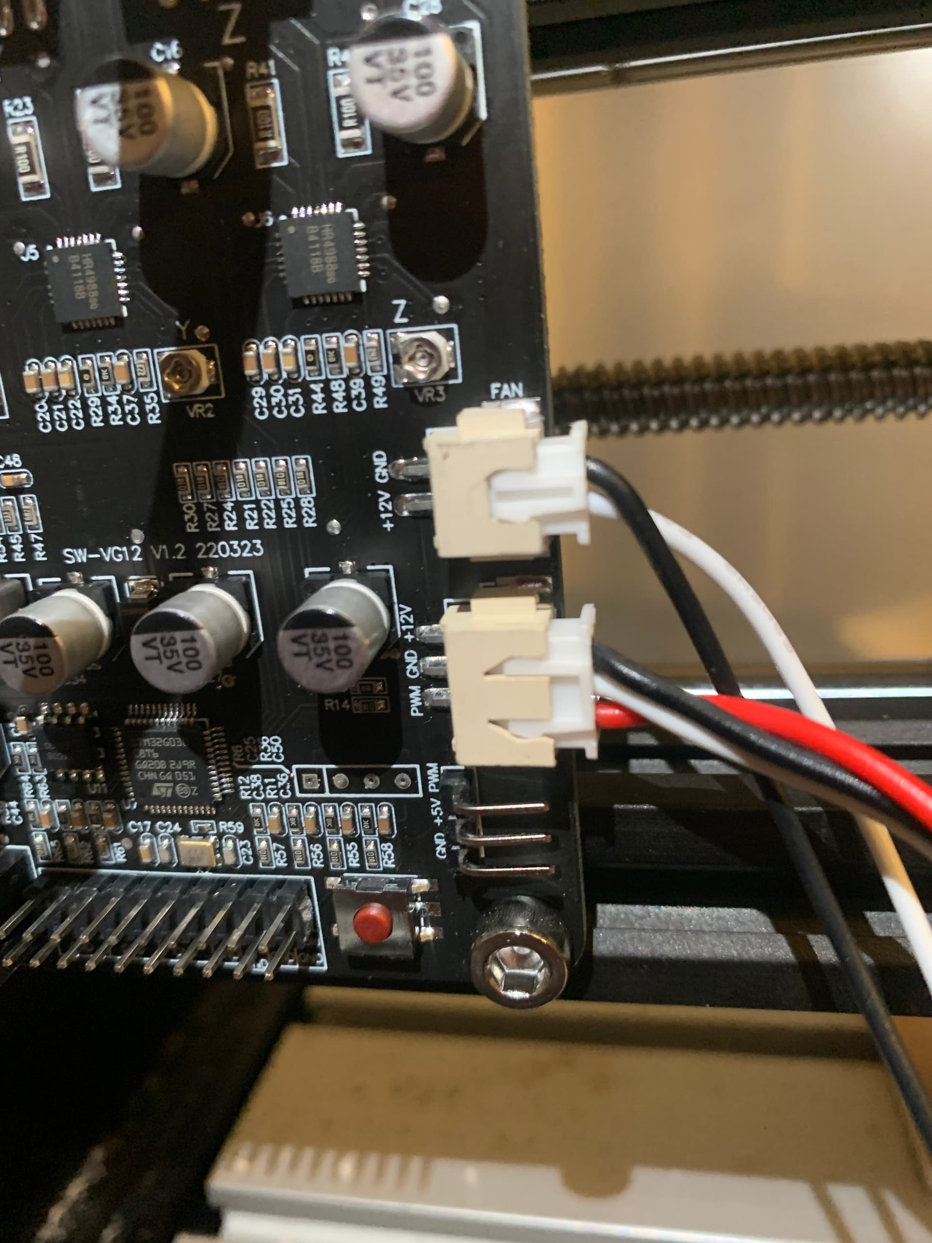

The control board is a GRBL board, the link to the 3018 machine I purchased is here. The images show multiple boards but the board i got is pictured below.
The “Fire button” is on the laser power board and can be pictured in the photo below

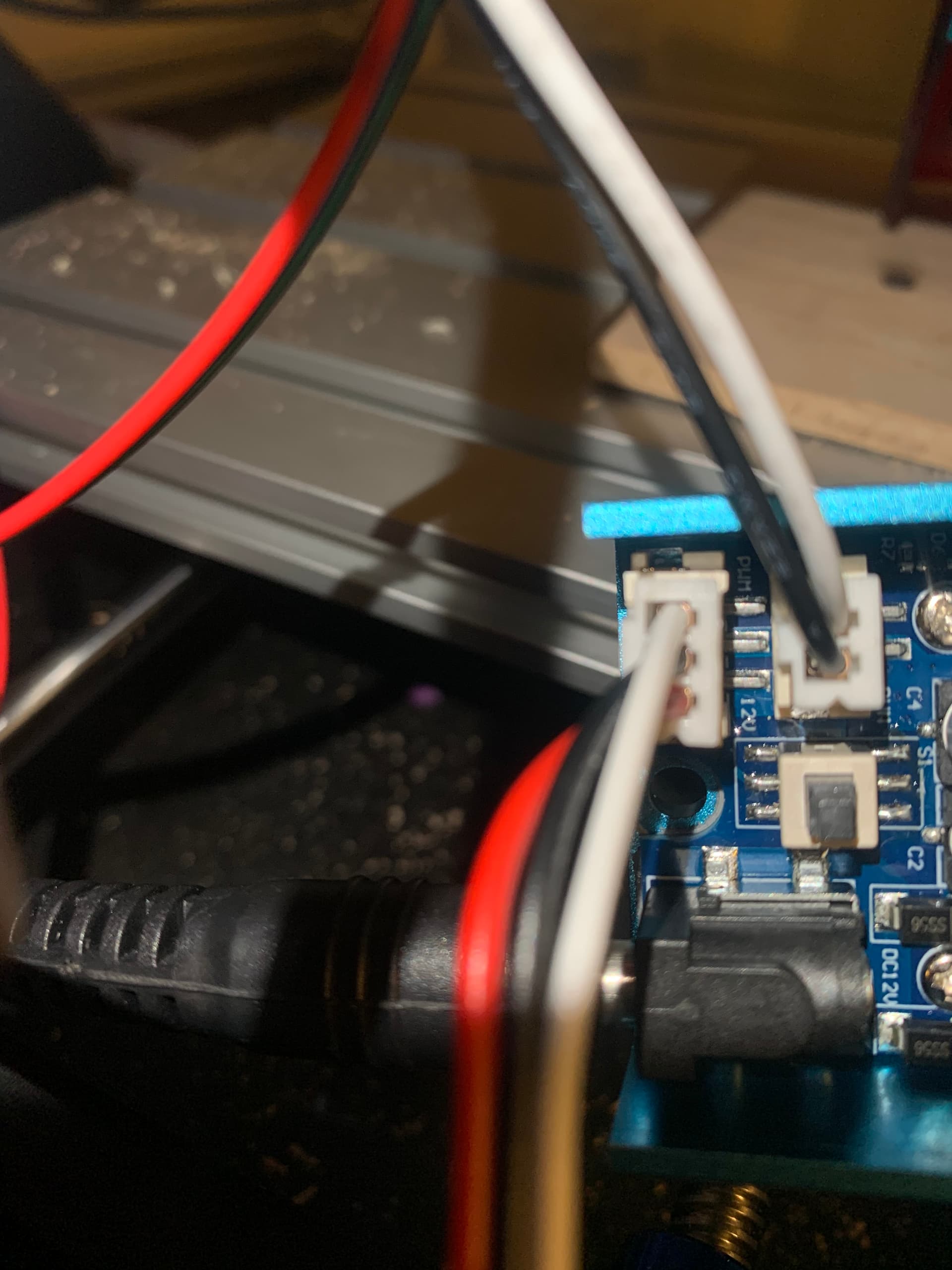

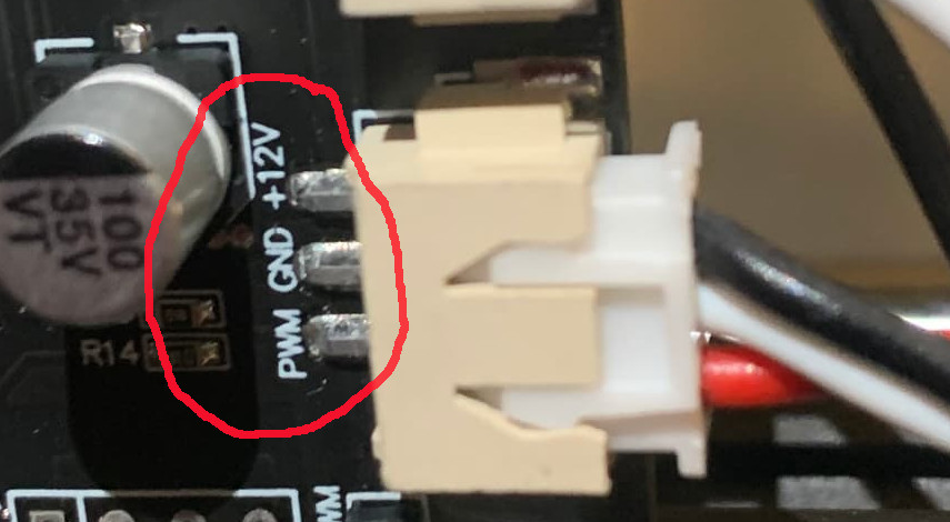

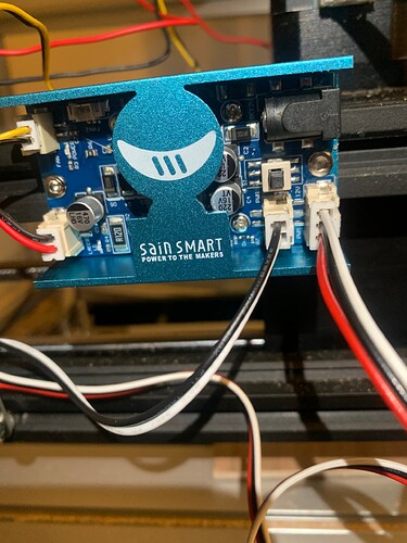

Alright, so I got the Voltmeter and I think i’m more confused then when i started. I can not get a reading off of the GBRL board. I have the fire button on Lightburn on, reading from 12v to ground, nothing. I decided to try the other three pin connecter that came with the laser and it shorts the power board for the laser. Below i have two pictures; the first is the three pin on the GRBL board, second the three pin on the power module. Notice how red is PMW on the GRBL board, and its 12v on the power board. I have another 3 pin that is a normal 3 pin, but when i plug that in it shorts the power module…

I think your photos have all the wiring information we need…
I know, from the controller photo, the black wire is 12V, white is ground and red is pwm from the
Looking closely at the ‘control’ module for the laser I can deduce that you have white (ground on controller), black (12V) is wired to ground and red (pwm) wired to 12V… This is an issue… :frowning:
Do you see what I’m seeing?
The PWM of the controller to PWM of the control board, GND of the controller board to, what has to be GND of the control board. You only need these two.
With your setup, you don’t need the 12V connection… only ground and pwm.
You can usually remove the pins and ‘rearrange’ them to the proper order or slot… Usually doesn’t look pretty but it’s entirely functional…

@jkwilborn I see exactly what you’re seeing, and think i understand what you’re saying. Let me ask you one more question. I have another three pin wire that has the correct wiring. I have connected it to the control board and the power board in the below pictures. This may be a dumb question, but instead of messing with the pins can i just cut the 12v to 12v wire since i don’t need it?
Currently if i turn on power to the control board and the power board (both connected to separate 12v power sources) the power board shorts out, but as soon as i unplug the three pin it powers back up.
