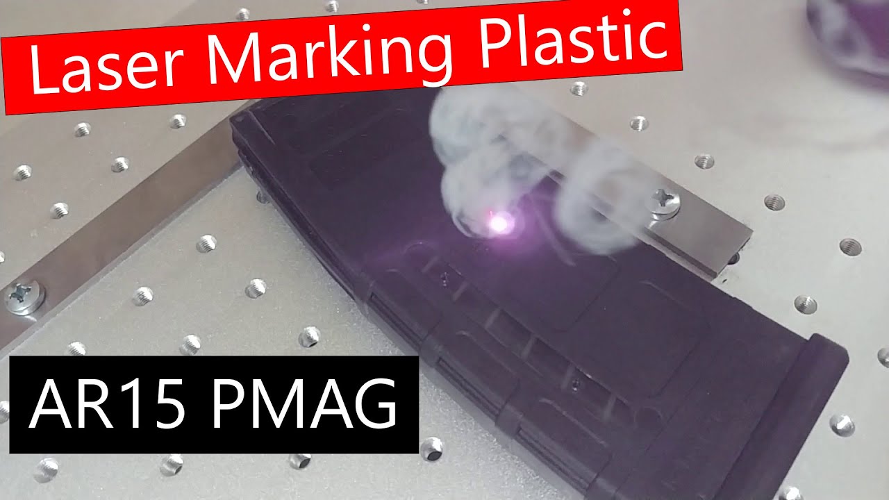

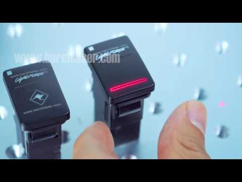

I have not tried plastics, but lots of people mark firearm parts such as magazines or stocks that are plastic. Here’s a few videos I’ve seen.

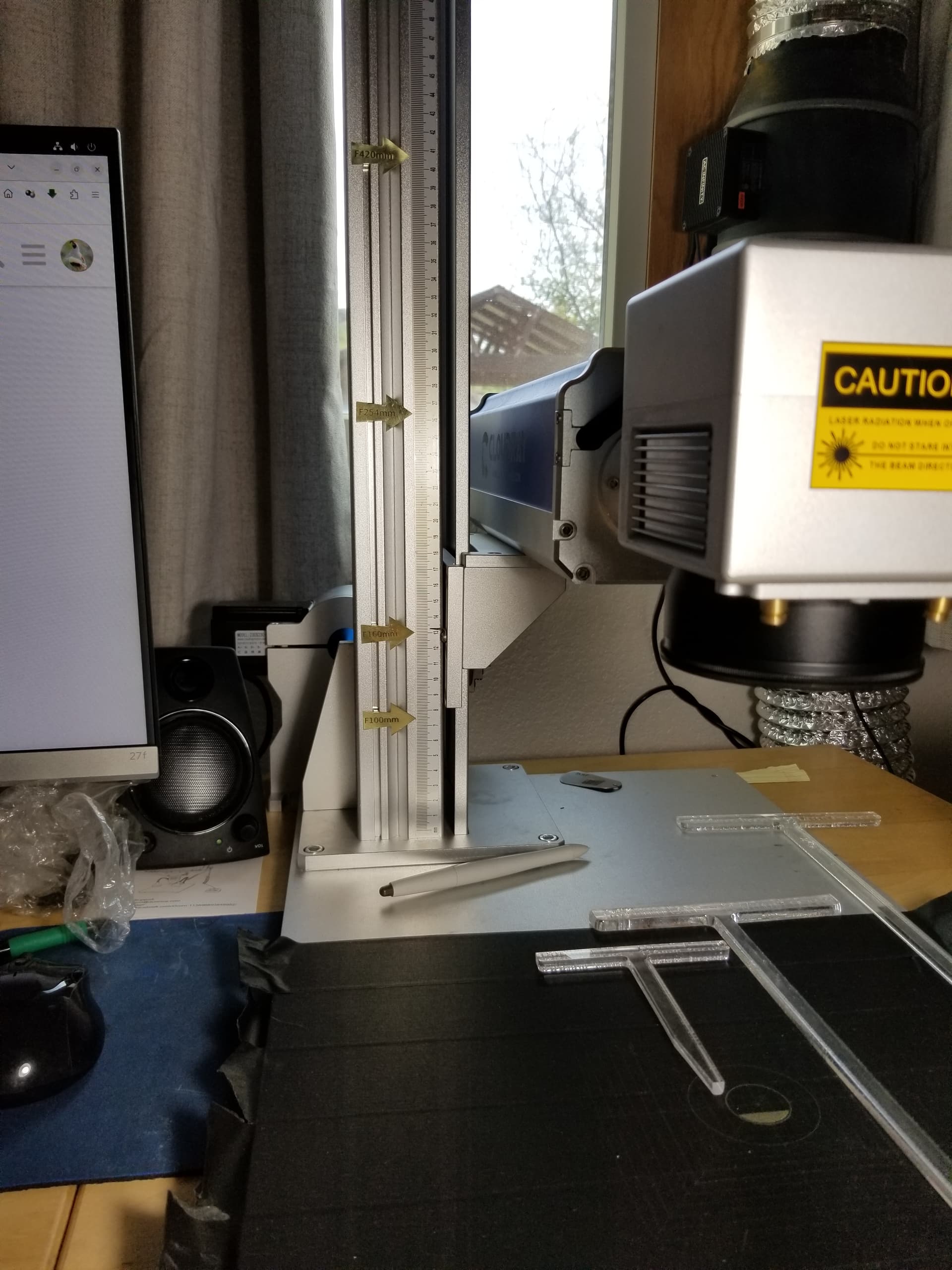

I have this machine from Cloud Ray, 60W JPT MOPA M7 that I really like… I ordered it with an F420mm lens for 300x300mm coverage.
I’ve not seen anything that does larger areas, but conceptually there is no reason you can’t put a longer lens on it… I’m sure we don’t see these around over 300x300mm for some reason.
I got the long lens as the column needs to be rather long to allow things such as rotaries or other items you might want to lase… My column is 800mm (80cm) in height… You can see the lens markings on the column. I will suggest you keep it under 100W… once you get to 100W the lens prices go up by about 8 times.

Depending on the material, most of these put out a fair amount of smoke… You can see it with the PMAG video.
