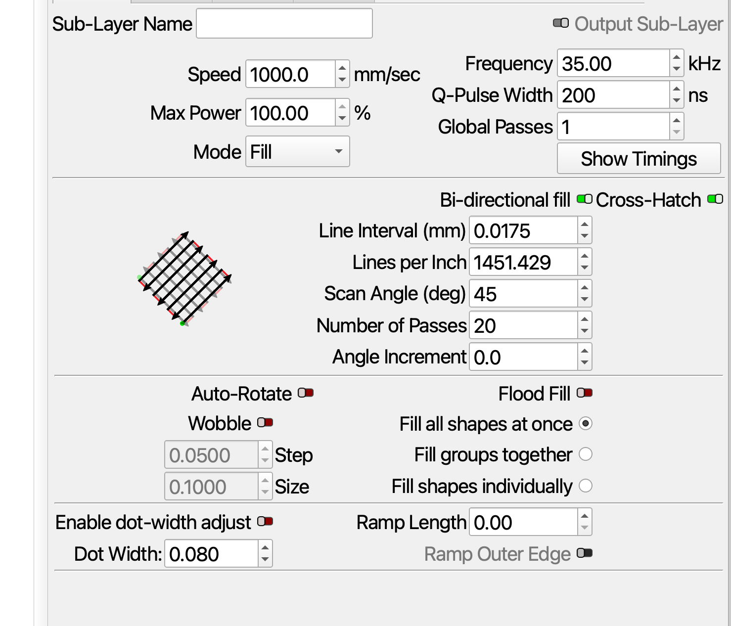

New to everything about this process, but I like to think I’m not totally incompetent. My company recently brought on a Monport 60W Pro MOPA fiber laser. We are trying to engrave some fine detailed logos down .010"-.015". I’ve played with CO2 and fiber both previous, and I’m diving into the settings for the current parts, which we later paint fill (currently enamel, will be trying thicker if we can’t get good results).
Customer wants a better finish at the bottom. Their words were “no more orange peel texture”. We can wait a few days to get new test material, and certainly don’t want to scrap real finished parts, but I’m looking for a starting place that is a little bit better than what we have tried. Here is what we’ve been able to track this week, none of which have gotten a happy result.

I have that MP 60W fiber. What material are we working on?
Stainless, found it
I measure .13 on Stainless. It’s a start.
That is using the 254MM lens 175X175 area
Thanks for this. Will test either today or tomorrow!
Rick’s settings suggest going faster with more power. I consider that a great starting point.
When going faster, you likely also want to increase the Frequency. According to Monport, the GM60 Mopa Pro can go up to 4000 kHz(!)
I’d try 100kHZ first and watch the difference.
Think of the frequency value as sandpaper: a higher frequency means more pulses per second → finer-grit sandpaper
Another interesting value, you didn’t appear to have touched yet, is Q-Pulse.
This is the duration over which the energy of the laser is being released. In simple terms, this means: lower Q-Pulse = More energy.
A shorter, more intense burst of energy also means less time for the material to spread the heat - which could be helpful when trying to get a clean engrave.
I’d be curious to see your best result and a screenshot of the corresponding settings if you want to share.

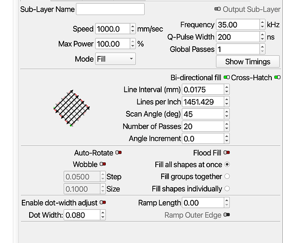

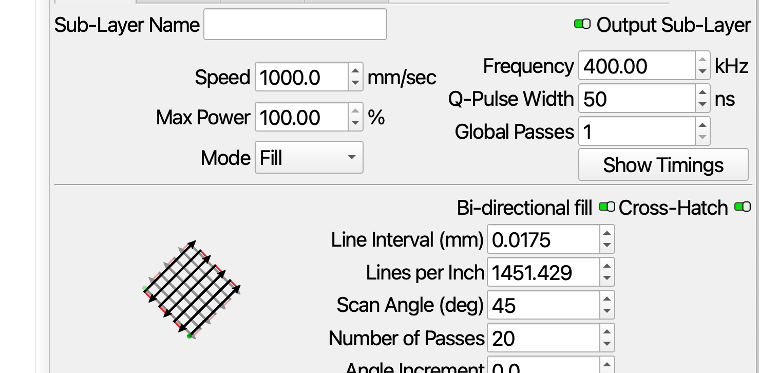

Great help. The kHZ refused to adjust any highr than 400. whats with that? I acheaved a .20 depth with the freq and Q adjustments.
My M60 JPT M7 MOPA has this warning about frequency and q-pulse settings.
★ for laser safety and long lifetime, when set ≥80ns, ≥400kHz, frequency will be limited at 400kHz

I’m trying to agree with @Aaron.F about how you’re missing a lot of control by leaving out q-pulse width.
Assume you use mm, not inches…?
If you’re using mm, then you’re talking 10 microns, with a 0.010mm interval. The spot size of an F254mm is about 30 microns or ~0.030mm. You’re making about three passes over the same area. Sometimes we do this with a fiber on purpose to heat things up and get the proper annealed oxide layer. Just be aware of your spot size.
Make sure you can do this type of resolution, unlikely you can get the same high definition of work using an interval smaller than the spot size.
An an example, if I have a 1" bit, I can’t expect any better resolution than 1dpi.
Frequency controls pulses/s (or mm) so a lower frequency give less pulses/s but can leave an uneven layer, likely what your customer is referring. The one of the left is ~45kHz and the right is about 200kHz.
Hope this makes sense?
Good luck.. keep in touch.

There’s now a Min and Max Freq Device Setting in the Ports tab. I’d suggest leaving the maximum at 400kHz
