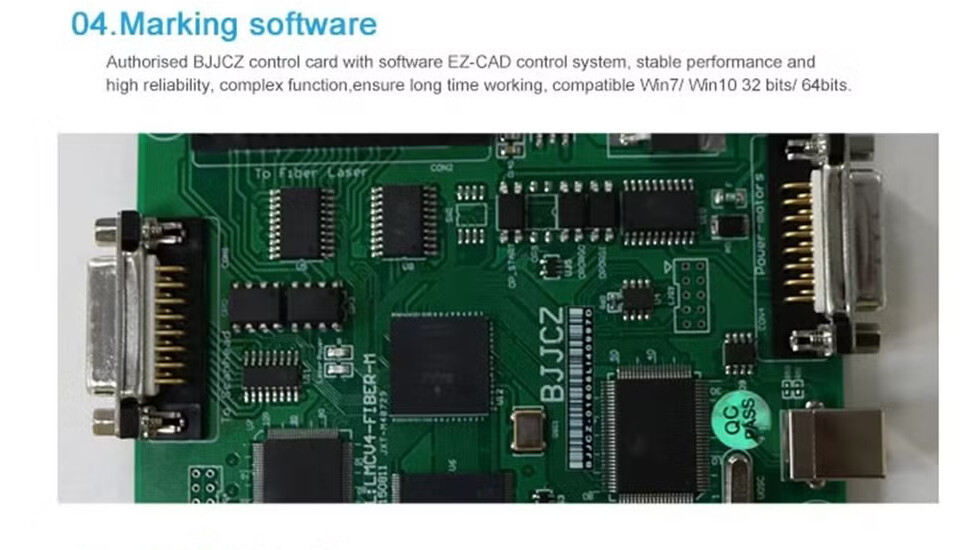

Control Board: “Model:IPG Fiber QKI”

In windows, when I power on and plug in the laser control board, it recognizes a new device, and installs “USB Key”. Even after installing the Drivers from Lightburn. I deleted that driver, and installed EZCad2 drivers, same result. After install it shows “Generic USB” and when I try to manually update the drivers, it just says “Windows says this driver is the best” and I can’t change it. I tried the driver install technique (Zadig), still nothing. I installed Ubuntu, powered on my laptop, plugged it in, and it recognized “Generic Laser device”, at least this way on Lightburn it actually detected my laser as a “GRBL” laser, I imported my lib7 settings, and it shows connected, but cannot transfer any commands, then if I go and look at the connection, It says it’s not connected.

Do you think that the control board will only operate correctly as a 32bit?
Does anyone know a control board that I could get to run the Raycus model and then be 64bit compatable? (Or if that’s even possible)

I’m 99% sure, no. The control board is absolutely independent of the operating system of the control PC. The only thing could be that the driver is not 64bit compatible, but I highly doubt that.
I think you just need to find the right driver type, and then you should be able to use it on any PC. The communication is the same, no matter which OS is used.
Gotcha. IPG seems like they sell a lot of things, I can’t find the controller card on their site, I’ll keep looking, Thanks.
Might try the machine itself… is this is?
It should work, I would think… Forget the 32/64 bit thing, that’s just the OS…
What 32bit thing? JK, so that seems like it would work and fix some of my other problems, and it isn’t a very expensive item. Thanks for that!! So one more question, should I get the DLC or LMC controller, or do you think it matters?? Thank you all so much!!
