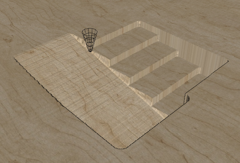

I set it up with a max depth of 15mm, and 3mm depth per pass in the roughing. That means I’ll get a pass a 3mm, one at 6mm, one at 9mm, and one at 12mm. If the image had lots of areas of solid black I’d probably also get a final black pass, but this one doesn’t, so it’s only showing 4 passes outputting. The black is the deepest part:
The idea with the roughing pass is to clear the bulk of the material, and leave a bit for the finishing pass to clean up.
Like this:
The finishing pass is always within whatever the “depth per pass” of the roughing operation was of the final surface, assuming the roughing bit could fit everywhere.
that right there is half my problem im going to deep on roughing pass, treating it like a normal pocket doing max depth cut, that’s why so much material iss being left behinf
boom now im getting what i was expecting not like my 1st pic :smiley:
so if roughing pass is set at 3mm doc finishing pass will be set at 3mm also
