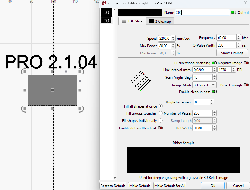

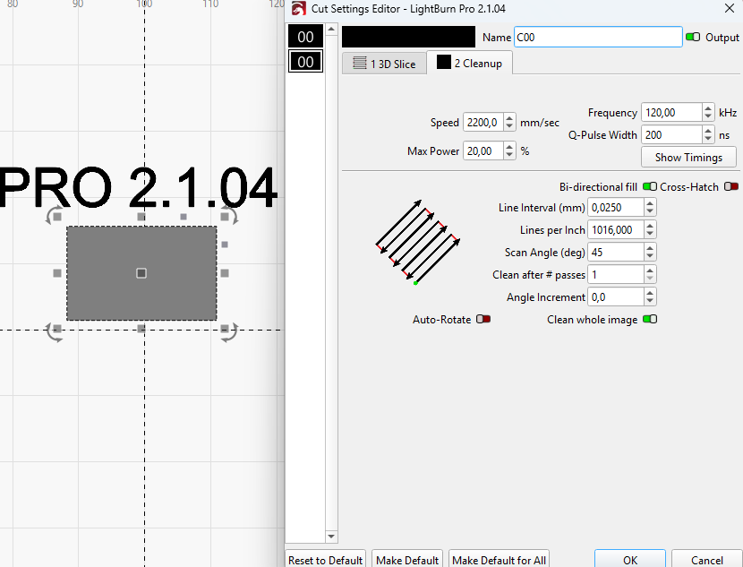

In LightBurn 2.1.04, the 3D Sliced engraving mode works correctly: the main engraving passes run, and the Cleanup layer starts automatically according to the “Clean after # passes” setting.

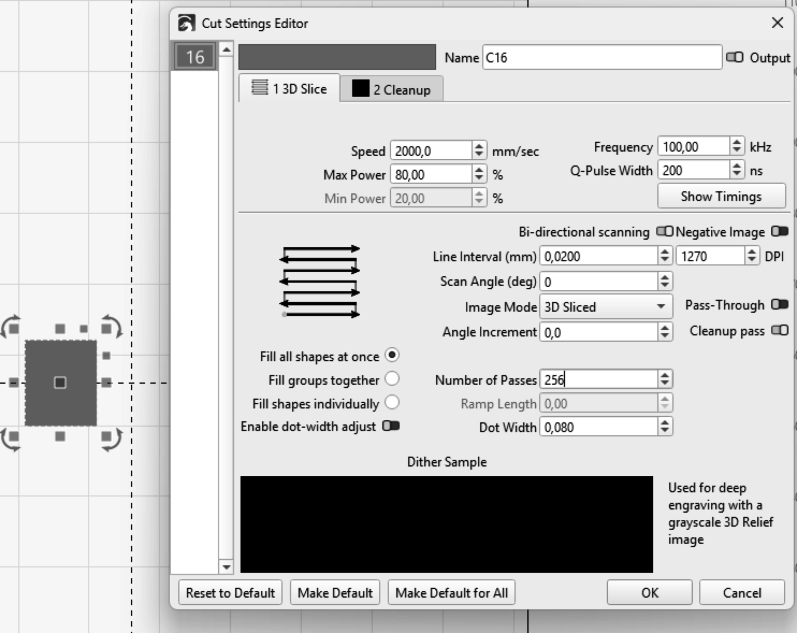

In LightBurn 2.2, the main 3D Sliced engraving passes run normally, but the Cleanup layer is never activated. The job finishes immediately after the main engraving passes.
I tested the same engraving settings and laser on both versions. Restarting the computer did not resolve the problem. After returning to LightBurn 2.1.04, the Cleanup layer worked correctly again.

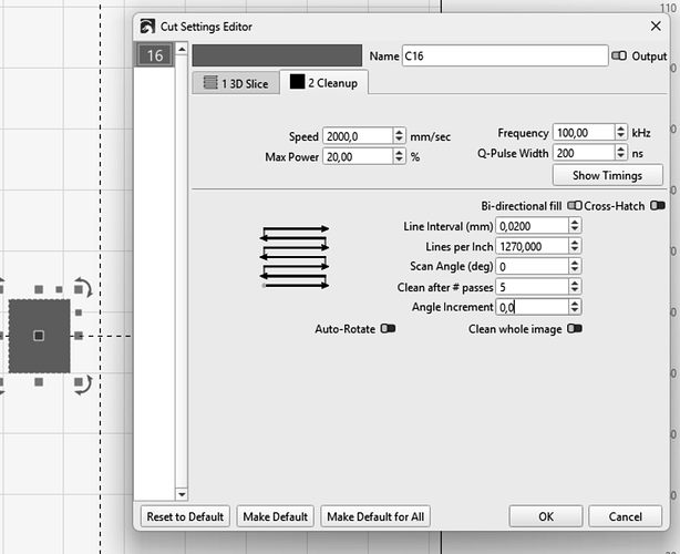

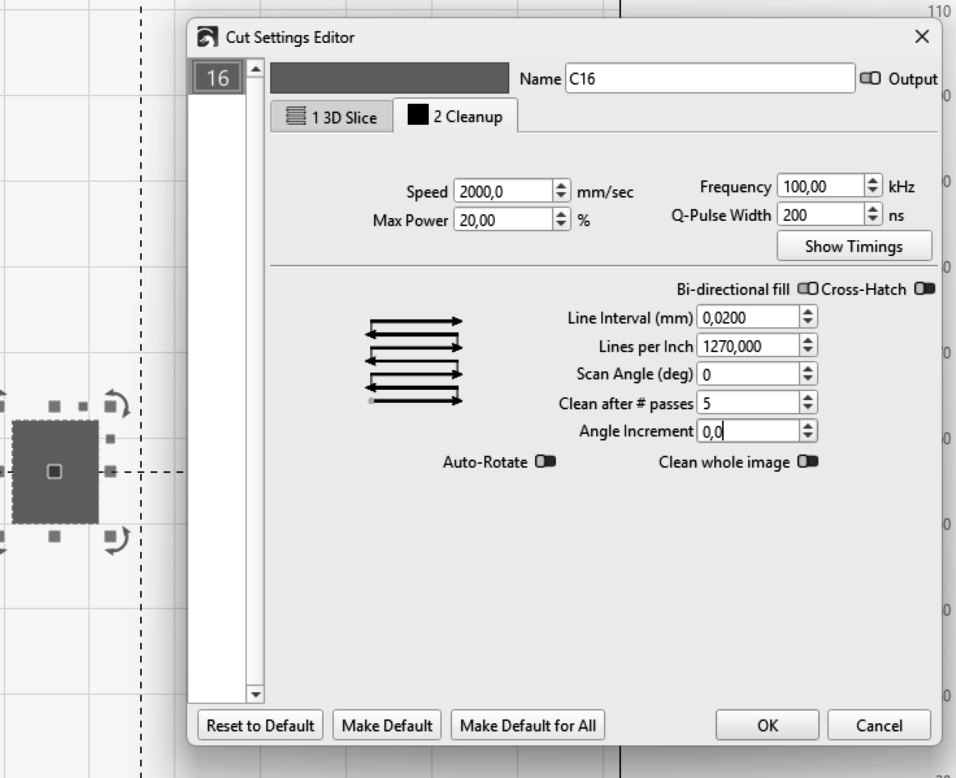

Might want to take a screenshot of your layer settings. One for the main layer and one for the cleanup layer.
Are you sure the cleanup layer is enabled?
:grinning_cat:
I don’t see anything wrong with the basic settings for using a cleaning layer.
Someone is going to ask you, how do you know it’s not being executed?

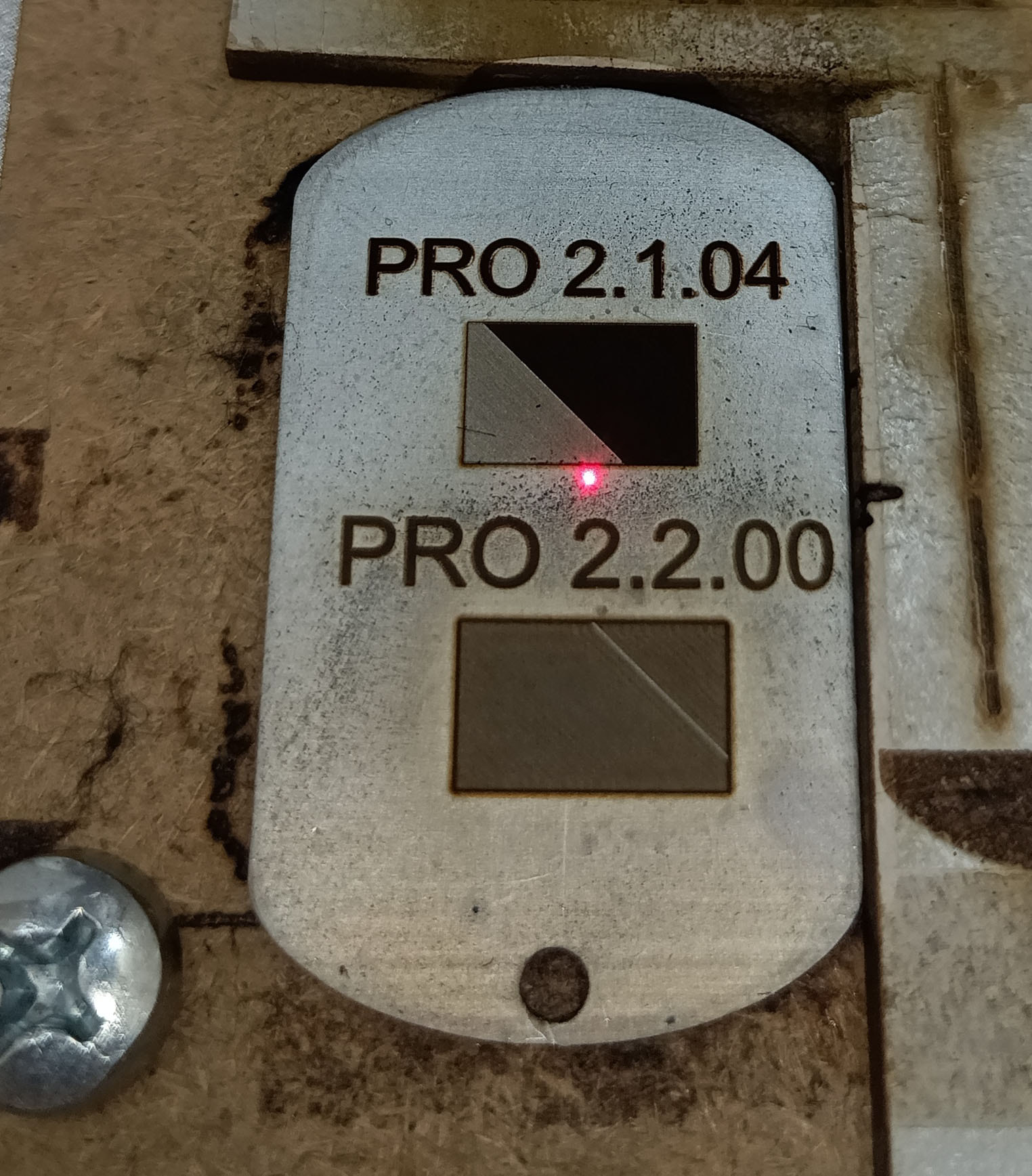

I have been using LightBurn for more than two years and already have considerable experience with 3D engraving. The laser is right next to me, so I can observe the entire engraving process directly.
When I set 10 engraving passes with a cleanup pass after every pass, I should see 10 engraving passes plus 10 cleanup passes. Instead, I can clearly see only 10 engraving passes: the metal becomes darker, and then the job finishes. The usual cleanup passes that I am accustomed to seeing do not occur.
However, everything works correctly in the stable LightBurn 2.1 version.
Ok, anyone would likely ask, if you’re used to watching it, I get it. If it works in a previous version, I’d wait for one of the Lightburn people to answer that.

I am having the same issue with the cleanup pass not running. Even after updating to today’s new release candidate it is the same.
That’s a genuine bug in the 2.2 Pre Release (Both RC-1 and RC-2)
You can also see that it doesn’t send the cleanup passes it in the Preview (Ctrl+ P)
@Kosak_UA and @scotbro thanks for bringing this to our attention. I’m creating an internal report.
