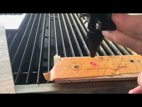

No matter what I try, I can just not seem to get my laser aligned. I believe the issue is with my 3rd mirror. The other mirrors should be fine. I’ve made a video of me trying to align the 3rd mirror and the result I get. Any help would be SO appreciated.
The video should be viewable now.

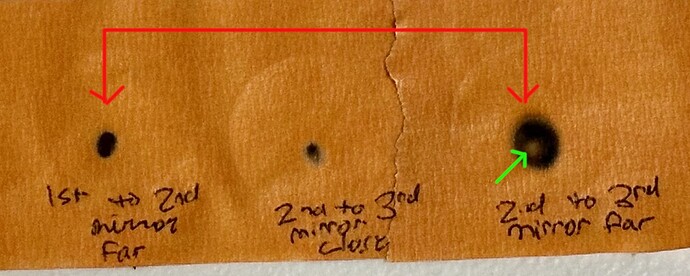

Here are the dots on tape on each of the mirrors. I made separate burn marks far and close so you could see the quality of the dots. The close and far dots do line up when on the same tape.
It is subjective, but for me it is not 100% ok.

Maybe it’s just me, but it looks like the beam diverges more than it should between m2 and m3, marked with a red line.
There is no way to tell the beam quality as these are just black spots for all practicality. Less power and/or shorter pulse time.
However, the right hand one seems to have less power near the middle, green arrow, than around it’s edge.
One of the issues is how big in diameter is the full size beam. You’re right, this would be unacceptable to me as far as doing a proper alignment.. It should be easily fixed, it’s not like these alignments routine require an education level of brain surgeon, it’s not rocket science either.
In his video, the laser lines seem out of focus, cut seems thicker than I’d expect.

There does seem to be more divergence in that last spot than there should be and I don’t like the beam shape, either.

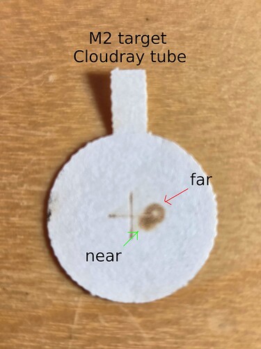

Replaced the original OMTech tube … I thought it had been less than a year. Had terrible performance, so I checked alignment. Looking at the spot before m1, it was very small, maybe 1.5mm and had moved – off center.
Two pulses to m2, near, green, far, red. Far pulse shows the departure from TEM00. Bummer, though it’d been close to a year, but I put this tube into the machine in January 2023 … who knew? Tube was manufactured in November of 2021.
When I pulsed on m2 at the far distance, I could see the doughnut shape… so I ordered another one from Lightobject. This new ones 50W, 1000mm in length, so I’ll have to figure out how to handle the part sticking out.
The near spot looks very similar to the one taken at m1, but the far shot shows the failure. Funny, this was aligned to the center last time I used it ???
