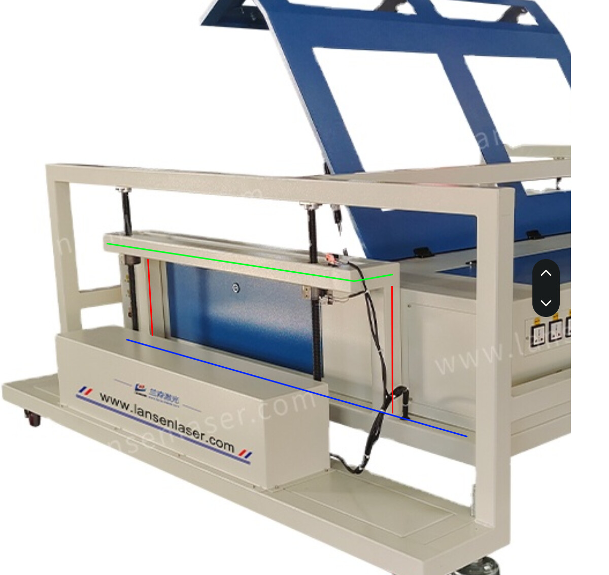

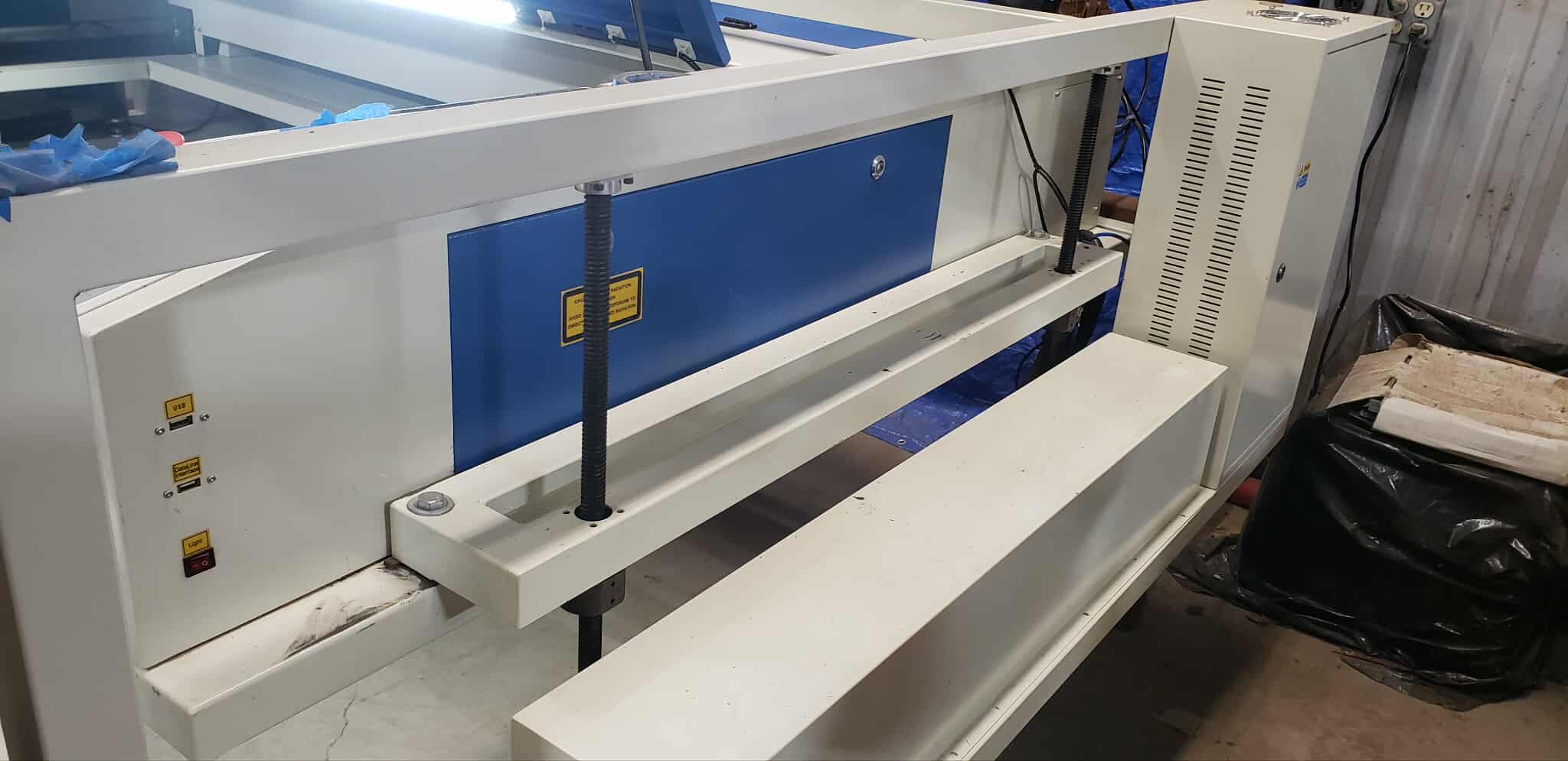

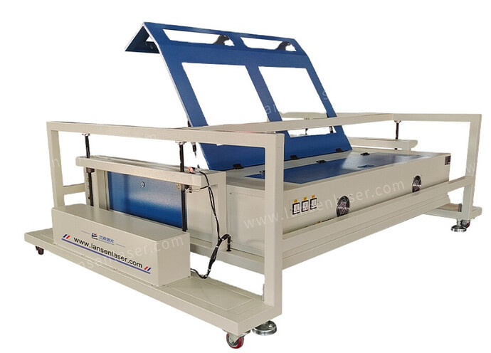

The working area is 1600mm by 1000mm and is meant to engrave objects that can be wheeled underneath. The Z axis moves the laser/gantry frame up and down while the outside frame remains still.
It had an inherent design flaw which caused it be unstable while in motion and induced vibration. I modified the machine by removing the 2 posts (2 on both sides, 4 in total) shown by the red lines. This fixed my instability issues caused from vibration.
The cross-bar (green line) now sits atop the machines frame (blue line) and they were bolted together.
Below is what it looked like after the modification:
I’m sharing this for context of my situation. I didn’t directly modify the frame in which the laser and rails/gantry sit on. It’s as if the machine has 2 frames now. All I did was take an cut off wheel to the red bar while the machine sat on cinder blocks.
I’m unsure if I caused the issue with C4 but it’s very likely it was there all along. I simply don’t know.

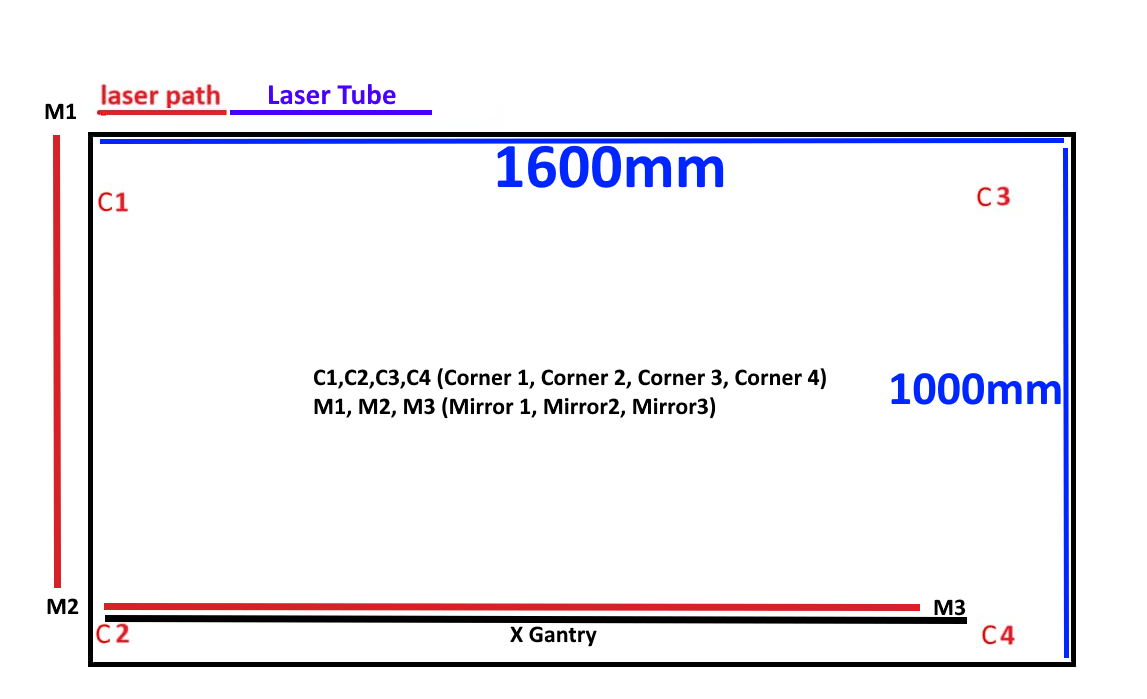

Too make it easier to explain things I will share this diagram

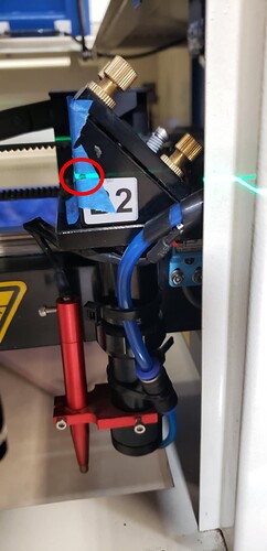

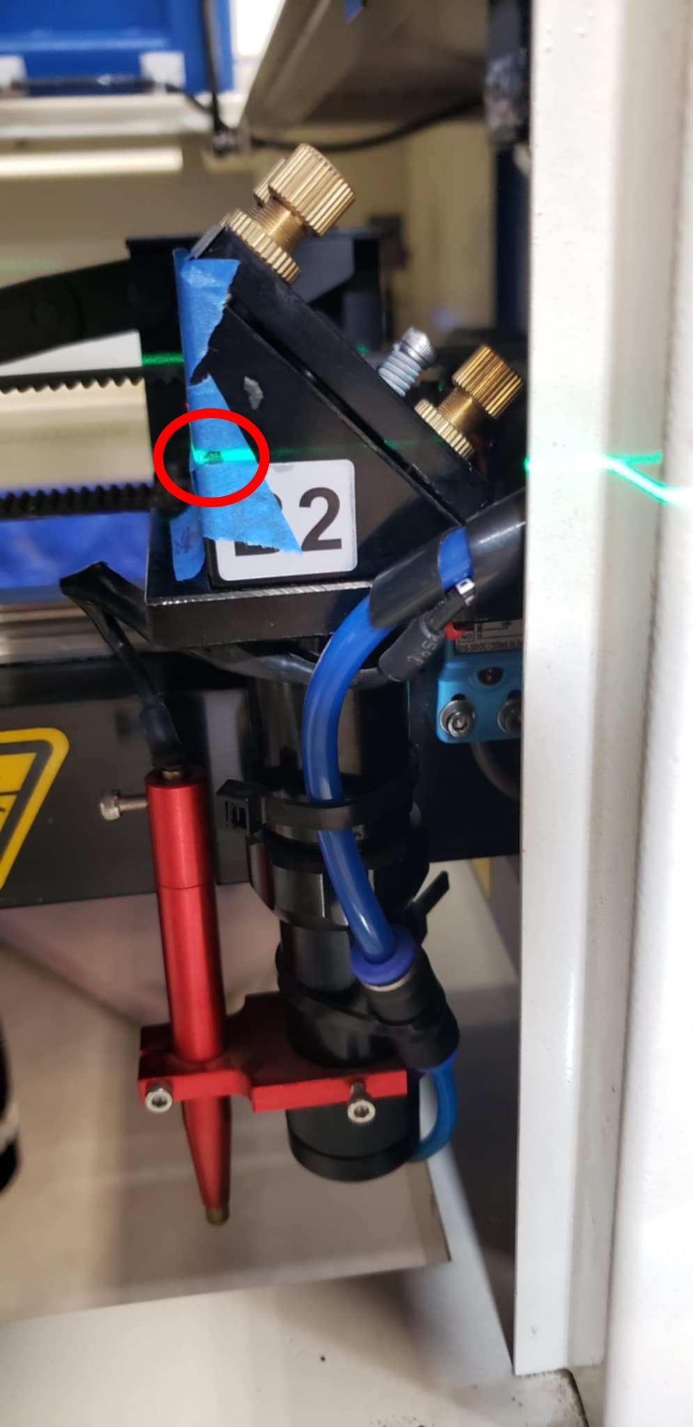

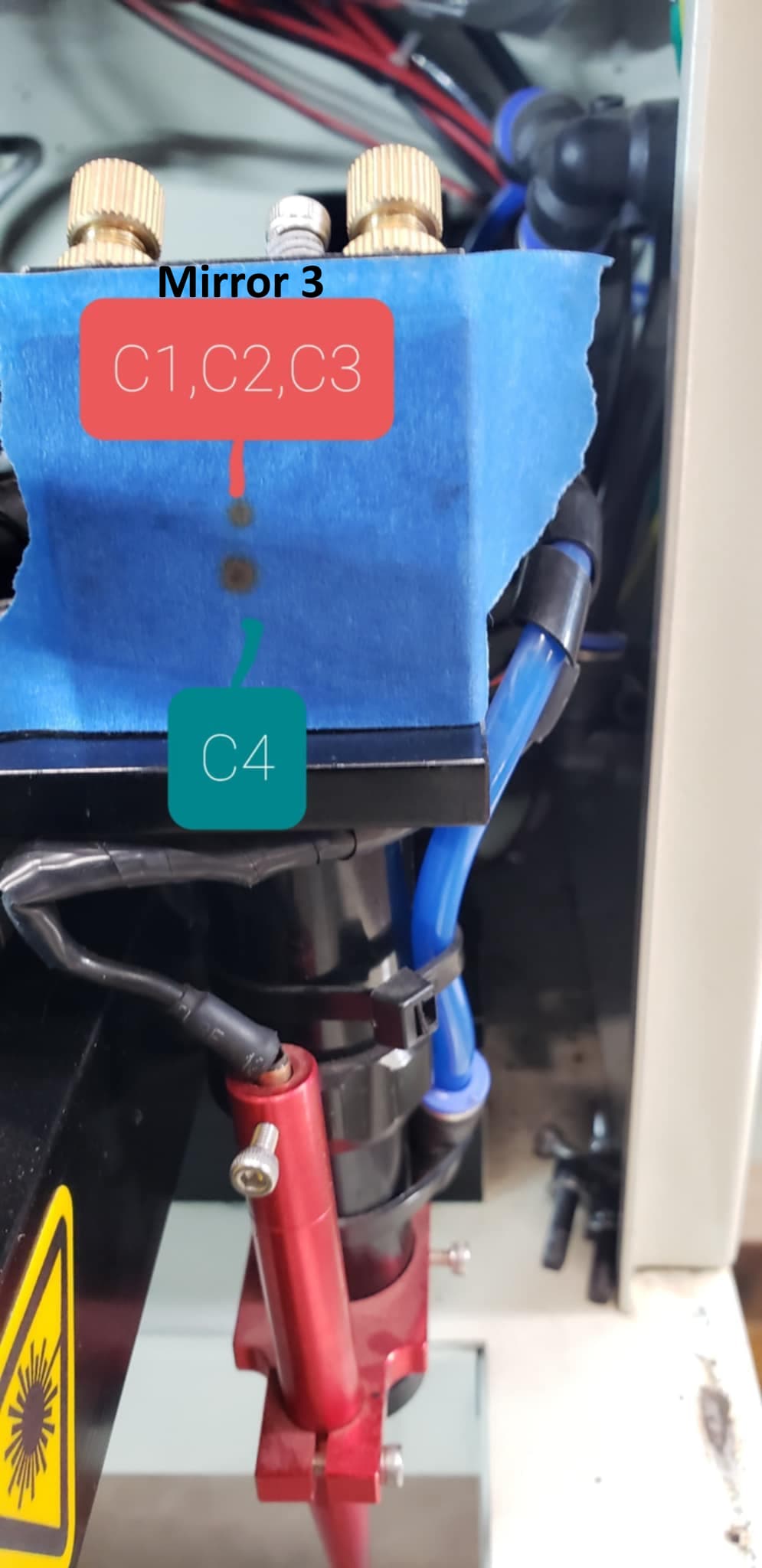

I’m able to burn a concentric dot on M2 at C1,C2
I’m able to burn a concentric dot on M3 at C1,C2,C3

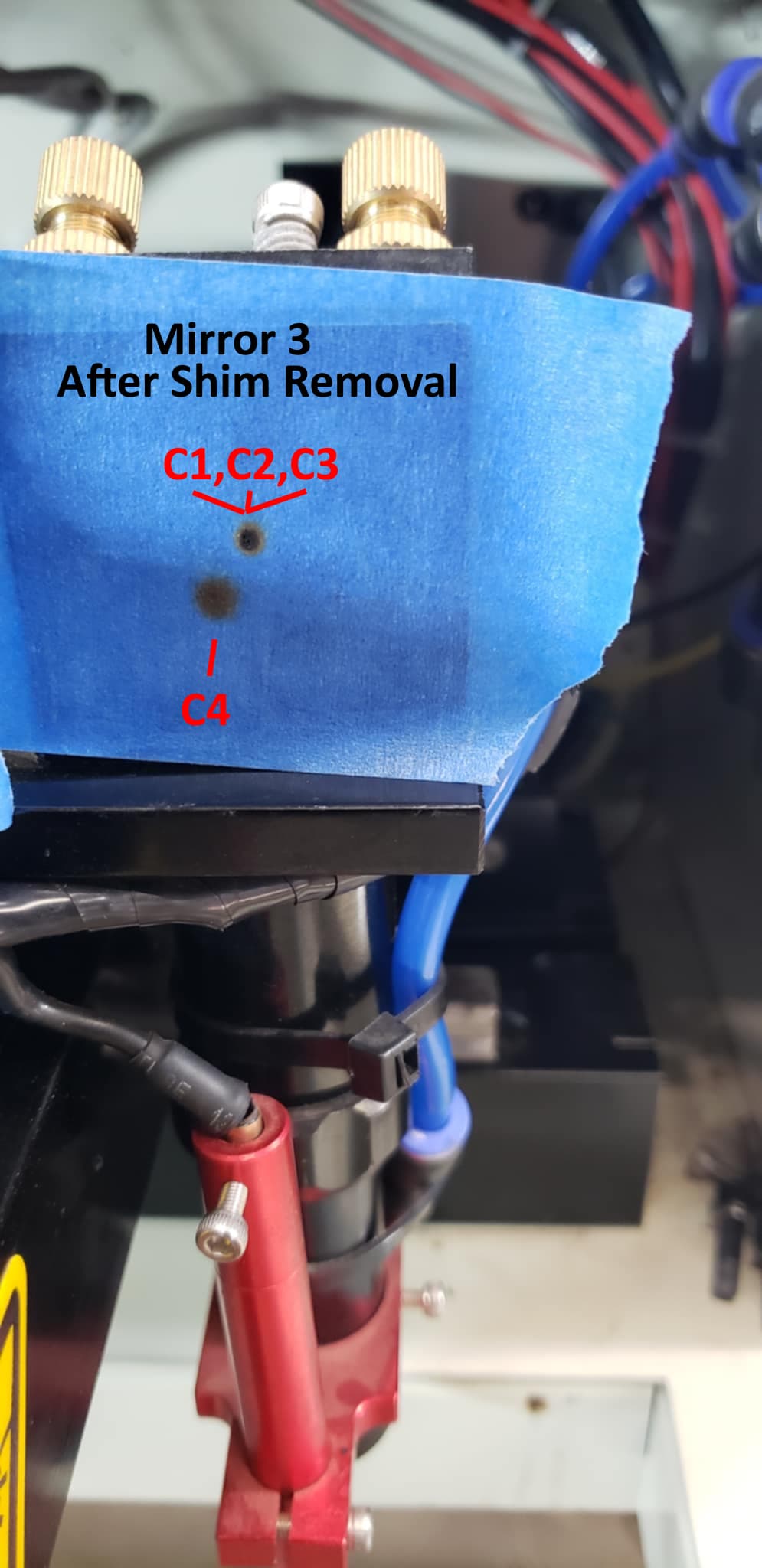

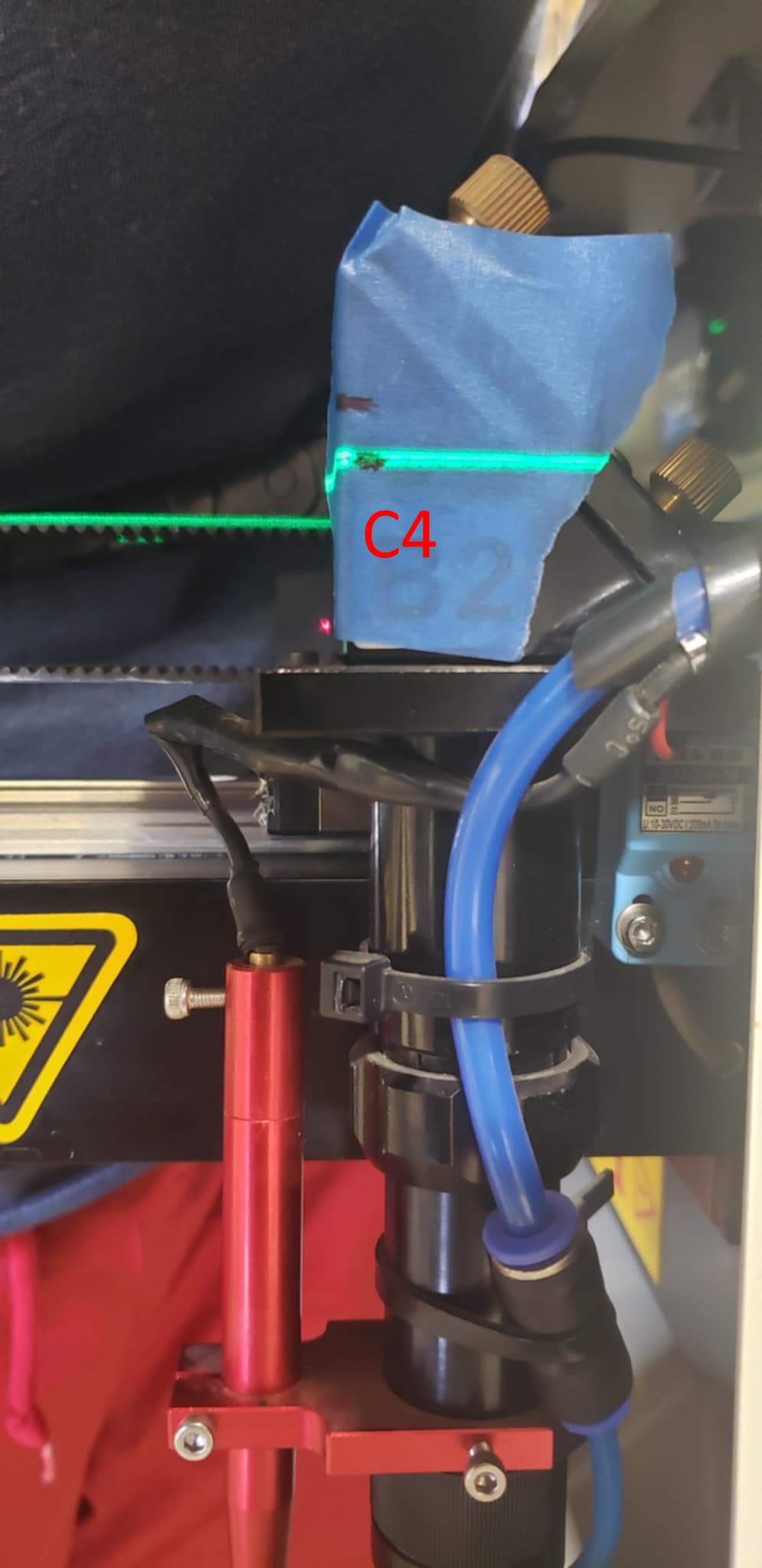

I am UNABLE to burn C4 to be concentric with C1,C2,C3. (C4 will be 5mm below other burns)
I tested one time and was able to have concentric burns on C1,C2,C4 and NOT C3. (C3 was 5mm above other burns)

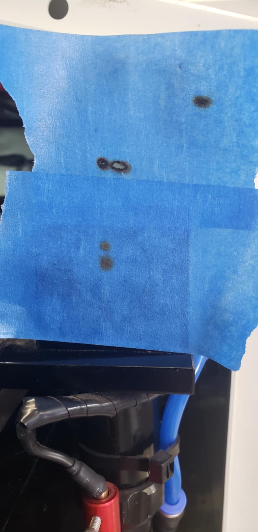

These are the burns my laser produces

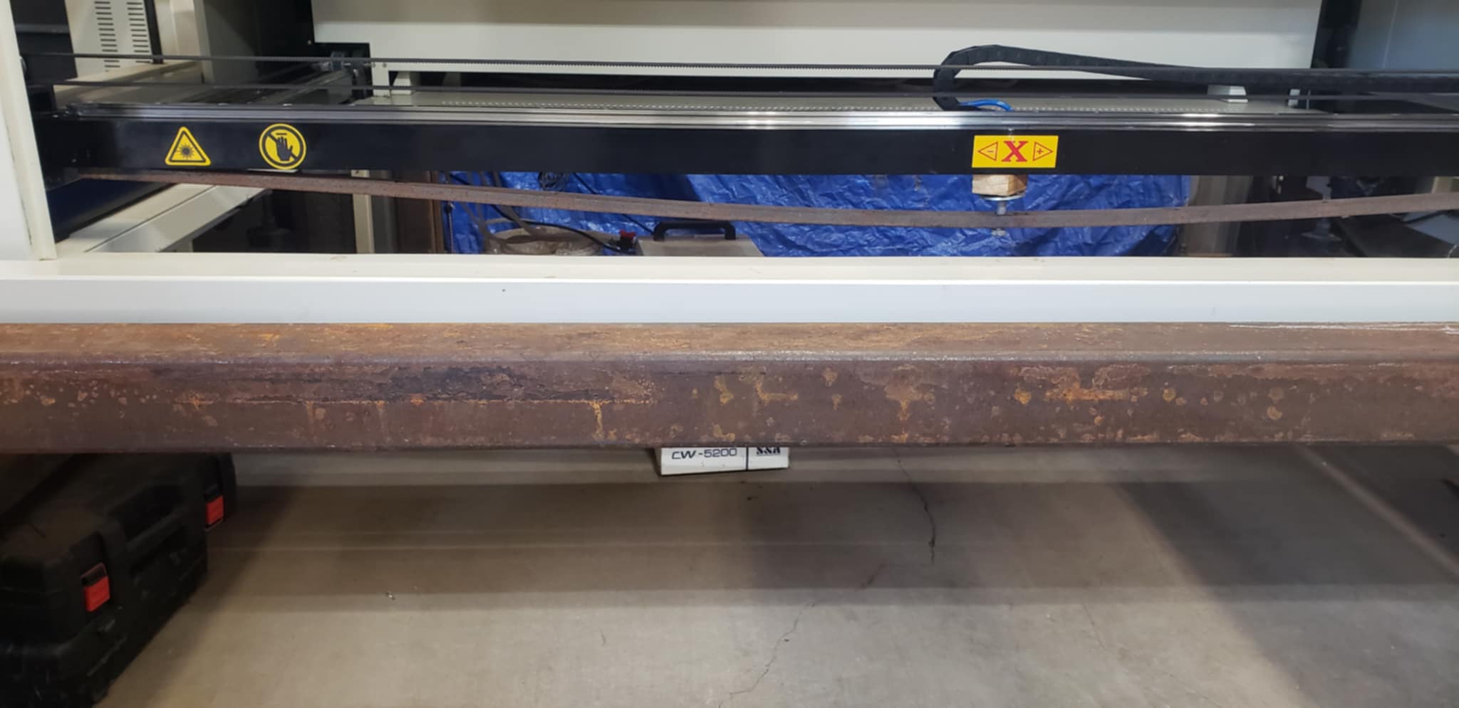

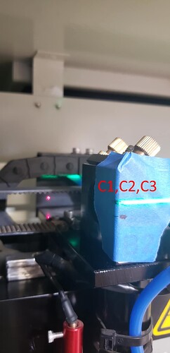

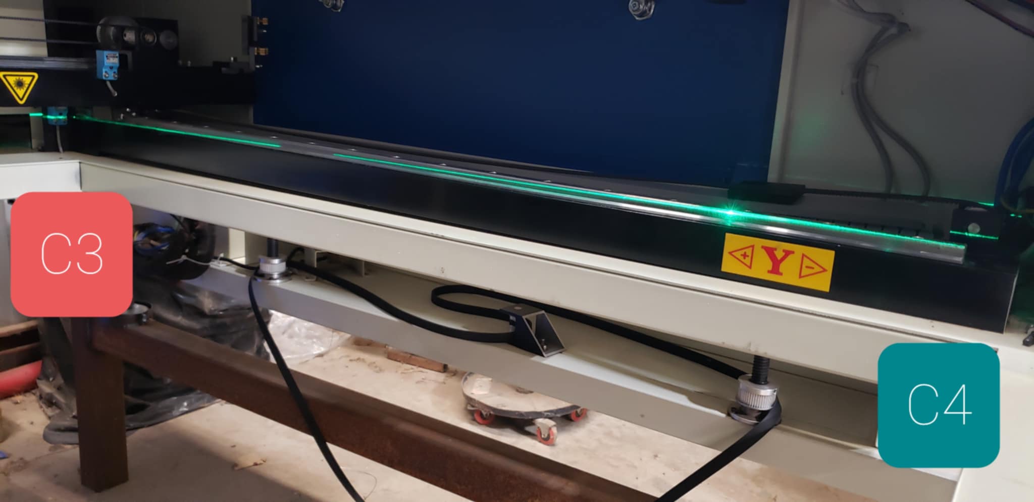

  1. Making M3 co-planar on all 4 corners. In the photo below, I used a 360 laser level and made the black dot (drawn onto the blue tape) perfectly lined up when M3 was on all 4 corners. I did this by adjusting the lead screws the machine sits upon which touch the ground. Making the machine co-planarseemed to have no effect on the C4 burn.

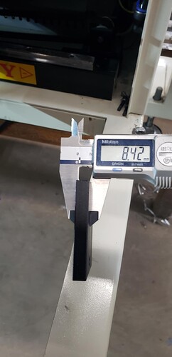

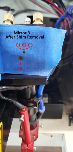

  1. I removed the gantry shims at C4 and in between C3 and C4. These are about 8.4mm thick and dropped the rail in C4. This seemed to have little of the desired effect. NOTE, this was done before I made M3 co-planar on all 4 corners.

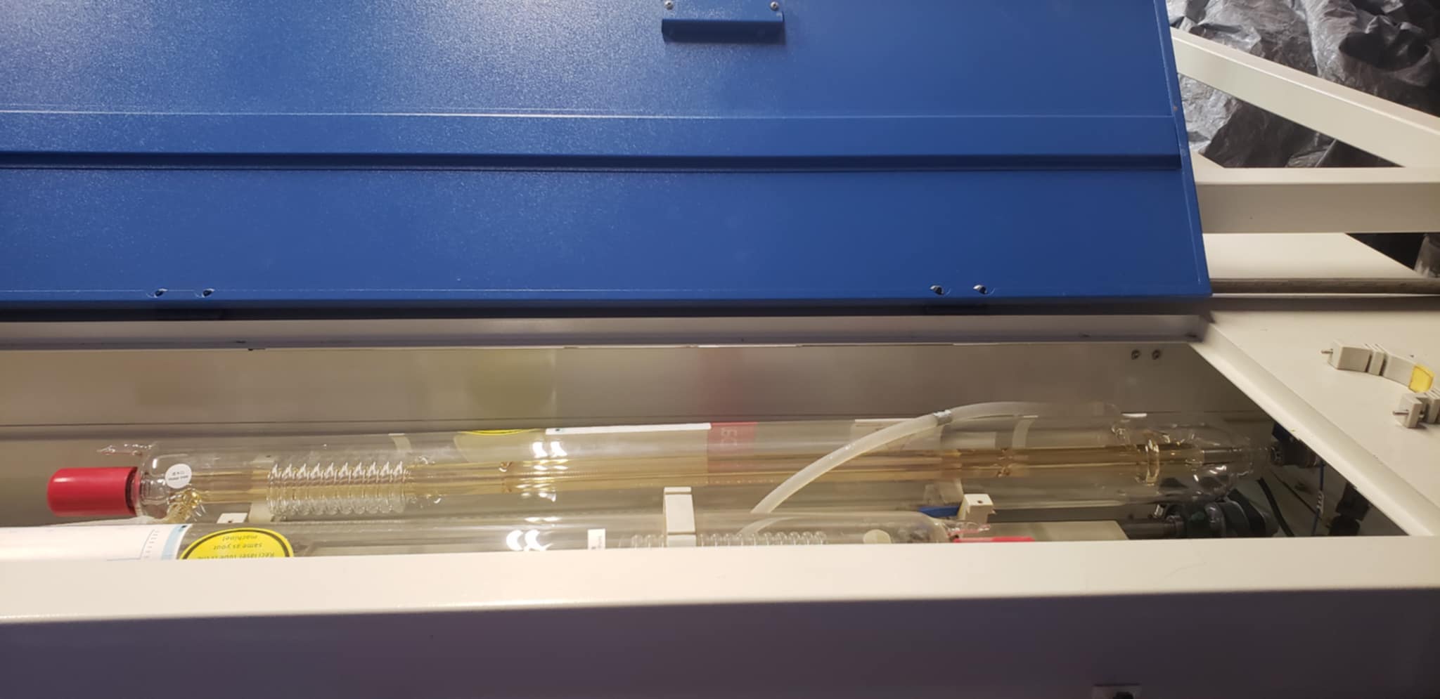

I have seen this corrected by shimming the correct end of the tube. I don’t think that’s what I’d call a good fix, but I have seen some success. If you’re out of options, then maybe it’s something you can think about.
Shimming the end of the tube would aim to accomplish what exactly?
Isn’t any angle coming from the tube completely neutralized vertically once it hits M1?
Yes it is, but if you don’t modify M1, then the path can be lowered by adjusting the tube. I don’t like this and have never had to use it, but I’ve seen it multiple times.
If you don’t want to try it, I’m not sure what to suggest. Seems like you and @ednisley have done all the other alignments.
If it’s as you both state, aligned properly. The only thing that can cause this is the lack of it being 3d square.
I’ll run with this and see if something pops up in my mind about what to check.
Good luck
I actually moved the tube 2 days ago to get the burn more centered.
All I’m saying is, I don’t think tilting the laser tube changes the angle of the beam. But I’m not 100% sure on that.
It does. You can correct for a misaligned beam axes. The last fixed mirror that the beam reflects from can be any angle, within limits. 45 degrees makes this easier to deal with.
Imagine tilting your tube 45 degrees, you don’t think that will change the beams impact for all the mirrors following?
It’s relatively moot anyway as you’ve tried this. In any event the beam is straight, finding where is goes wrong might be a bit of an issue, especially with large machine.
Good luck.
I didn’t “level” the tube. I moved the tube up on 1 end to get the beam centered
Tomorrow I’m going to try tilting the laser tube and seeing if that may help.

1. Tilting the laser tube
This appeared to have little to no effect. The 4th corner about 5mm below the concentric center. My thought was to aim the laser higher to try and bring the 4th corner closer/higher to the concentric center as shown in the image below.
It does appear that the dot is closer (about 3.5mm away now, to the best of my ability measuring with calipers) but I started to run out of room to further tilt the beam upwards and still hit the mirrors. I thought maybe I could have a defective laser tube that is not shooting a straight beam, so I rotated it 180 degrees to see if the laser path changed, but it didn’t.
So it appears tilting the tube might have slightly helped? Or it could be an error in my mirror tuning. The laser tube is well out of coplanar from the gantry’s at this point so I’m not sure why the C4 burn appears to be moving closer. It was definitely harder to tune the burns to be concentric and doesn’t feel right. Below is the burn result
2. Dropping the 4th corner 6mm to try and bring the 4th burn 6mm up

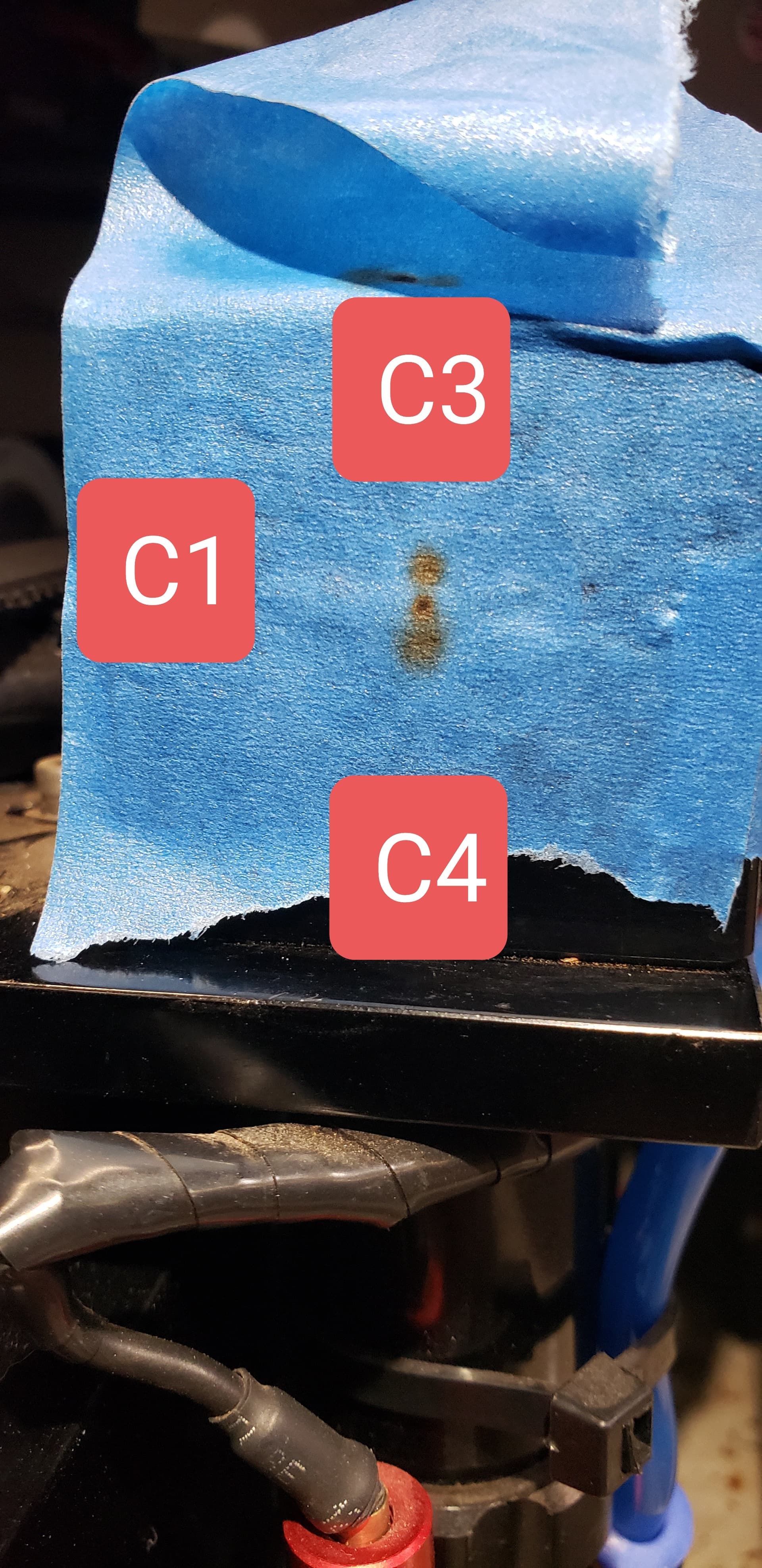

I put a piece of tape on M3 and drew a black line where the laser hit corners 1,2,3 (all perfectly aligned), I then measured 6mm down and drew another black line. I then lowered the leg underneath C4 down to where the bottom black line touched the laser. This now puts C4 6mm below C1,C2,C3. This was performed when the laser tube was set back to as coplanar with the gantry’s as I could make it.
M3 at C1,C2,C3 - all coplanar
M3 at C4 - 6mm below C1,C2,C3
This is the resulting burn:
As you can see, it appears more than 6mm away.
My current hunch (completely unfounded) is that the left Y gantry that M2 rides on top of is twisting inwards as it goes down to C3. This could cause M2 to slightly aim downwards after it reaches C3. That could possibly explain why the beam drops 6mm in C4.
However, that doesn’t exactly explain why when C4 was lowered 6mm, the C4 burn is STILL 6mm below the other 3 burns.

  2. The X gantry is not nearly rigid enough and bows down in the center of the machine. I actually resolved this by bolting on a metal bar with a lead screw in the center which forced the bend out of the gantry. This completely fixed the bend, but the non-concentric burns still persist. It looks crazy, but it works lol.

I removed a 8.42mm shim underneath C4 and the burn location didn’t move. I don’t understand how that works at all. But moving the mirrors/rails on the vertical plane (by means of removing shims or turning the lead screw feet that touch the ground don’t seem to have the desired effect were looking for )

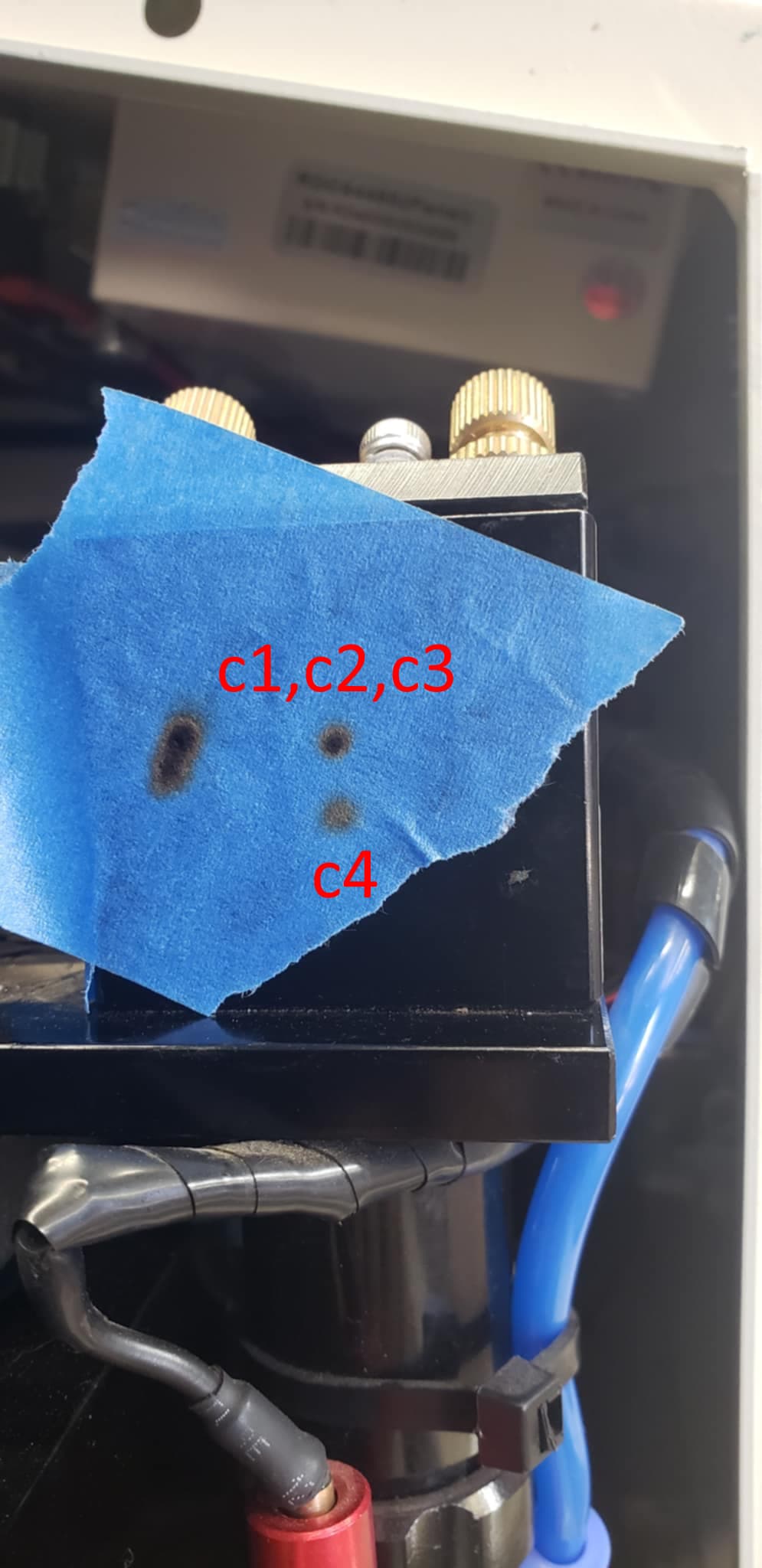

I’ve come to better understand how to explain my problem possibly.
It is very difficult to align burns on M3 (Mirror 3) at C3/C4 (Corner3/Corner4). The only way I’m able to align burns on M3 at C3/C4 is if I crank M1 so hard that M2 at full distance is about about 5mm from concentric center of the rest of the burns.
So my real battle is to figure out why C3 and C4 aren’t aligning. The difference is purely on the vertical plane. The dots are in line, one above the other, but spread 5mm spread.

Try this approach if you haven’t already:
After aligning M1, and then M2 at the back end of the machine you will have C1 C2 C3 spots stacked.
Now burn the spot at C4
If it is low, while in that same position adjust M1 to tilt up ever so slightly until the new spot at M3 is the same distance above the other stacked spots as the spot at C4 was below.
The next time you check the alignment all 4 spots should be slightly higher, but hopefully (overall) closer together.
