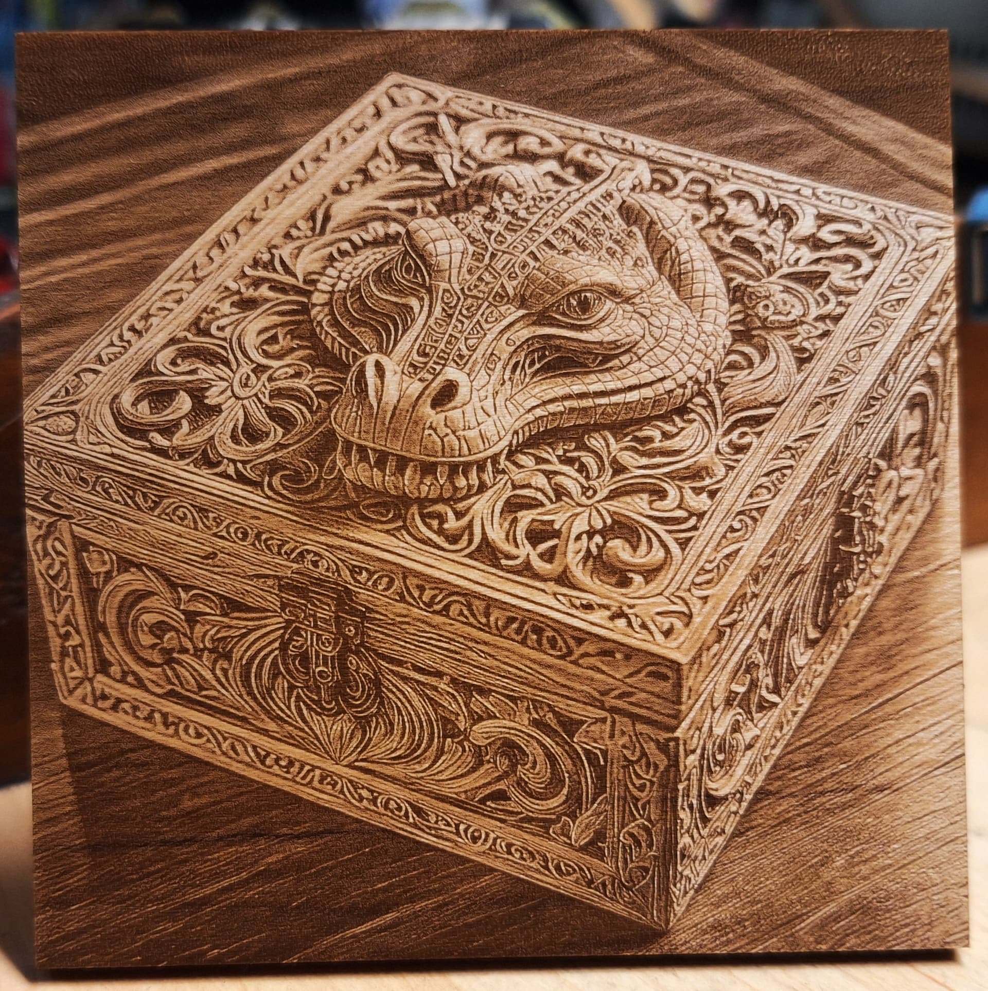

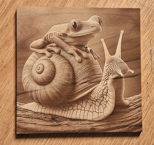

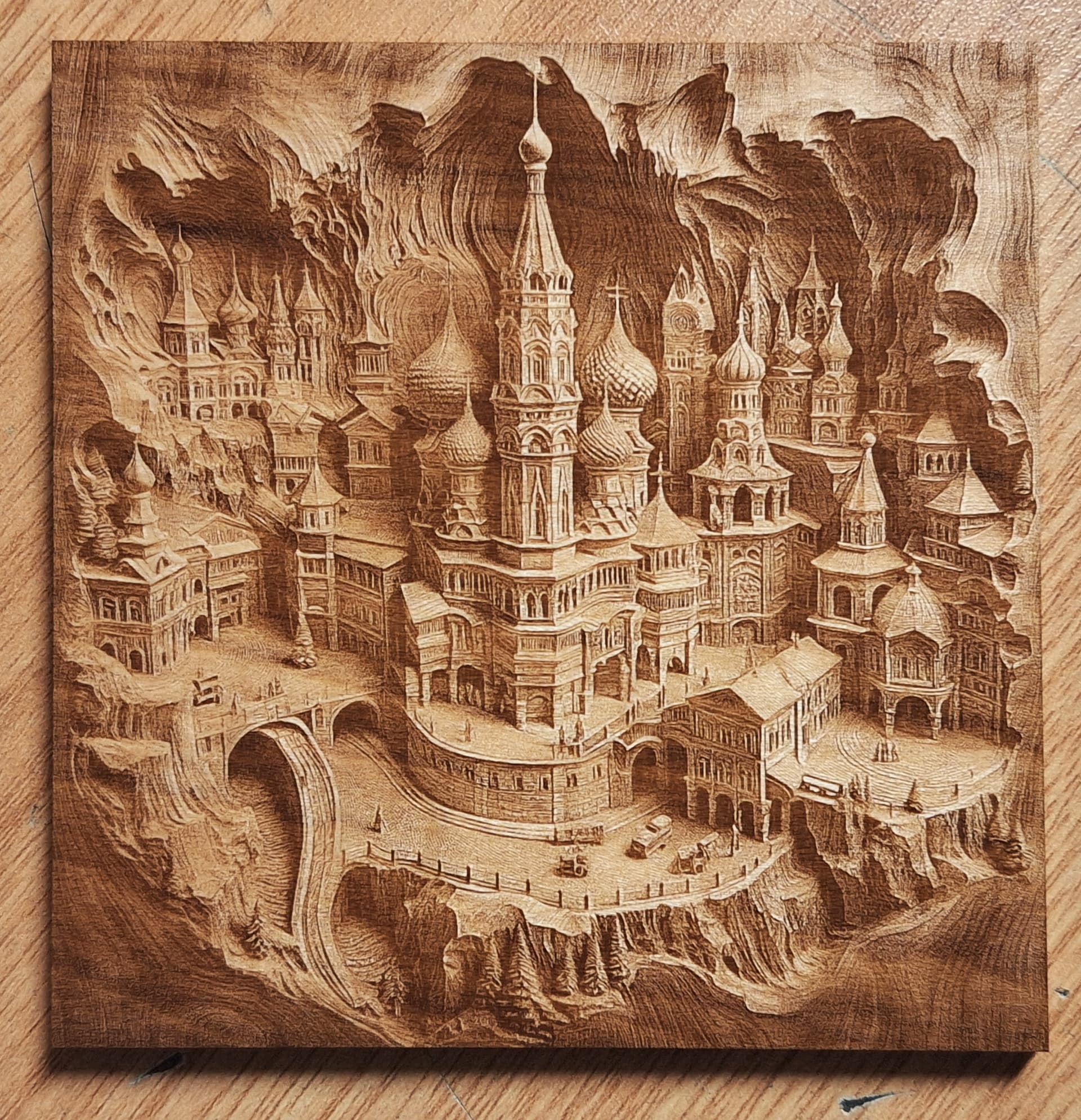

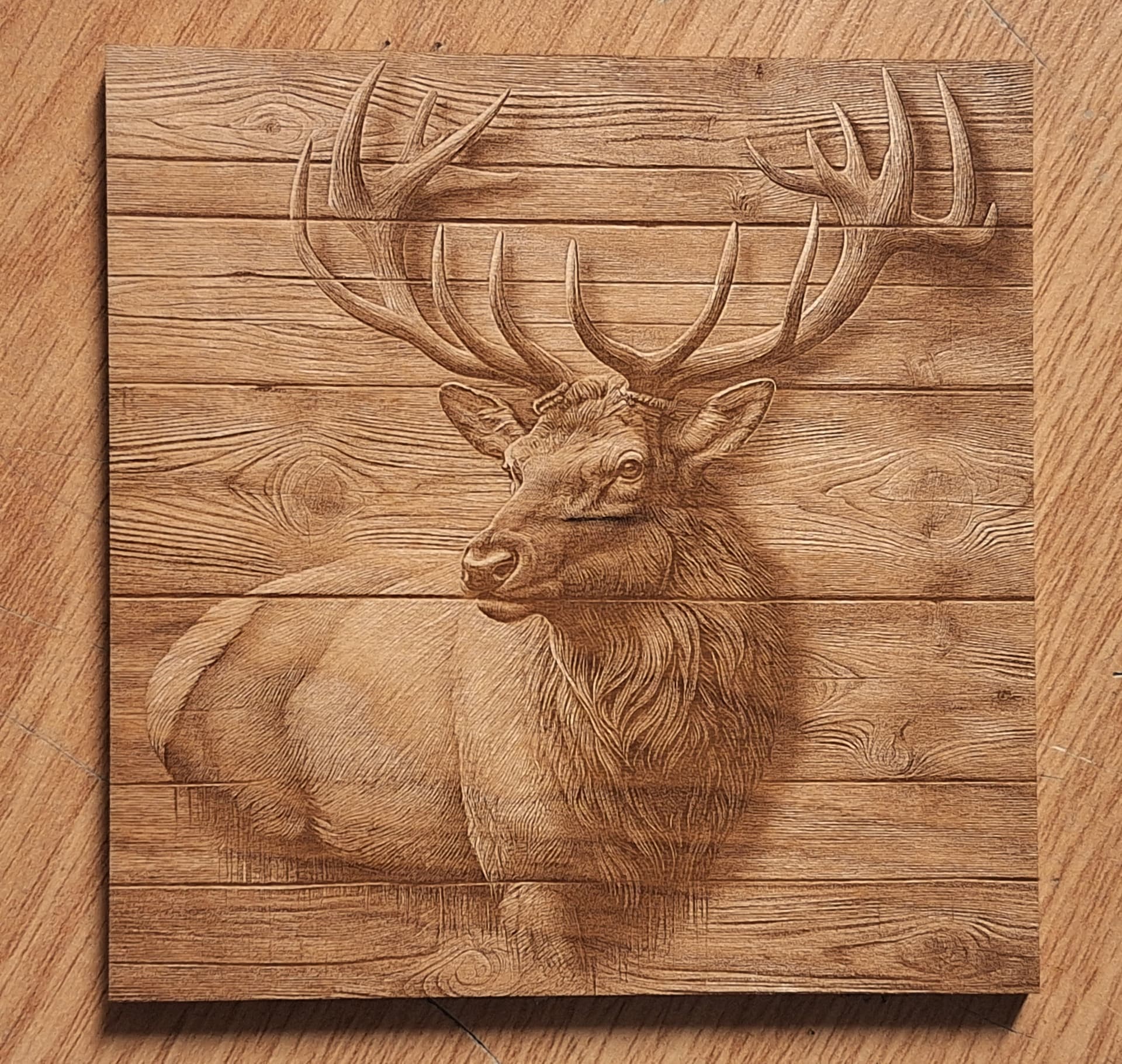

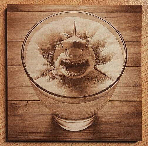

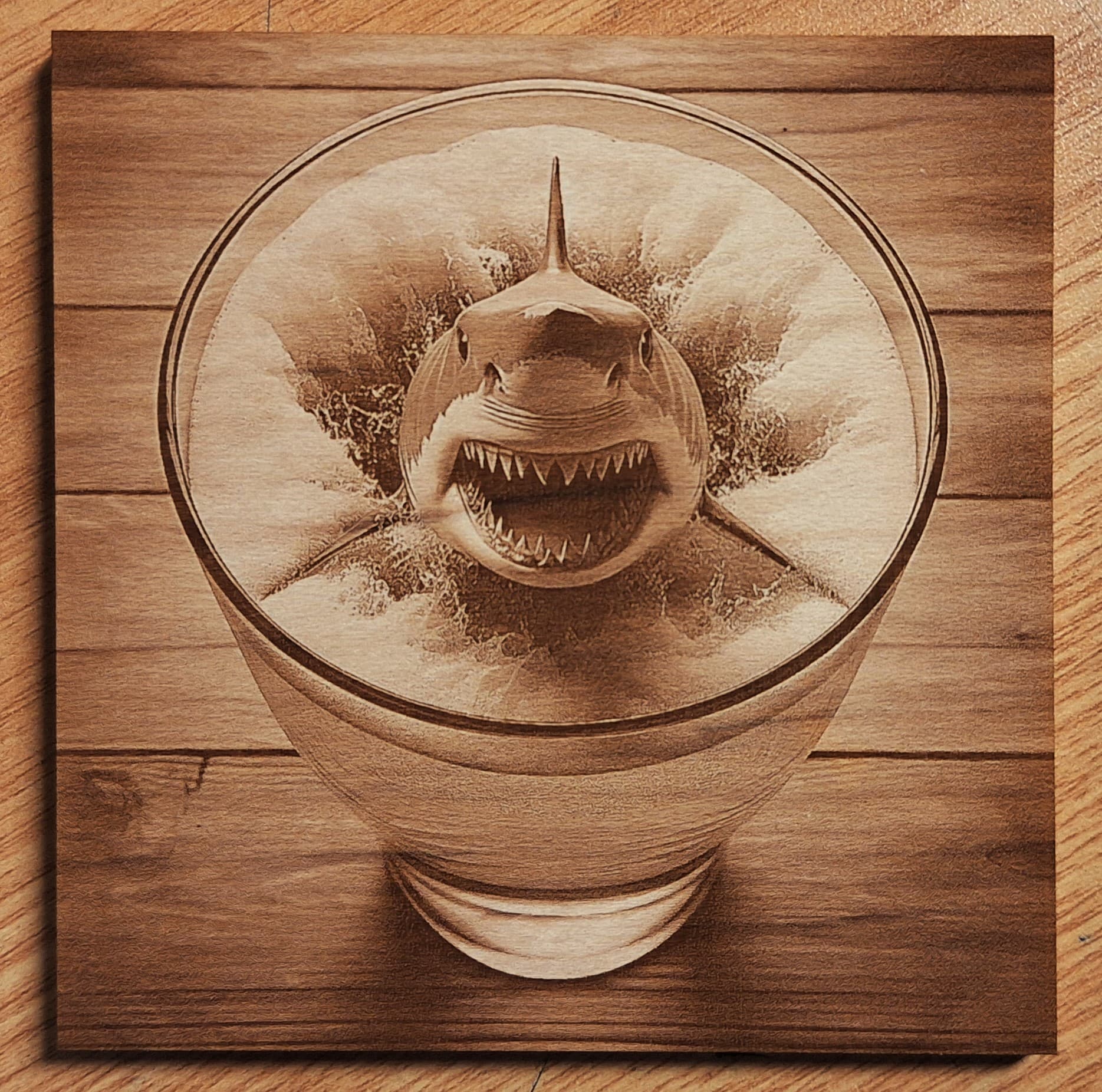

5 watt UV 330 lens Maple Veneer
100mm/sec
80kHz
6 ns
420DPI
Stucki dither

Stunning work as usual. Thanks for sharing!
How many hours of work, on average, are spent on this?..
Stunning result.
Congratulations on sharing. Whether it’s the final result or the definitions!!! :clap:
@Kuth Thank you
90x 90mm about 15 minutes
It seemed bigger to me in terms of dimensions.
Let me call them “little pleasures in sight”. :ok_hand:

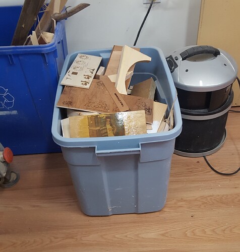

Brilliant! I now see my growing scrap pile in a whole new light.

Wow… What machine do you use..? I have a 5w UV. Mine came with a 150mm lens. Would really like to find a bigger lens if possible.
Thank you
I have a Hao-Tian
came with 150 and 330
The 150 lens went funky
So Now I,m using the 330
