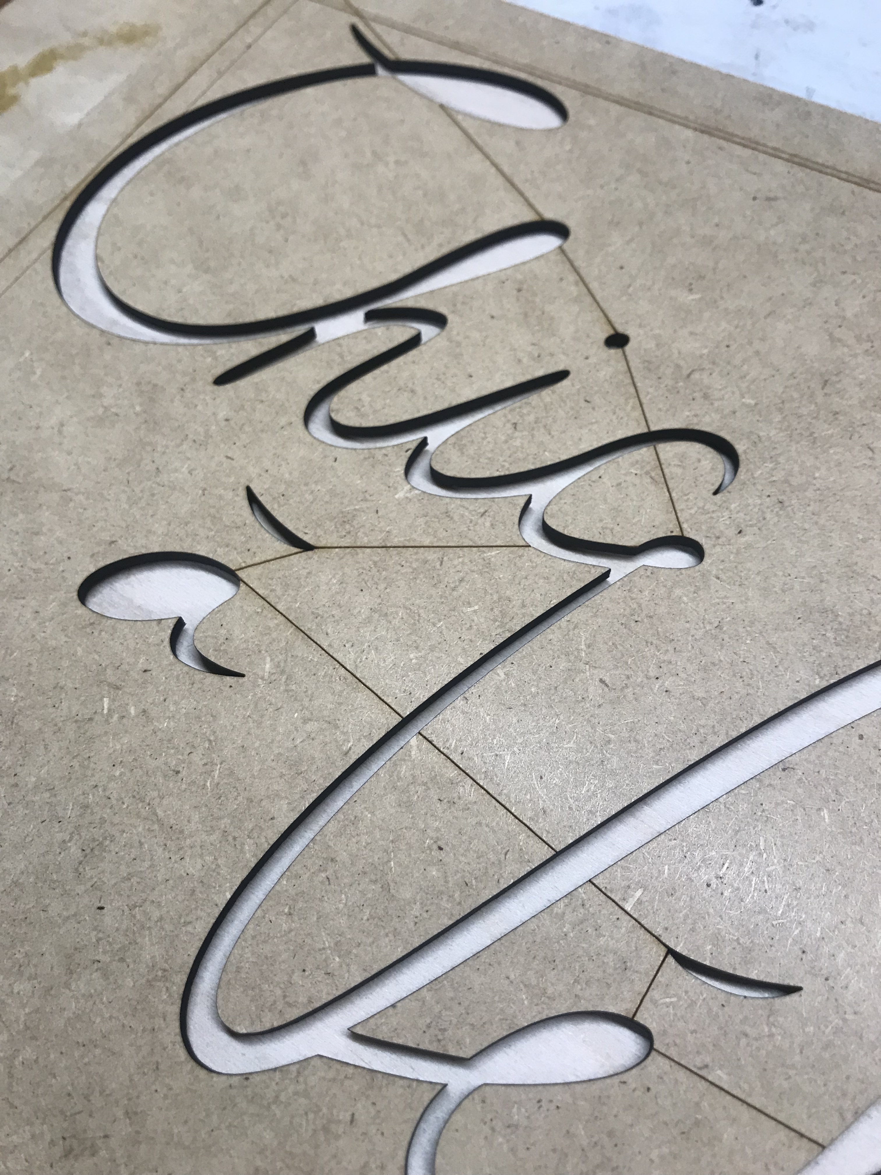

I now find that when I frame the work the laser fires and marks the frame on the workpiece! It also marks a trail between individual cuts.

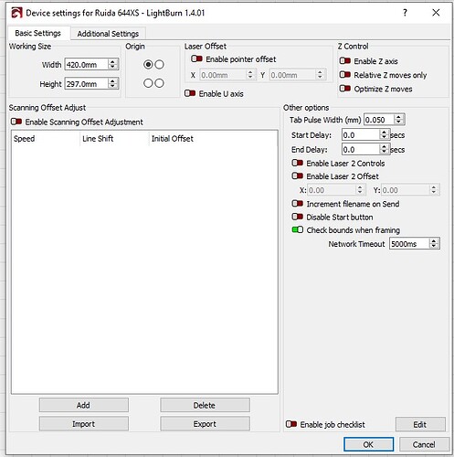

There used to be an option in Device Settings to switch on (or off) the “enable laser fire button” which also had the option to change the power setting of this “pulse”.
It seems the updated versions do not allow this on DSP controllers (CO2 laser), for safety reasons?
How do I fix this? It’s driving me mad
I’ve attached device settings, PC spec and a photo of the problem.

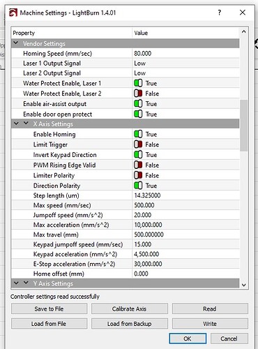

However, one more thing to check: make sure the wire carrying the L-ON signal from the controller to the power supply is firmly connected at both ends and is not shorted to GND. This is easier if you have a voltmeter: the signal should be around 5 V with the laser beam off and 0 V with it on.
Did you sort out the failure mode in which this happens? I assume controller is not involved since it’s not commanding the LPS on. Did this require motion from the steppers? Or was the laser just consistently firing all the time?
I’m very not comfortable with the laser failing unsafe. That seems a bad design.
The HV power supply had only two signal inputs as they built it:
IN = PWM control over how much tube current
L = when to fire the laser (active low)
AFAICT, the optoisolator on the L signal failed hot, so that the laser was always ready to fire whenever the IN PWM signal was non-zero. The controller seems to set a low PWM value when framing (over which LightBurn has no control), so the laser fired even though the L signal was inactive.
Aaaaand, because OMTech built it with the power supply’s P input jumpered to ground, it would fire even with no water flow.
I ran the lid interlock signal to the replacement supply’s P input, in the hope that it would not fire with the lid open, even if the L input failed the same way again:

I configure and use mine the way it was designed. The water protect is handled by the Ruida. The reason behind this is simple, no matter what, you are depending on the electronics to work… if it fails from a power outage the Ruida can recover on power up… if P input goes inactive connected to the lps, the controller has no knowledge of it and continues…
As an operator it’s up to you to know how to handle the equipment. You should never be in the path of anything that can hurt you without disabling it’s power source…
I only use Door Protect on my Ruida and the chiller is connected to it… I just have to know if the controller says door protect error, that it’s the chiller… The WP1 input failed to read…
You could see the led indicate active, but the Z/U → Diagnosis did not show it had become active.

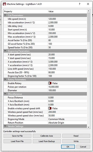

You mention PWM settings etc, where do I see these? And there’s a mention of performing diagnostics. Can you explain in simple terms please. Again thanks in advance
