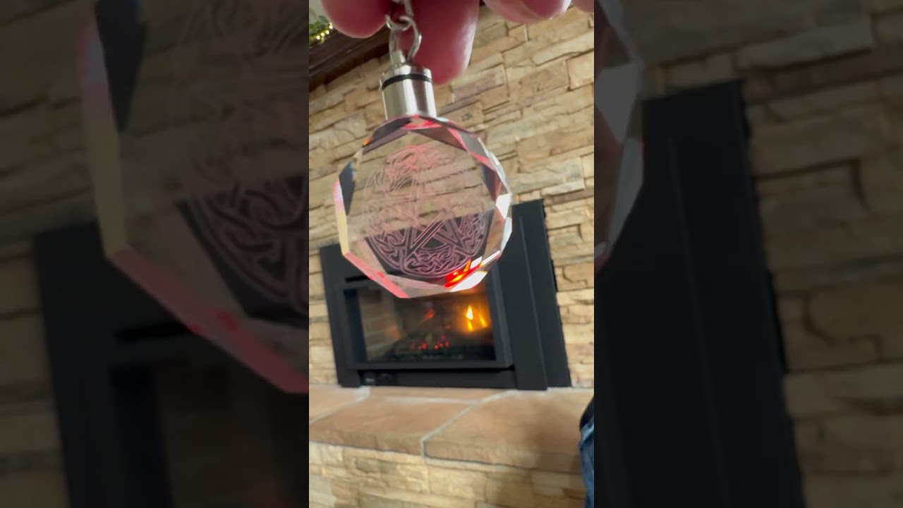

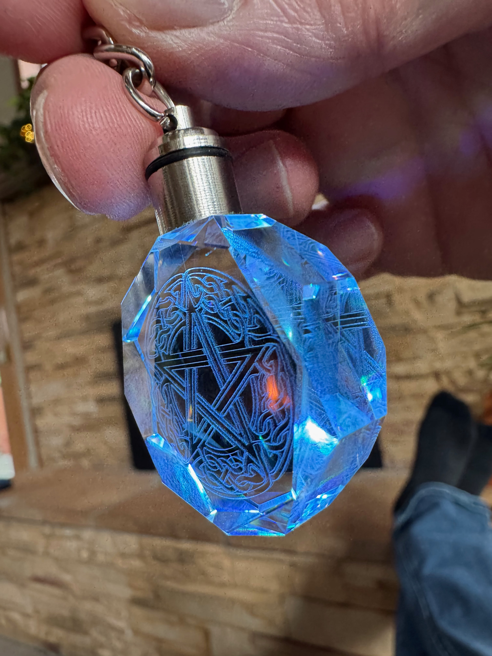

I have started working with a JPT 5W UV Laser, and got it running with LB, and I’ve come across a weird headscratcher while trying to do sub-surface engraving on glass/crystal:

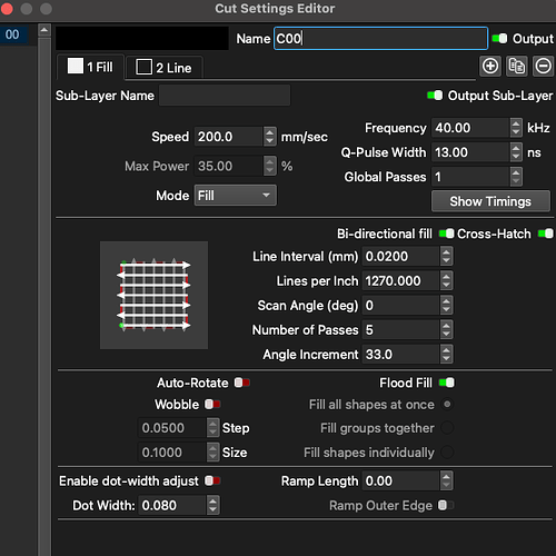

It seems that I can engrave under the surface properly with lines, but it will not fill. I had very similar settings in Fill and Line mode, and am perplexed as to why I only see the lines. Anyone here have any experience with this?
Note that filling works fine on the surface and on Stainless steel and wood and whatever else i’ve tried. In fact, when I did my test, I had an aluminum business card under it, and it engraved the fill on the card instead of inside the crystal.

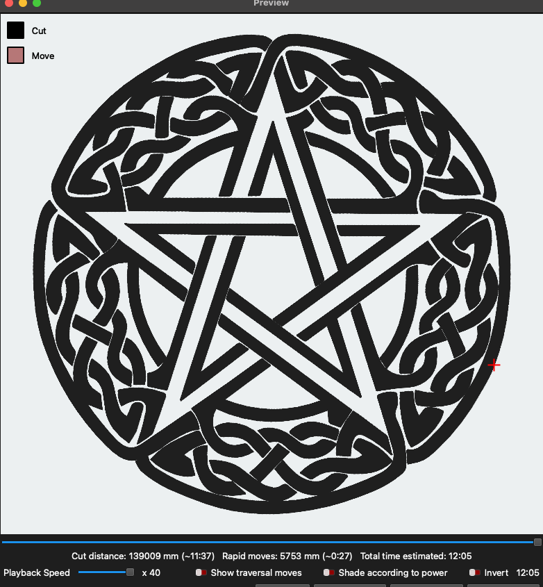

Show us your preview screenshot.
You might have a duplicate object that is preventing the fill.
Preview looks correct. I figure it’s probably drawing correctly since it works on other materials. I think it’s just somehow not getting the same energy density in fill mode as it does in line mode?

Here’s a video since it’s kinda hard to see in the pics:
-Thomas
Sorry, I am a diode guy. Maybe turn off the cross hatch and add another layer at 90 degrees instead?
And/or…turn off flood fill as a test?

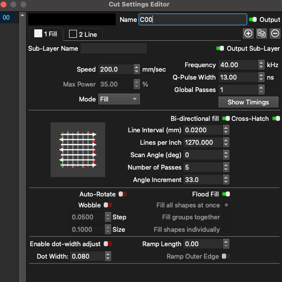

Both the Fill and Line Sub-Layers appear to use the same intensity settings.
Does it make a difference if you create a new separate Layer in fill mode?
