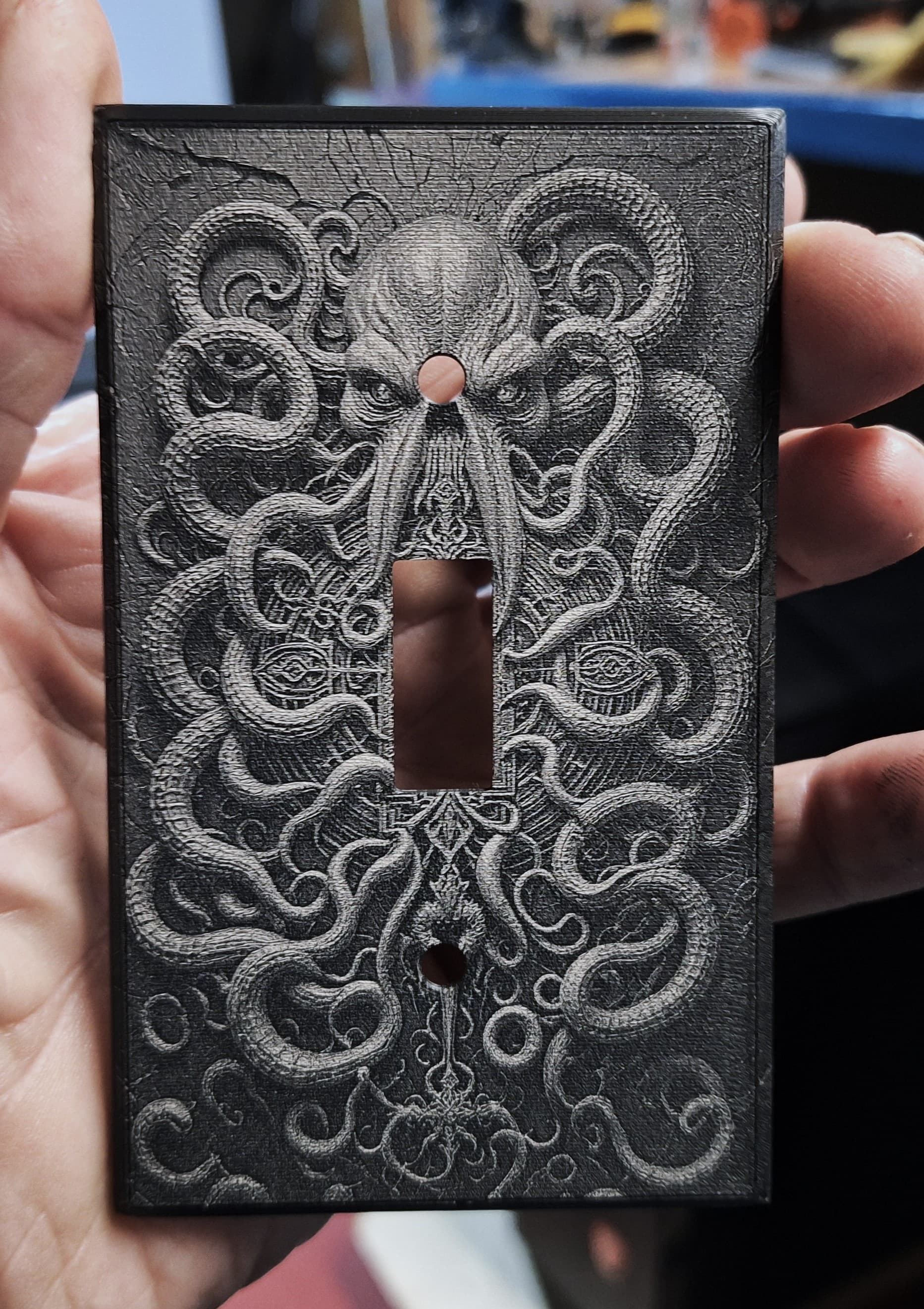

60 watt MOPA engraving 3D printed Black PLA

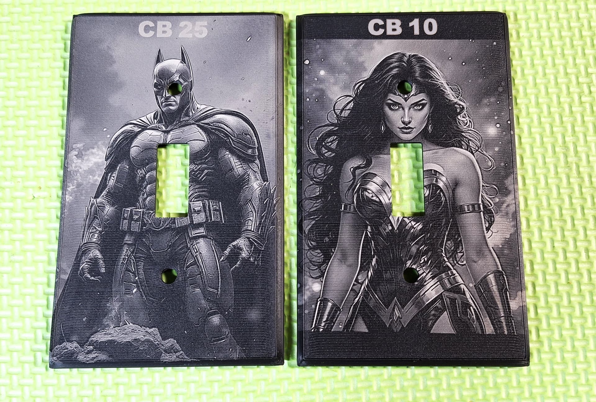

60 watt MOPA engraving 3D printed Black PLA Business Cards and Light Switch plates
1000/15%/120kHz/100 ns
LB Stucki 508 DPI

Impressive as always, but the stripes in some of the pictures don’t look like your work :wink:
@bernd.dk
Thanks
But The “stripes”
are from the 3D print
Near impossible to get a smooth surface using a 0.4 nozzle
Ok, that’s an explanation for what I couldn’t see. Your good reputation remains intact. :wink:
