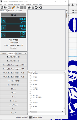

I am making progress [slowly] with my new toy- making 4x4 inch alum material tests with a lot of different perimeters and learning which affects what. I am also learning how the enclosure complicates operation of the laser. For instance- very hard to adjust [manually] the focus in flight. I started designing a power drive but now I am leaning toward a timing belt/pulley to move the ‘crank’ toward the front of the cabinet- if that doesn’t work I can add a DC motor pretty easily at that point. Any thoughts appreciated… Gene
I went through the options, settled on a stepper mounted on top, an Uno and Universal G-Code sender. UGS is great for storing/ running macros for the 3 lenses. Put two micrstep drivers in the project bx, run my X table if I like as well.

I did build up to it. Started with a DRO, added the stepper motor and the up/down switch. Then switched that to the CNC, leaving the DRO scale on it for double check.
The accuracy and speed of the CNC is nice, measure thickness, input and done. Want to add defocus, bang. Don’t have to watch, bump, check height, repeat. I have a DC motor up/down on my DRO bench mill, hate it. Need to hold the switch until position is arrived at, very loud and slow. No way to home. Be converting that to stepper / CNC/ USG one of these days.
Simple microstep driver Up/Down/Speed configuration
Single axis CNC controller I built for another project. Getting better at it.
