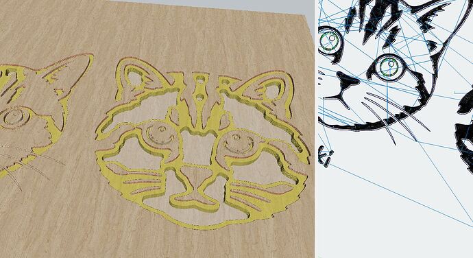

🐞9.0RC2 Rest Pocket breaks, when "Stock to Leave" is greater than tool diameter
i changed the rest tool to a 1.5mm and 2mm doc to preview it , its not doing a full pocket it is following the out line as expected
i think what it could be is something i encounted way back in early rcs , its a pocket in a pocket so for stock to leave you need to put a negative number , confusing at 1st yes, but makes sence after a while , there is a topic explaining it , because you have 3.2 stock to leave it is taking it to the edge and wont go past line so is ignoring stock to leave request
with a 0.5mm tool and -0.5mm stock to leave, it looks to be doing as i would suspect
have look at the below edited file
@Millmage can prob explain it clearer than me
